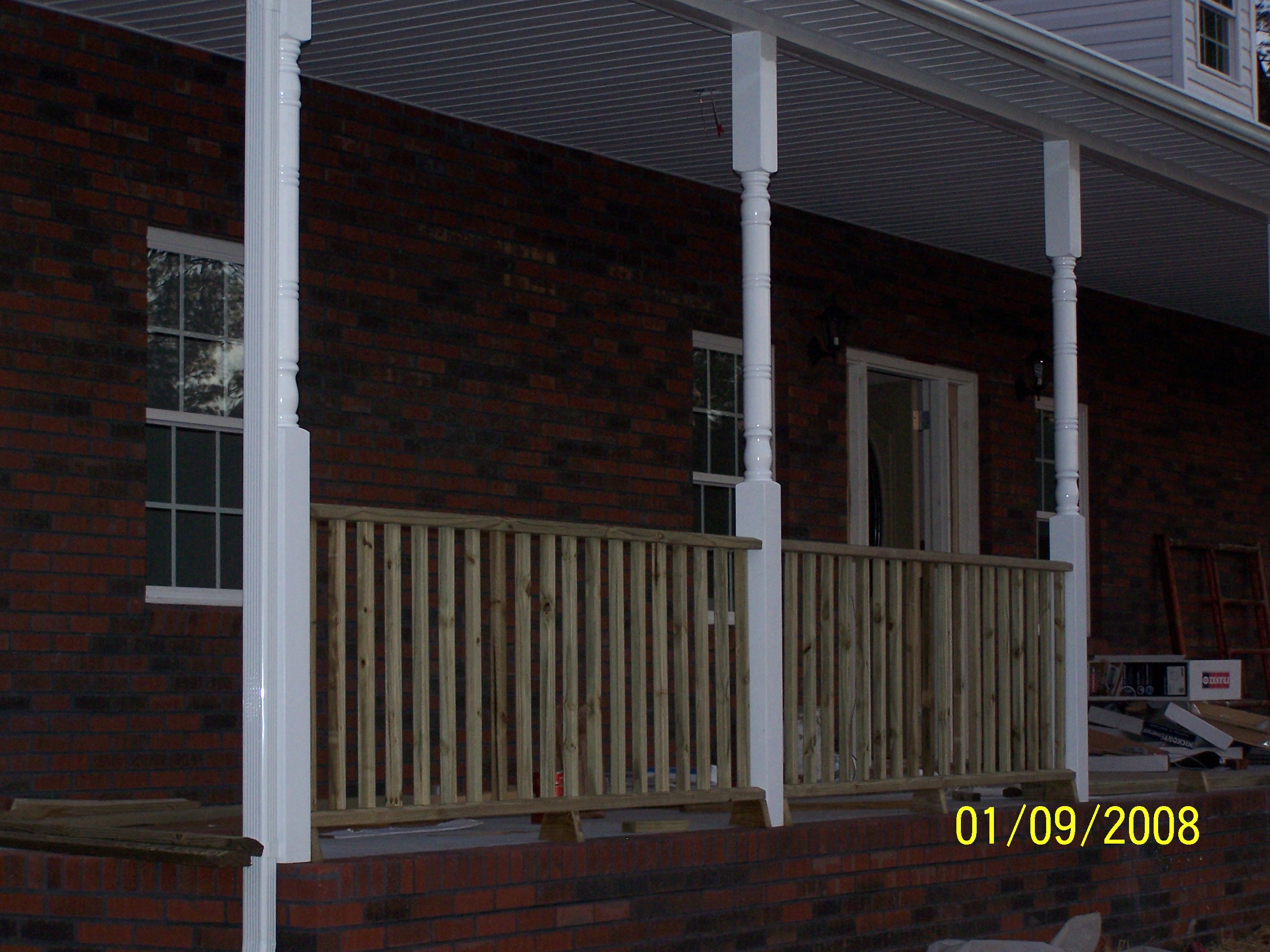

Starting to put the banister/railing around the front porch. this is one I really battled as I was not sure I wanted the railing. We went with treated wood and made our on rails out of 2x's. This was about 1/4 the cost of vinyl. I will have to let the rails dryfor a couple of months, most likely stain/paint this summer.
I know I should have went with vinyl but when you are not sure thats what you want better to go the chearper route and can always go to vinyl in a few years. But I had to put something up due to code.

Continues to impress, David!
Glad i'm not the only one struggling with the front porch railing. We want a darker brown. Darkest brown in vinyl we can find is khaki. Not dark enough. I have no interest in the composite stuff, heard too many horror stories. That leaves us with doing your way (treated/paint) OR going with ironwood and staining it. got a sample yesterday of the stained ironwood and it is perfect for what we want. BUT it cost more than composite.
Anywho - not trying to crash your thread, sorry! So what color will you stain the railing? Will you paint the columns to match the stain color or leave them white?

Michael, What are you talking about "crash my thread"...I was talking about killing cows in your thread!!:D :D
As far as the columns I am going to try a white stain. I have never used "white" stain, but have used several different colors of stain, mostly a dark color. So I will buy a small sample of the white and try it on a scrap piece of treated wood. The stain penetrates better so I hope it works. If not I'll us a white paint.

I like the fact your porch posts will be white too. I think that is the perfect color for your place.
It looks elegant and regal that way.
