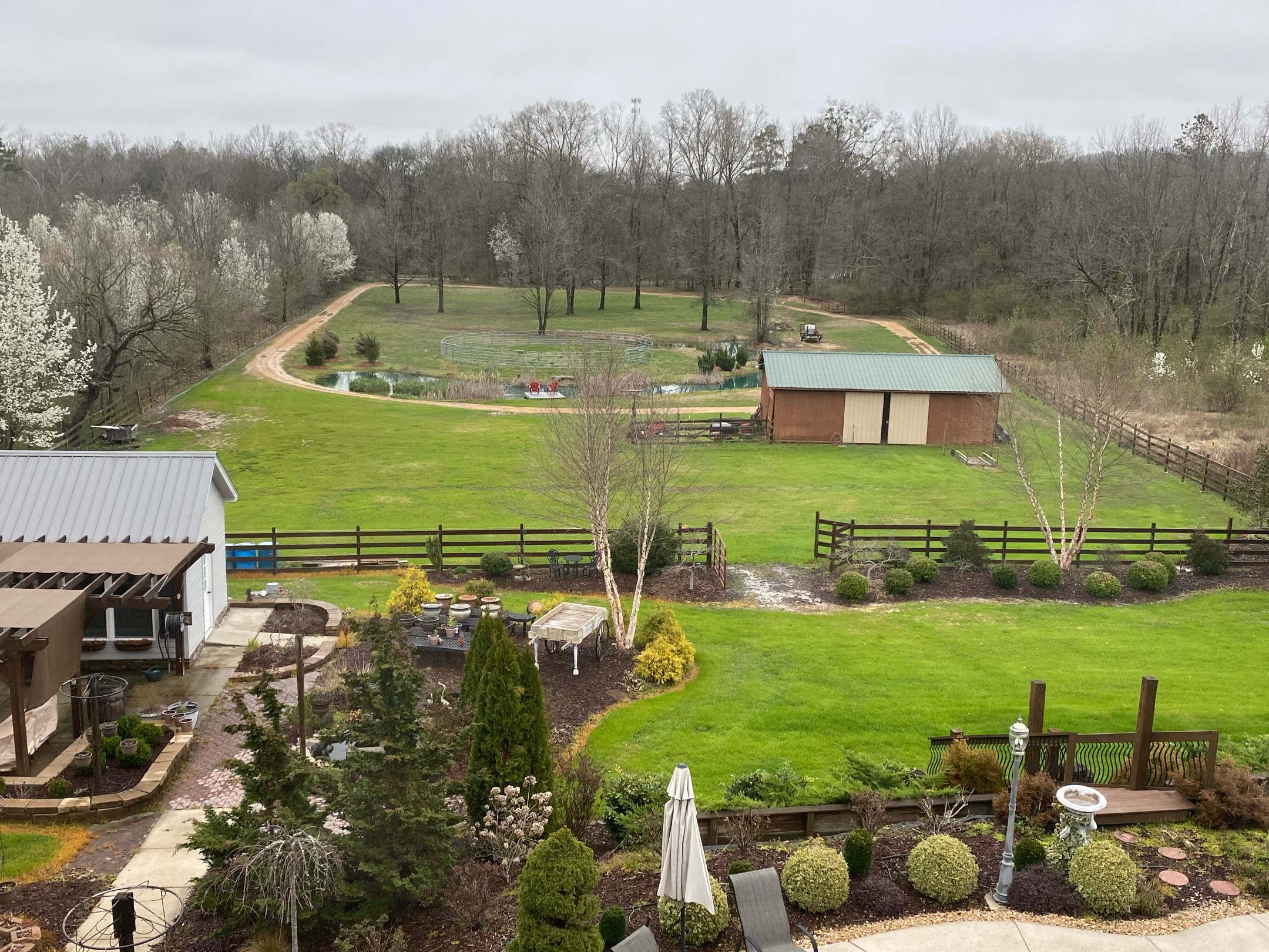

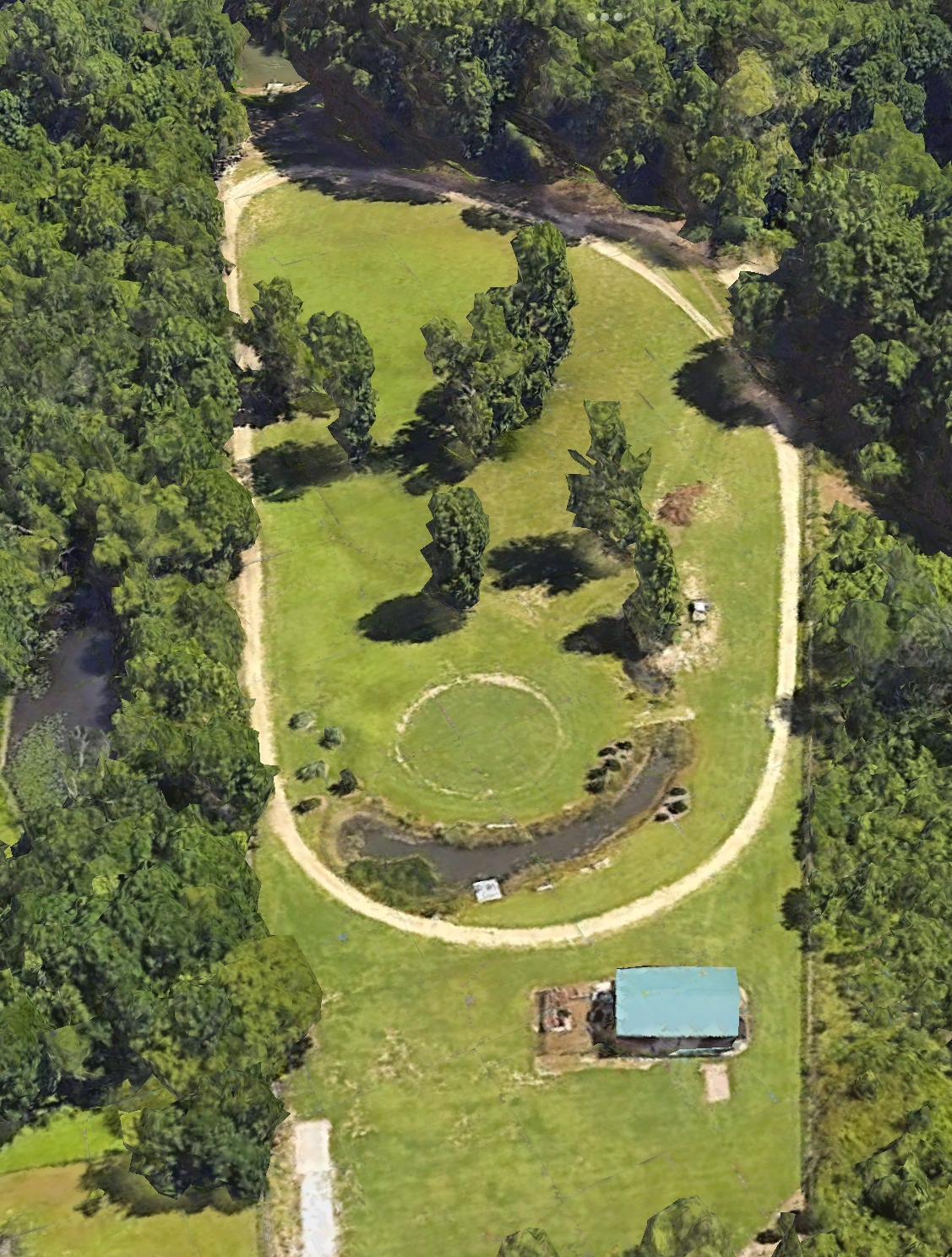

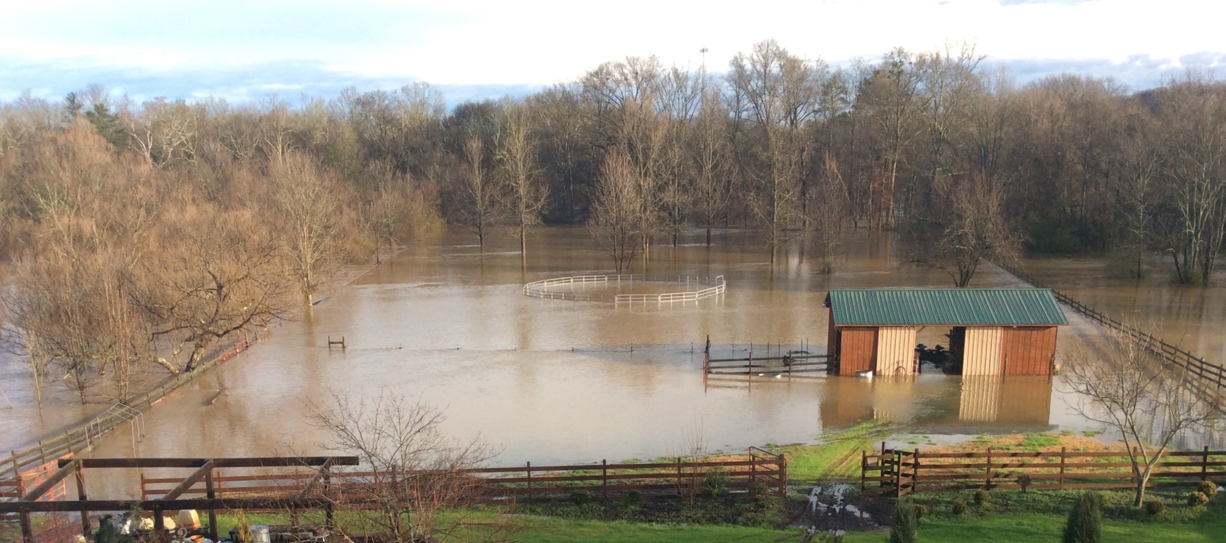

Kubota B7800 “land shaped” drainage features and created raised areas for a barn and round pen, and pond and track using FEL, and box scrape. Final smoothing with a 3pt. rake. Using a disc then the rake works wells also if dirt has become hard.
That's probably close in size to what I'm working on. What size is the area? Do you have any estimate on the amount of time spent shaping the land the way you wanted?
Excavated dirt from pond and rear slope drainage area provided ample dirt. Solved the fall to winter mushy front pasture that borders a creek flood zone (should have raised barn another foot, but no damage). Over 4 acre pasture. Estimate 250+ enjoyable hrs from tractor run meter over a year’s part time work, including discing/raking all. Tractor Supply Rake helped with grass seeding.
