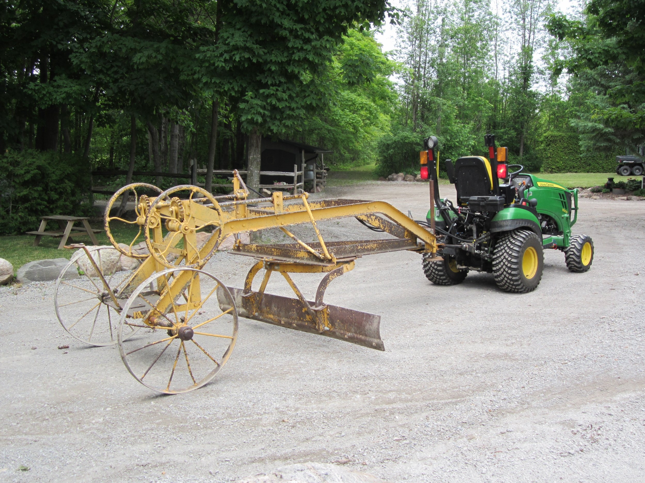

I was given the action end of a [previously] horse drawn 1920 Adam's grader. I modified the draw to have a three point bar, and put one hydraulic cylinder so I can lift or lower one side of the mold board while I'm grading. It works perfectly! It does snow well too, if I decide to swap out from my rear mount snowblower.
That is a sweet setup. I’d love to score something like that.

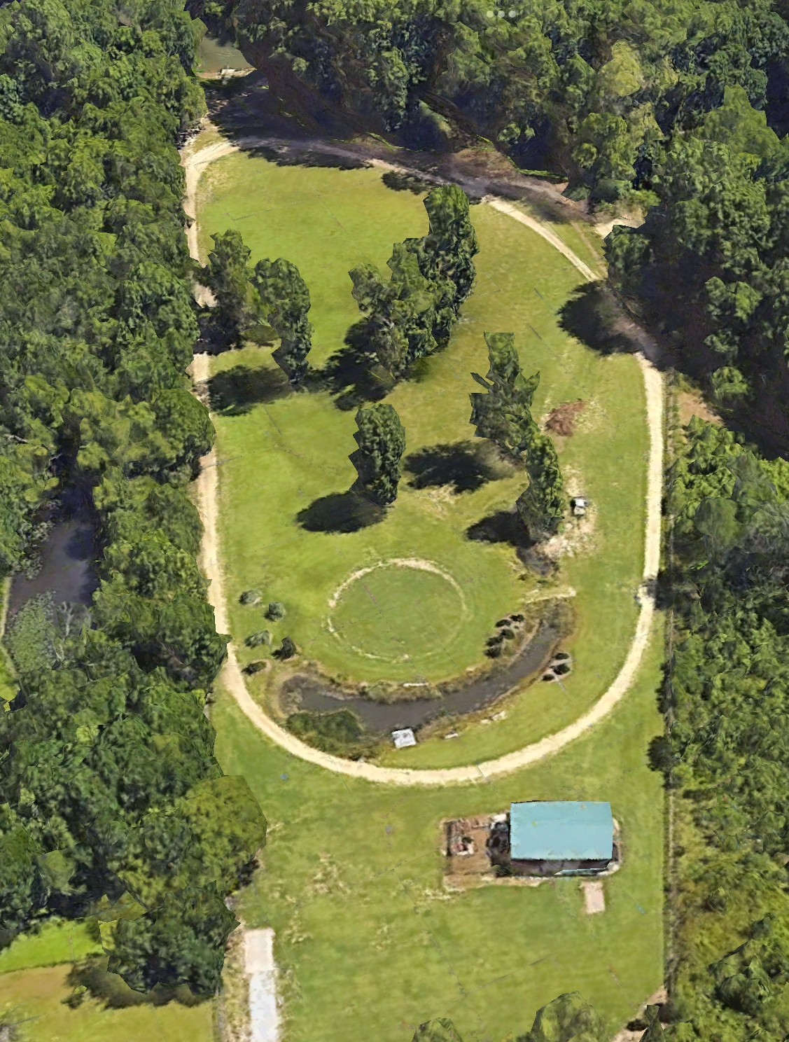

Kubota B7800 “land shaped” drainage features and created raised areas for a barn and round pen, and pond and track using FEL, and box scrape. Final smoothing with a 3pt. rake. Using a disc then the rake works well also if dirt has become hard.
