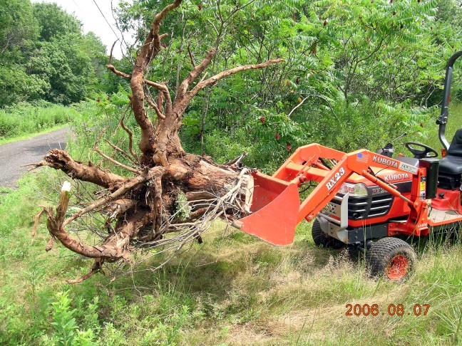

Taiser, The BX will do the job, but don't expect to get it done in a weekend. Th BX is a capable machine, and I agree that a larger machine would be better suited for some of the task you outlined, but if you don't mind sitting in the seat a little longer, and spending more time outdoors, the BX will do the job. Stumps are tough for pretty much any machine, but after you get the hang of it, you can get out some pretty good size stumps with the BX (See attached pic). If you get the BX there will probably be a few times that you wished you had gone bigger, but overall I think you'll be very happy with it.
Ken

I stand corrected! Looking at the trees in the picture behind the JD, it seemed that many of them must be 10" or so in diameter. With a closer view of the trees, they seem more than suitable for removal with the BX. Many could be taken out of the ground in one bite for sure. I've used mine for many trees that size!

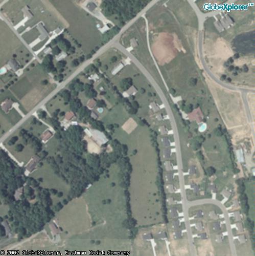

My property is similar to yours but it's only alittle over 4 acres and so far the BX23 has answered the bell on every task.
I've been steadily cleaning out the fence rows that encircle my property on 3 sides and I'm still on the 1st side but I'm in no hurry :D
I've added a thumb to the BH which is like adding another set of strong hands when it comes to cutting the trees and limbs up. It does OK on grubbing but since I've got so much more to go I'm thinking of adding a light weight grapple to the FEL. I'm researching useing an electric actuator to open/close it as opposed to using hydraulics to keep the cost & weight down.
The addition of a skidplate is also in the works too.
The good thing about the useing a BX22/BX23/BX24 is that after it's worked half the day as a grubber/stump digger/ground leveler, it can be very easily reconfigured into one of the best finish mowers without any using any tools!
I've always said that I'll rent a bigger machine when the need arrises and it just hasn't risen yet :D
My property is the dogleg shaped spread in the center of the pic.
