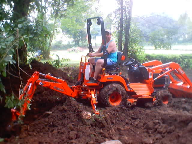

I finish mow 4 acres every week during the mowing season and have never bogged my little 22hp 60" SD MMM down. Last spring I let the back 2 acres grow to well over 4' then it started to fall over as the fellow what cut it for hay couldn't get to it. Well, I attacked it w/the little orange tractor that could and it only took two passes to get it down to 4". I now finish mow all 4 acres bog free....
I even read a few posts about owners digging a pond with thier bx.
You mean like this?
