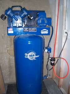

Q.) Is anyone familiar with Quincy Compressors? Local finish shop spent thousand$ upgrading their painting equipment 2-3 years ago just in time to have EPA and NYS come down hard on the chemicals and make the biz cost prohibitive (ouch!). This included a new, $1200+ 5hp 60gal Quincy stationary. All I have to go by is 18cfm@90psi, 21cfm@40psi, Max psi (?), model #151184-612 (?), but that # doesn't get a hit on the Quincy site or Goggle. The comments I found on Quincy compressors in general have been very, very good. Asking $500 w/ water separator (pic attached). Any thoughts?
A Quincy screw compressor is all you'll ever need. Done deal. Write the check....
To keep from jacking the man's thread, I'd hire out the sand blasting and call it a day, unless you just have to have a new compressor.

I don't think he was talking about a Quincy screw compressor, although he probably would love to have one. The text and picture refer to a V-twin piston pump. I have an Ingersol Rand that looks just like that. I had a Quincy head (no motor or tank) and I gave it to a good friend. He has yet to mount it but he will one day, when his old GM compressor off a bus gives up the ghost.
I would prefer a good used industrial compressor over the box store pieces of junk they import nowadays.
The size of the tank for sandblasting is really of no concern. The blaster uses so much air, that the compressor usually runs continously. If I were running a S/B'er, I would prefer to have the compressor run continously and just pump in an unloader or a pop-off valve to remove the excess when you stop for a few moments. Starting and stopping is too hard on a motor, especially when under a load of 80 to 125 psi air pressure.
