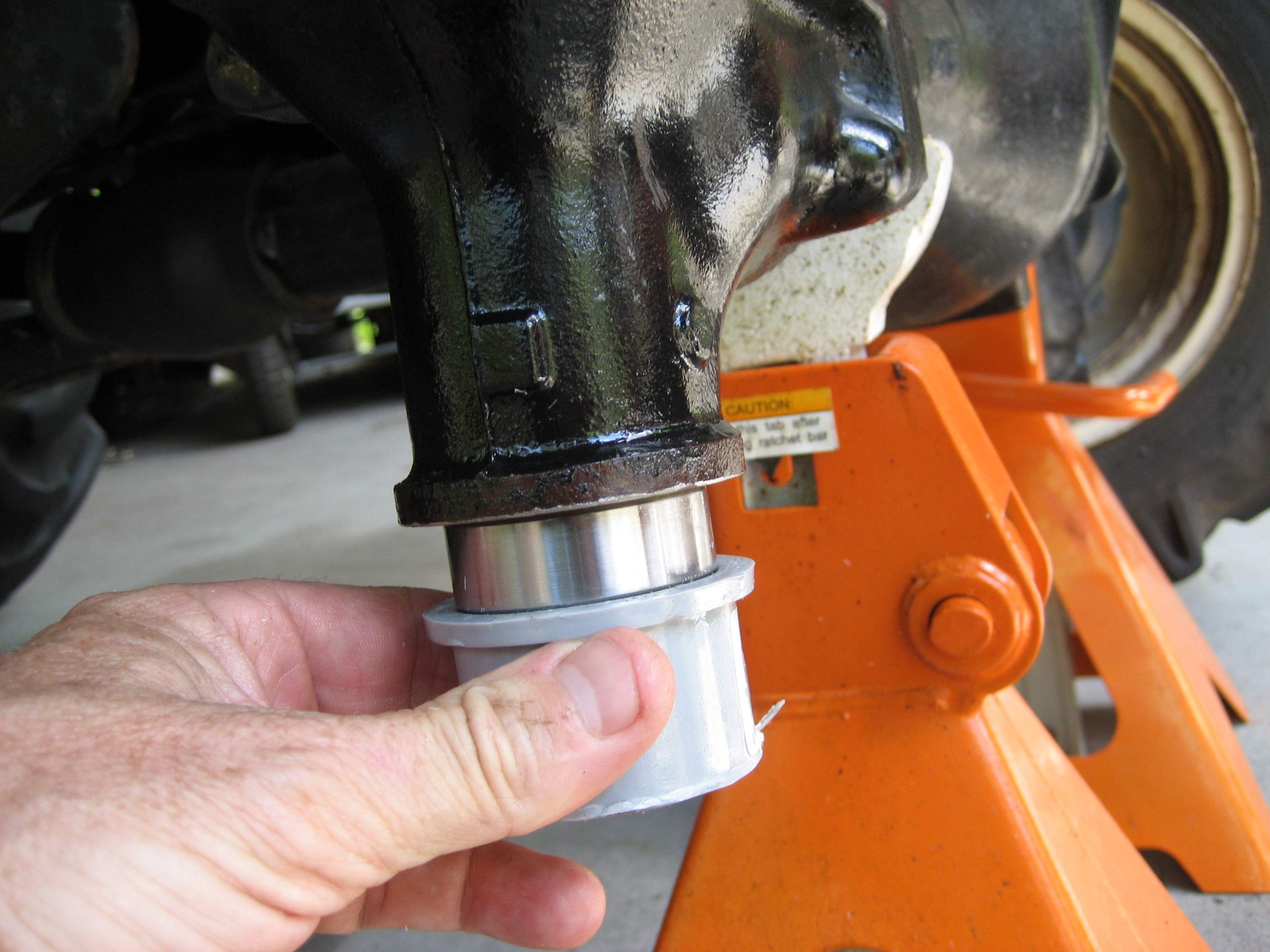

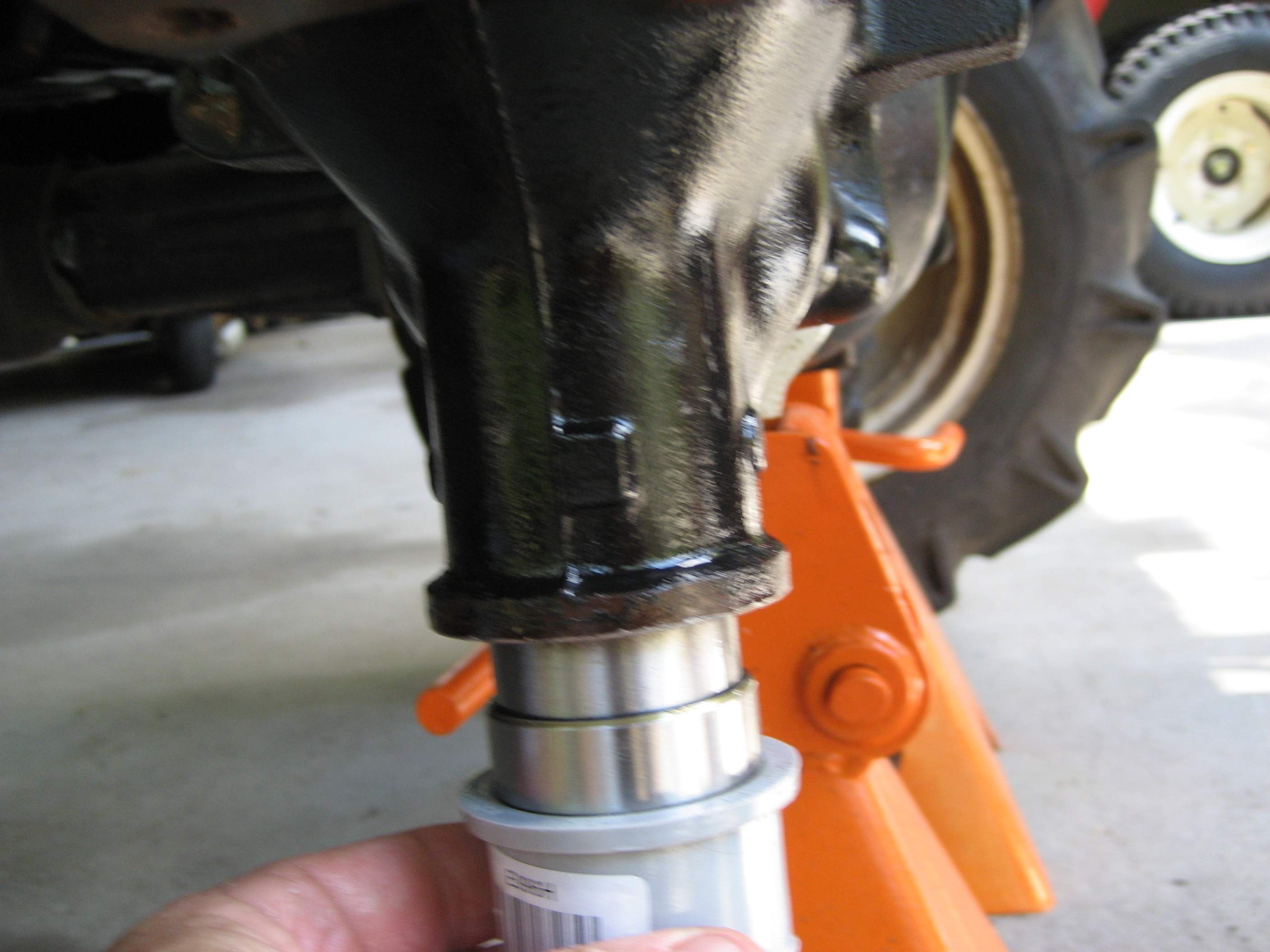

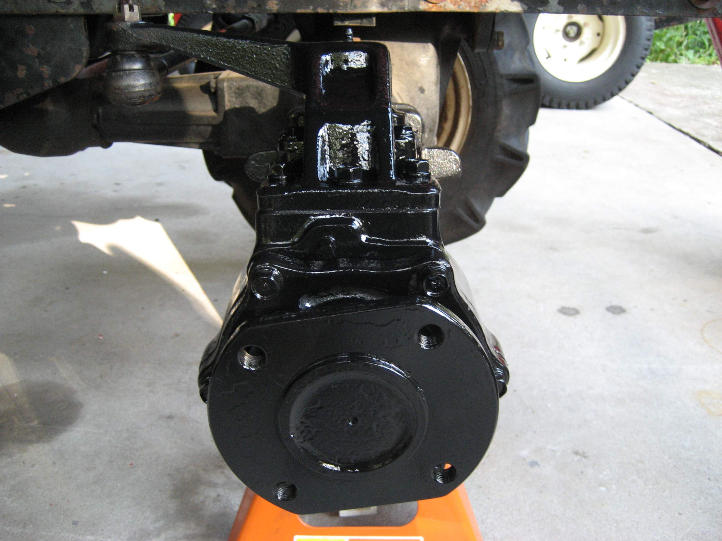

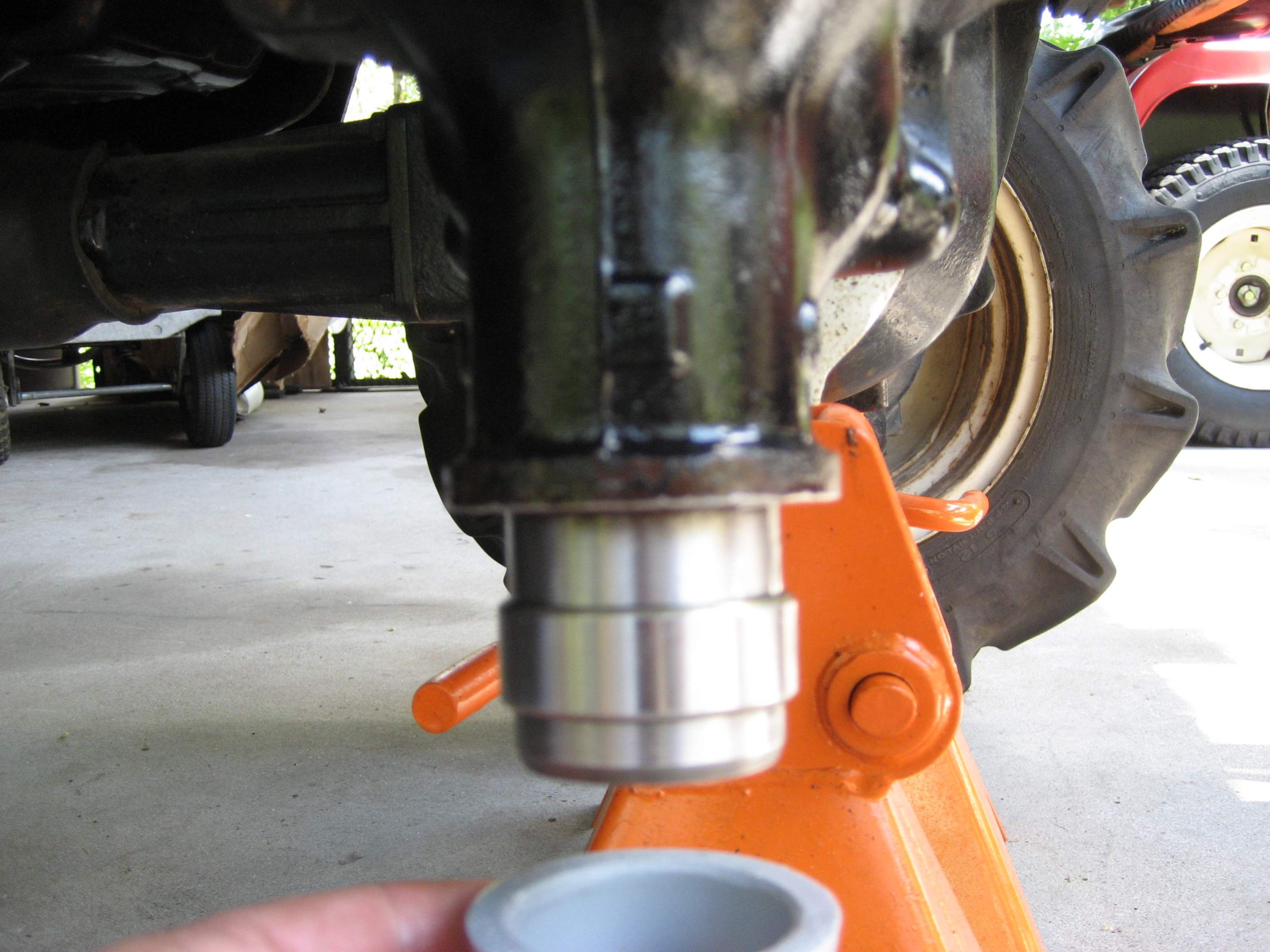

Finally got it back together. I picked up a 1 1/2" pvc piece to use to insulate the blow from the hammer. Once the collar was on the sleeve, I used the inside corner of the pvc piece to slowly knock it up. This took a while so go slowly and have patience. WD40 was my choice for lubing. No damage to the collar so it was ready to go once it was up.
Will finish filling up the axle housing tonight and see if I get any leaking overnight.
I decided to clean the outside up and paint while I was there.....my theory is paint to keep the rust from getting too bad.....my tractor has alot of rust spots so I will tackle this over the summer.
Thanks for all the good suggestions.
