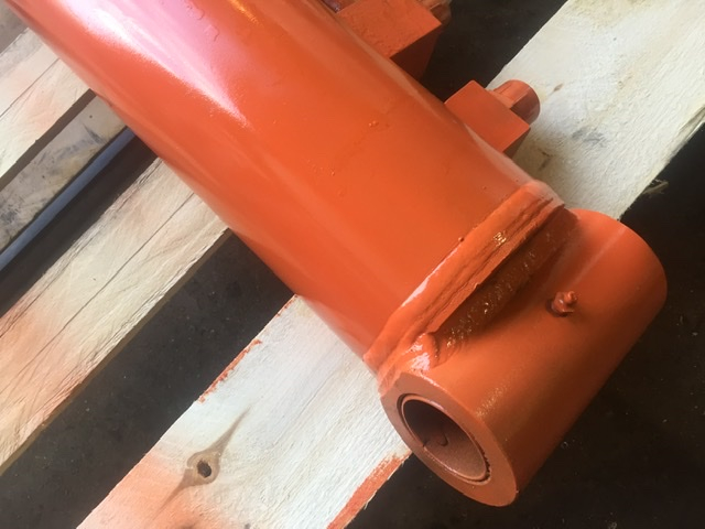

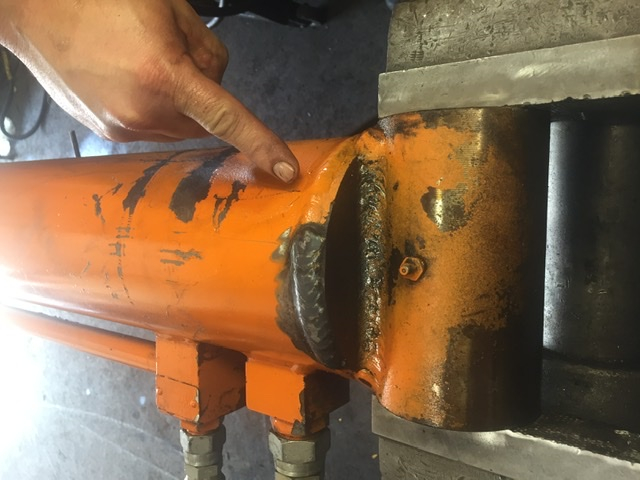

The right way to do it is pull the cyl apart, machine off the buttplate, tig weld the root and cap weld the outside.
If you weld it only on the outside only it will only be a temp repair cuz the crack will push its way out eventually.
/ Leaking Log Splitter Cylinder #7
Yes, but paying a shop to do that would exceed the cost of a replacement cylinder. Welding the outside will very likely last the life of the splitter.
/ Leaking Log Splitter Cylinder #8
No problem for the right repair shop if they are set up. This cyl was previously professionally welded and failed after a few months after the crack migrated.
Here’s the before, during and after of the right repair.
