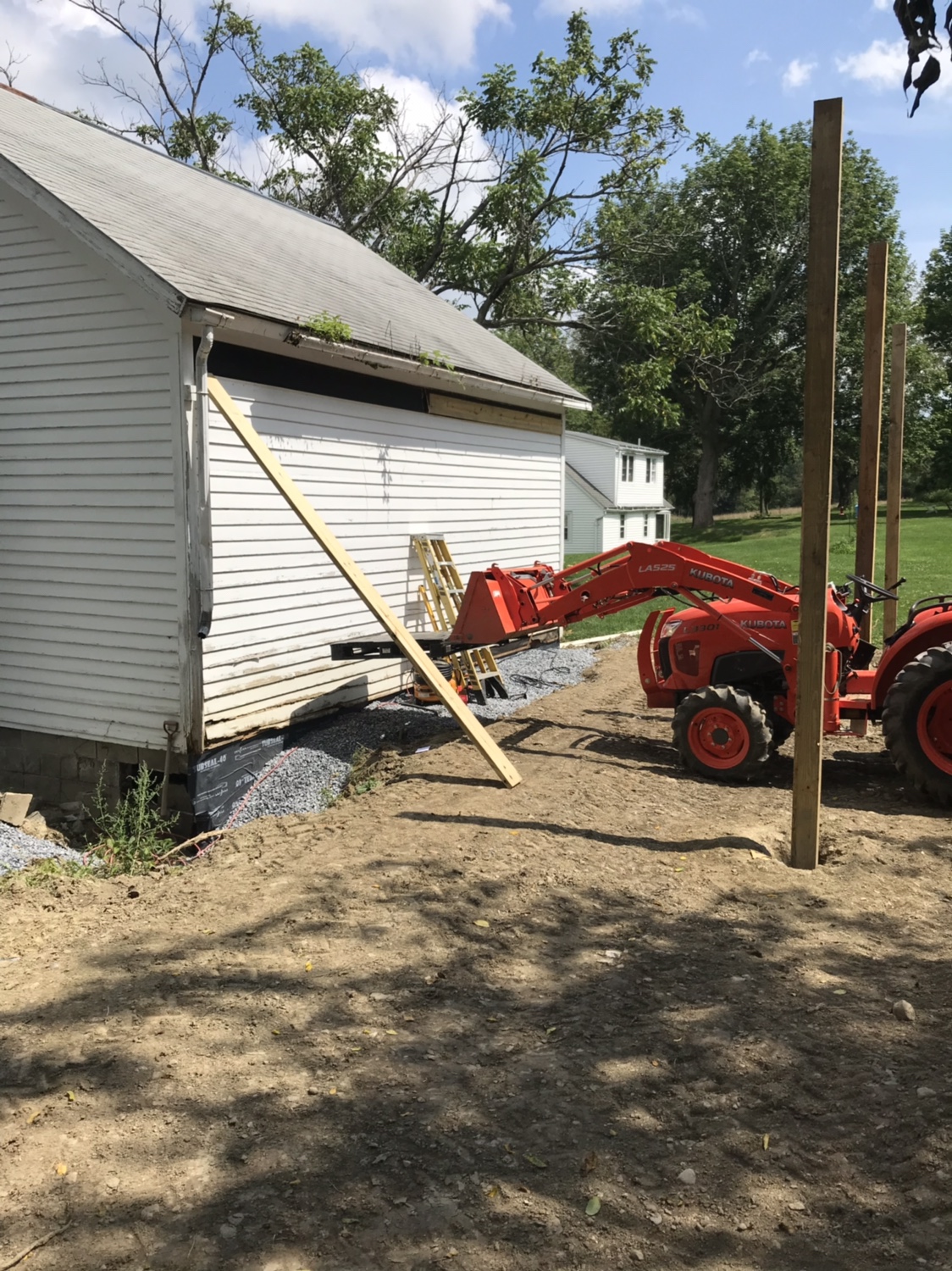

I feel like cutting into the house will be WAY more work. Also I'm looking forward to the lean to project. Just trying to wrap my head around everything. I over research everything prior to doing anything.
   / Lean to Shed #42
If the exterior walls and rafters are in good shape, I think I would cut the wall and floor out AND build the lean to.
   / Lean to Shed #43
Forget the house lean-to and matching up. All the house adds is one wall. Move back and start building to dimensions you like. Do more for you than another revision when the house is torn down.
   / Lean to Shed
#44
Daughter as she with cutting the wall is it has asbestos siding on it. Dont know if I want to deal with that right now.
   / Lean to Shed #45
Refining my thoughts and looking at your picture again, and seeing that you are not comfortable with modifying the existing house, I would suggest doing two openings where each window is. I'm guessing that there is a load bearing wall down the middle of the house with each window being a different room. Leave that wall between the rooms alone for now and just make the window openings bigger. Then you wont have to worry about any structural issues. I would still install a header over the openings, but that's super easy to do.
Remind me what you want to put in the lean to. If it's a tractor, how will you fit it under the lean to with such limited clearance? A lawn mower will fit under the lean to, and some other things, but with that roof being so low, you are very limited in what will fit under it. Figure the size of your lumber and measure down from the low side of what you want to go in there. If it's a tractor, measure down from the under side of the joists at least 6 feet away from the building, with 8 feet being more realistic so you can get around all four sides of the tractor.

I am far from an architect or engineer. One of my two designs allows for 11ft 4 in roofline at the house, minus the joist/rafter thickness of lets say 10 in for a 12 ft span would leave me a working clearance of 10ft 4in at the house. With a 2/12 pitch if i were to move out 12 ft i would then have a working clearance of 8ft 4in at the midway post. This is plenty of clearance for the tractor. the next "bay" further from the house would have a max working clearance of 8ft 4 in and minimum working clearance of 6ft 4in. This would cover my truck as well as mower, tiller, and ATV.
The idea of cutting into the house has me held up. This is my first large scale carpentry project and that idea is a bit intimidating.
   / Lean to Shed #47
Think through the potential of using the existing structure. Are the exterior walls OK? It appears the roof rafters should be only supported by the side walls. The interior walls should be non-loading bearing. The end wall only serves to keep the side walls from spreading. As long as you have rafter ties, you can cut any size hole in the end wall.
The asbestos siding is "non-friable". Don't cut or grind it, just pull it all off and send it to the landfill. Wear a mask if you want. Gut the building, put in a gravel floor, put on metal siding and it will look like a new building.
Don't be intimidated, this looks like a really good project.

Can you explain rafter ties to me.
   / Lean to Shed #49
Rafter ties are just horizontal boards fastened to rafters on both sides to keep the bottom edge of the rafters from spreading apart. They might look like ceiling joists. You may already have them in this building.
