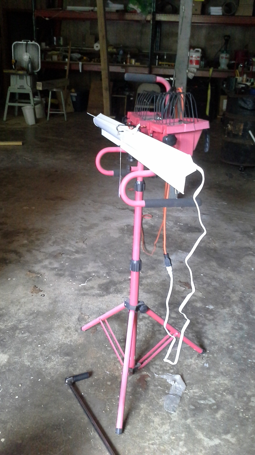

I had been wanting an LED dual headed work light. I've got an old HF halogen.
Voila
Main reason I did it was because it was so hot last summer using the halogens was cooking me.
