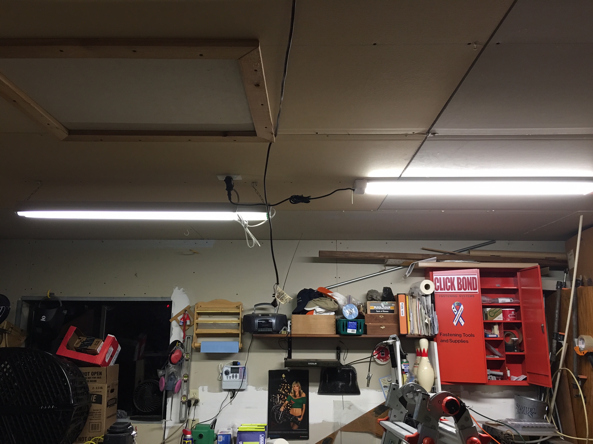

Just installed one Costco bought Feit 4ft LEDs. Advertised as 4000K, 3700lumen, 50,000hr. Flush mounted to ceiling next to hanging T-12s. Big difference! Besides being much brighter I like the flush mount giving me more room to wield around 8ft pieces of stuff. Going to swap out the others and flush mount them too. Someday I will mud and tape drywall ceiling and paint it white. Should really brighten things up! Oh and they don't give me any issue with RF inference with my old radio!
Look good:thumbsup:

Thanks James... I know, messy miscellaneous wall needs some attention. Now just waiting for my old kerosene heater to heat and dry up the shop a little before I install the rest. It's 28degF outside and dropping. My poor detached garage/shop and tools do not like this weather and dampness. I need to insulate my shop and figure a better heat source... oops... going off topic. I'll shut up now.

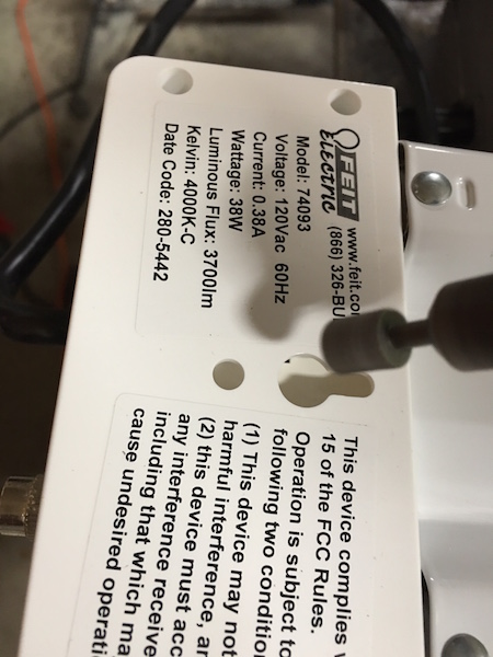

Okay this thread got me motivated so I will share some of my install details... bear with me, it's a slow night. The better half is down with a cold and I am trying to clean the garage/shop so she can park her car inside. It's been awhile. Feeling guilty. Especially since we are now in the high 20s at night. :cold:
First, here is the tape to remove on the bulbs.
I like using larger pan headed screws so it meant opening up the holes for flush mounting. Got out the dremel and an aggressive bit.
Also made a simple jig to locate the matched holes. Just score a line on either end and you have a consistent length mark to locate the two screws. If you are going to mount more than one fixture you will like this approach. Sink the screws leaving a little gap for the thickness of the fixture and you pop them in and slide using their keyhole slots.
Got four installed... love them... headed to Costco very soon to get a couple more at least to finish off the far end of the garage. Big improvement! Significantly brighter than the old T-12s. I'm sold.
