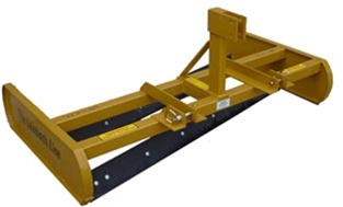

Hey List,
After reading about the land planes / levelers here I decided to pull the trigger on a 72" Leinbach land plane from everythingattachments.com. Since I'm out of the 1000 mile free shipping area I had to pay a bit more for residential delivery (total was $1354.50).
I just wanted to give everythingattachments.com an "attaboy" because I got email confirm of shipping THE day I ordered it .. I spoke with them on the phone and they know what they are doing over there.
I'll get some pic's up when it arrives .. hopefully I don't have to wait till spring to play ... uhhh I mean WORK with it!
