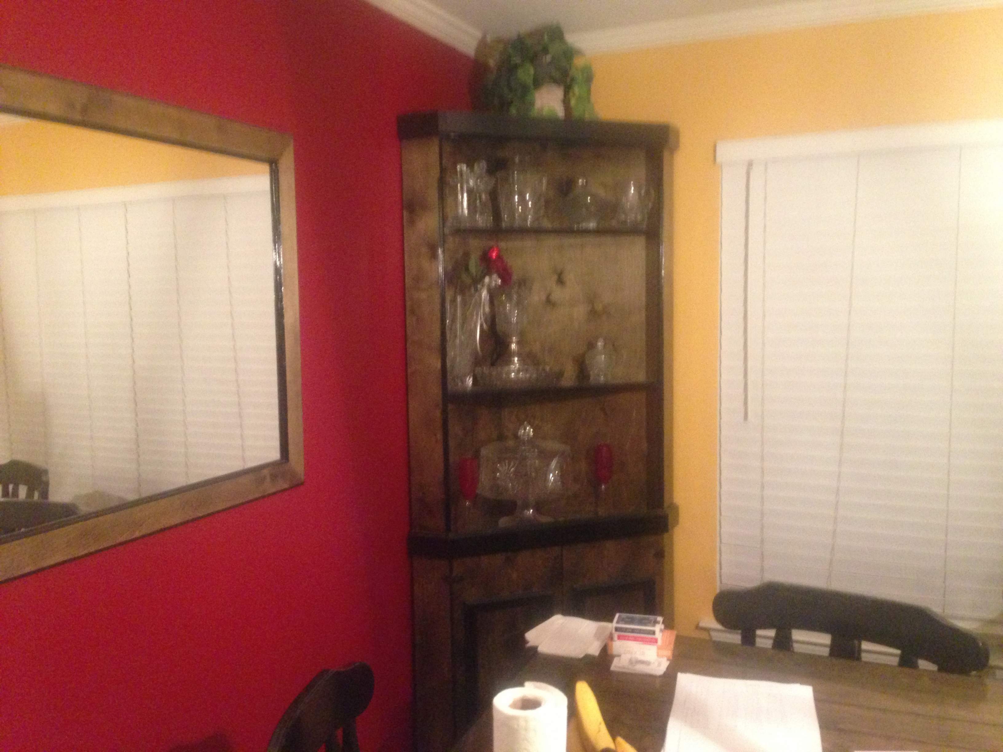

image.jpg This is a corner hutch I made for the wife back in '05. It's my favorite because its also my first and 100% by me

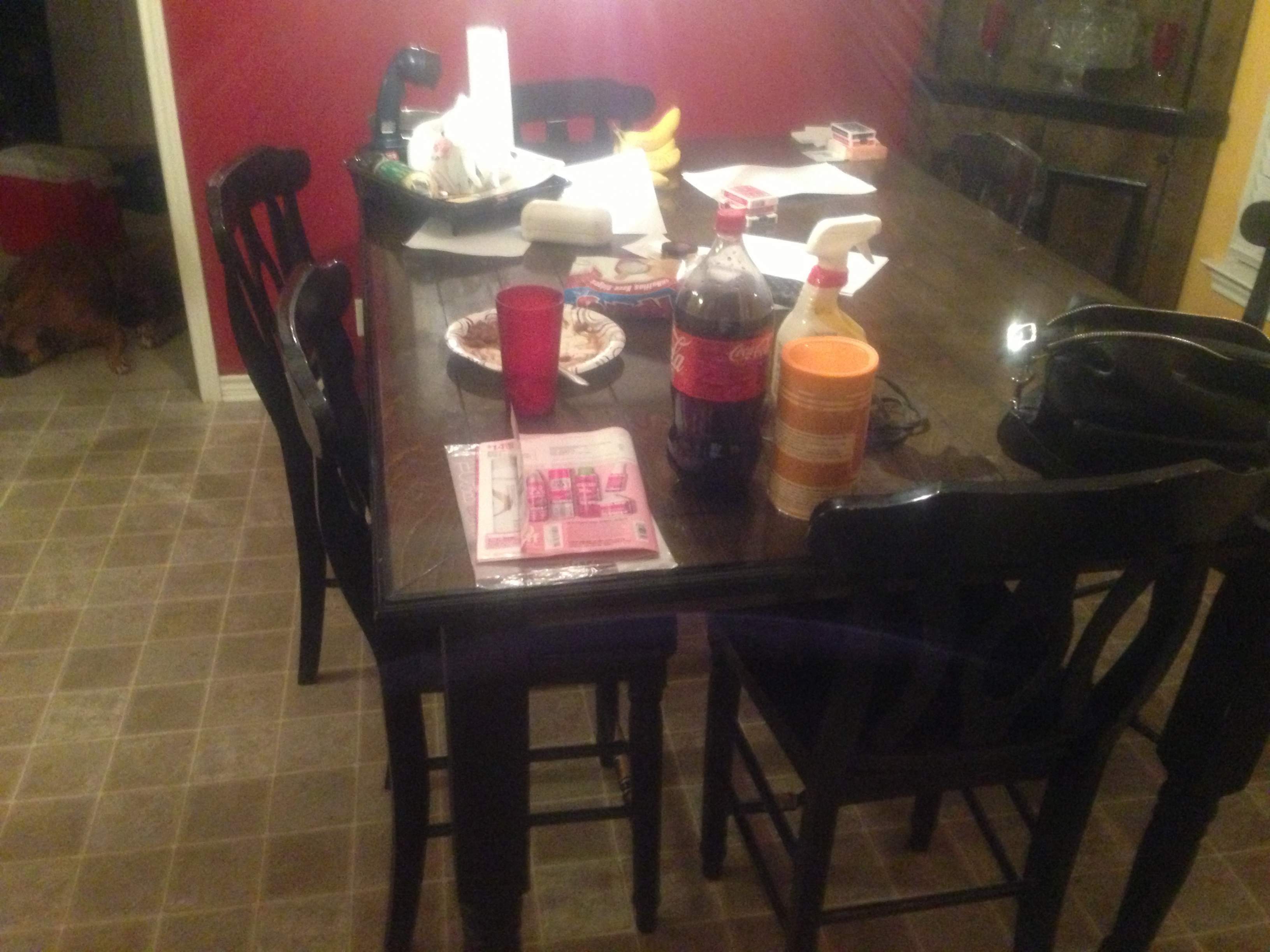

image.jpg this table was built shortly after (cant take credit, helped my cousin)
These don't hold a candle to you guys. These are stain grade birch. I mixed three parts thinner to one part gloss black enamel to make a stain. Then over the course of several days put three coats of polyurethane over it. The legs on the table are treated posts from Home Depot that we cut. FYI, chairs are from JC Penney:)

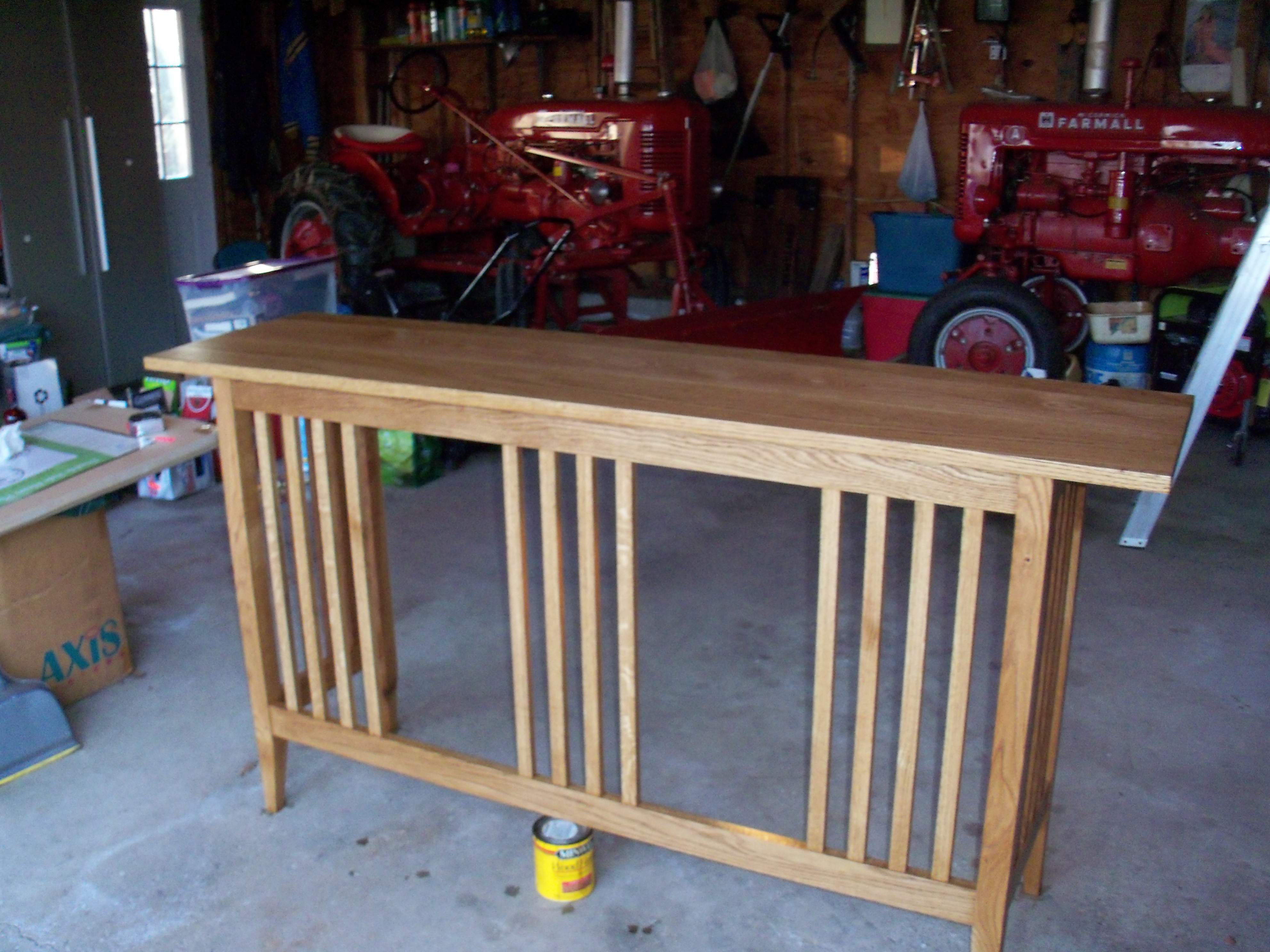

This is a sofa table I built for my son a couple years ago...

That is a nice table Scott.:thumbsup:
Your picture background is nice too! I can recall climbing around on them when new in the dealers lot!
