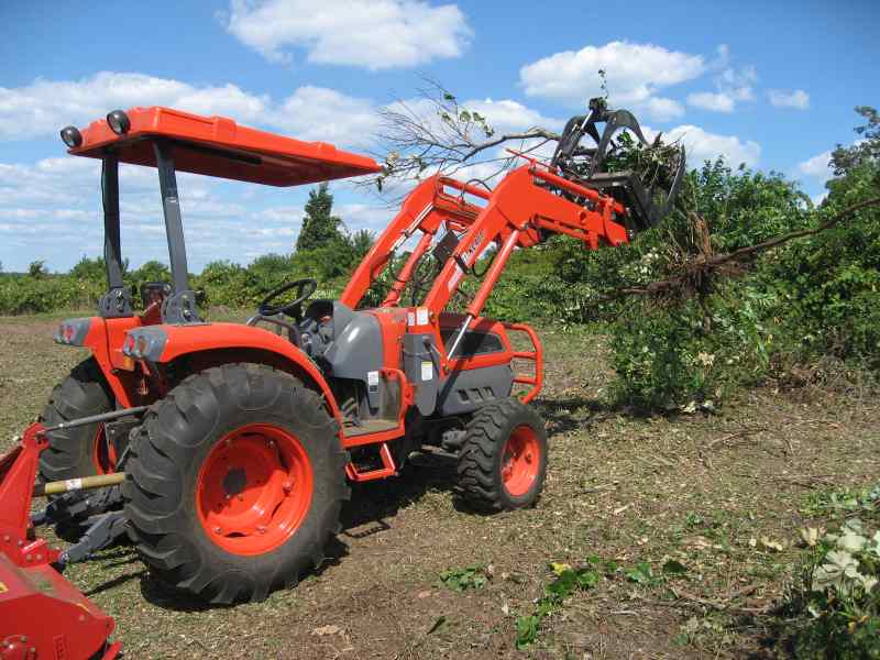

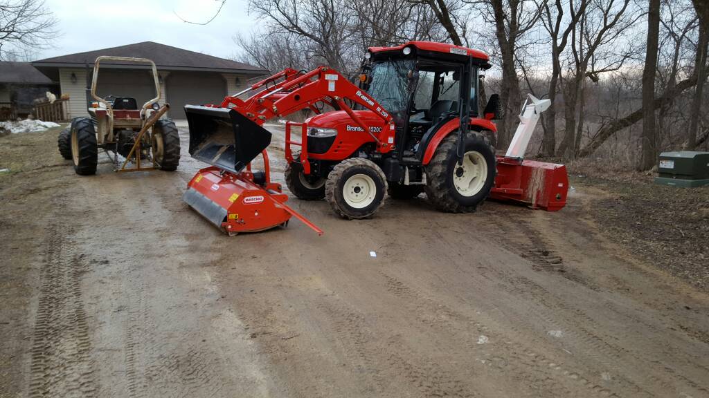

Looking at buying a 73" Caroni Flail mower. I would like to know if the mower can be offset mounted like when mowing close to fences or around trees? If yes, how much is the offset and how easy is it to reconfigure to be intrail with the tractor?
   / Let's talk flail mowers #2,724
Yes, it can be offset to the right. I don't have exact measurement but I'm guessing it is about 15 inches or so. I know that with the mower offset on my DK40se (the only way I use it now), there is about 15" extra mowing outside the right rear tire and that if I run the left tire just at the border of what was previously mowed (on the previously mowed part), that I get a full 75" of mowing width per pass. That doesn't work with to and fro mowing in straight lines but it does work when mowing in a spiral.
Also, Caroni makes a hydraulic offset kit that allows you to vary the offset from the tractor seat. To switch it mechanically takes about 15-20 minutes, maybe less with air tools.

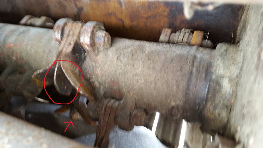

I've found what could be a good deal on a Maschio Brava 180. I was told this is similar to land pride flails. Does anybody know what kind of blades these are and how easy it would be to get replacement blades?

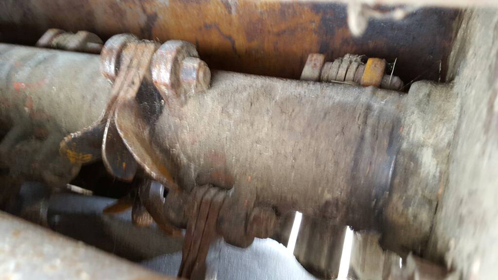

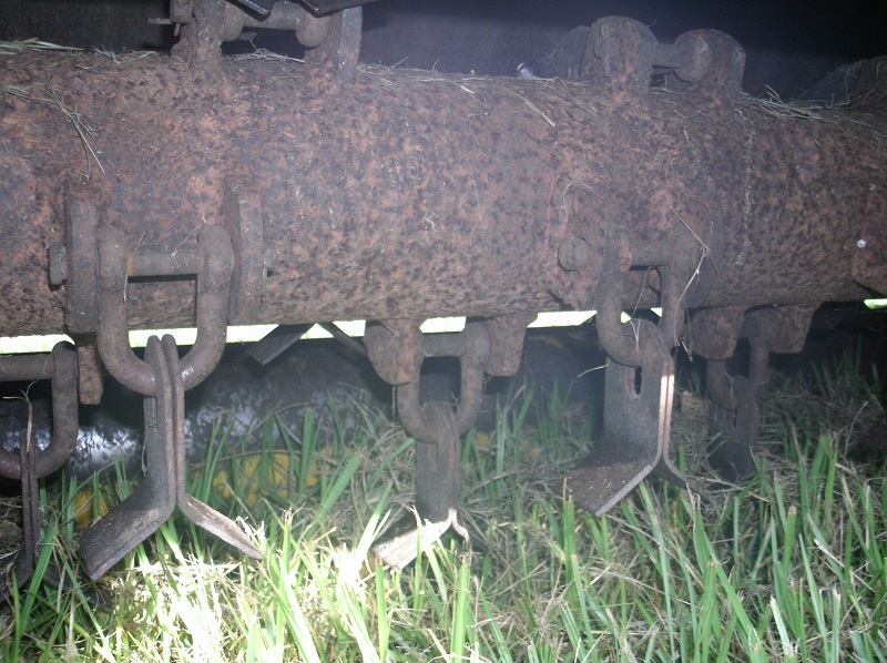

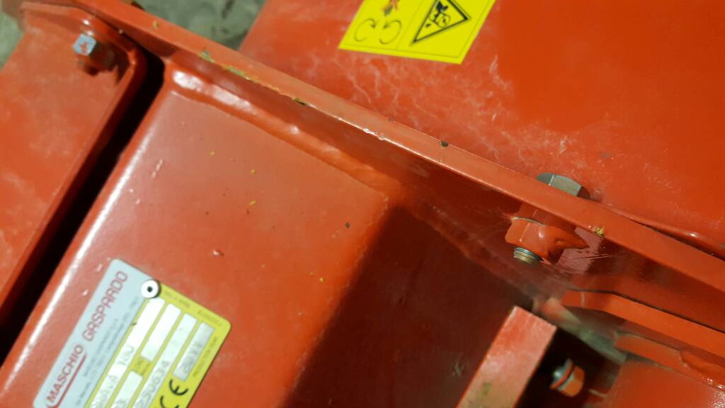

Oops here are the blades
AHHH!!!!!!
You have a Brava with side slicers and dethatching knives YAYYYYYYY!!!!!!!!!!!!!!!!!!!!!!!!!!!!!!!!!!!!!!!!!!!
Do not let it get away!!!!!!!!!!!!!!!!!!!!!!!!!!!!!!!!!!!!!!!!!!!!!!!!!!!!!!!!!!!!!!!!!!!!!!!!!!
Please notify us when you have it in your possesion so I can welcome you as the
newest resident citizen of the "Flail Mower Nations".
you will need to flip the dethatching blades to the unused edge when you bring it
home and when that is done you can mow and overseed with clover if desired as
the seeding slits will be deep enough to permit the seeds to germinate quickly.

So the middle finger, so to speak, is for de-thatching? In order for it to work, would you need to adjust the blades so they are just touching the ground?
The lowest setting for mowing is the height setting you want for dethatching.
The good sod will look lousy for a few days if you pick up the clippings
but you will have great grass sod if you have lawn to mow after a few weeks as the thatch will be gone
as long as you pick it up.
You can mow good sod and brush with the same flail mower so I would not let it get away!!!!!!!!!!!!!!

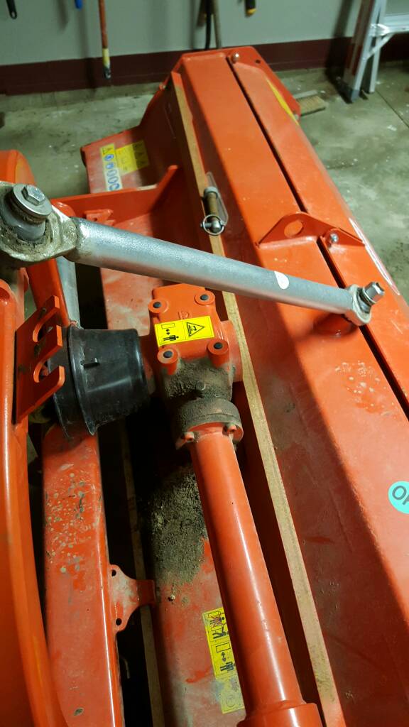

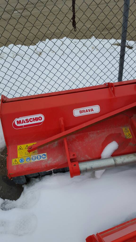

uploadfromtaptalk1457397138883.jpguploadfromtaptalk1457397160149.jpguploadfromtaptalk1457397167753.jpg
Well I bit the bullet and picked me up a Maschio Brava 180. Next thing I need is a set is pallet forks! The build quality seems good, nice looking welds. It looks like the Italian gearboxes like to spit up oil, "I no like-a your oil!"
Thanks all for the knowledge in this thread.
   / Let's talk flail mowers #2,740
View attachment 460070View attachment 460071View attachment 460072
There are a few places in this ultra long thread that discuss "fixes" or at least ways to mitigate the oil burping. Here is a post I made on the subject a few years ago: http://www.tractorbynet.com/forums/attachments/118882-lets-talk-flail-mowers-60.html#post1496273 Not sure if the measurements would be the same as I don't know if Caroni and Maschio use the identical gearbox. I believe both companies are pretty close to each other though.
