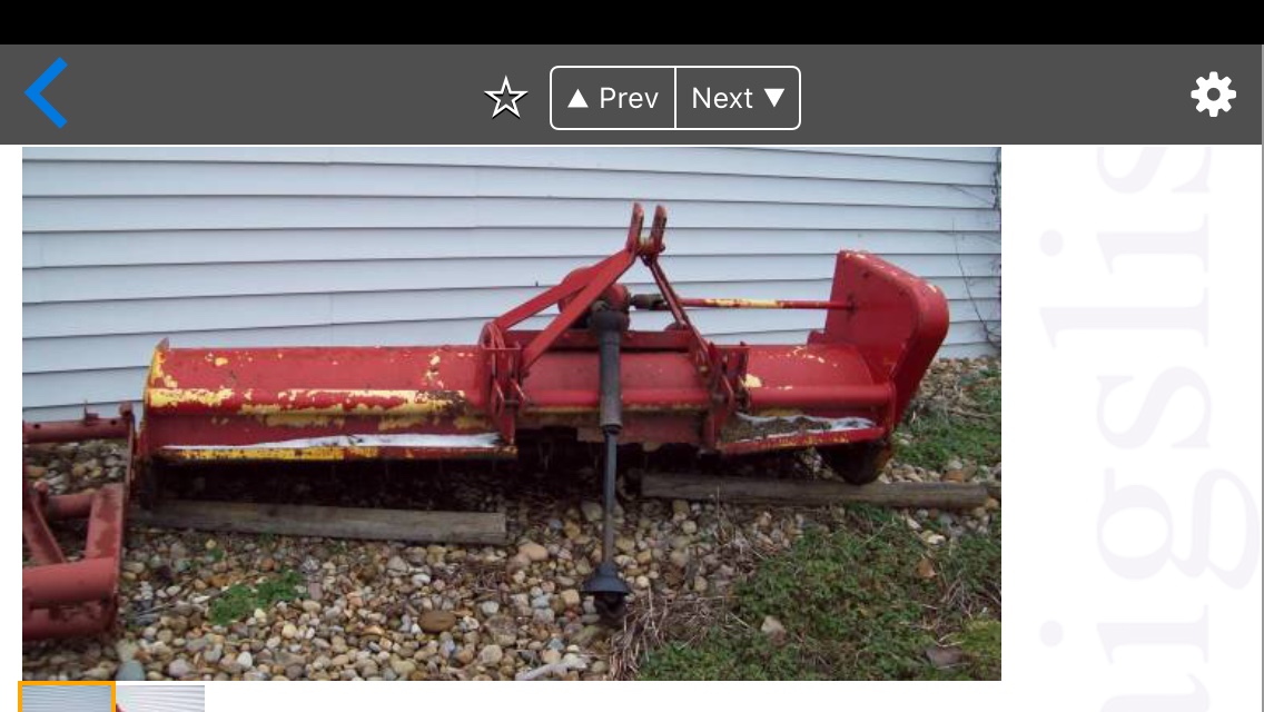

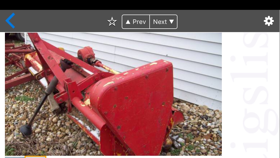

I haven't called on it yet, not knowing much about flail mowers, what should I pay attention to? He wants $550 for it.
I would have 6hp per foot so I'm good there. What does a wore out knife look like?
From the pictures it looks like right under the PTO shaft, looks like it has a good amount of rust on it. Rest of the body looks ok

NO, NO, NO, NO, NO, NO, NO!!!!!!!!!!!!!!!!!!!!!!!!!!!!!!!!!!!!!!!!!!!!!!!!!!!!!!!!!!!!!!!!!!!!!!!!!!!!!!!!!!!!!!!!!!!!!!!!!!!!!!!!!!!!!!!!!!!!!
The flail mower shroud weldment is a goner!!!!!!!!!!!!!!!!!!!!!!!!!!!!!!!!!!!!!!!!!!!!!!!!!!!!!!!!!!!!!!!!!!!!!!!!!!!!!!!!!!!!!!!!!!!!!!!!
When I see that it tells me it has had impact damage!!!!!!!!!!!!!!!!!!!!!!!!!!!!!!!!!!!!!!!!!!!!!!!!!!!!!!!!!!!!!!!!!!!!!!!!!!!!!!!!!!!!!
With that amount of steel gone the remaining weldments on the side weldments and the rear roller mount will have become weaker and suspect as the units entire strength of the full welds is gone.
Walk away please otherwise, if you buy it you will not be happy and blame flail mowers for bad mowing forever.
We want you to succeed not fail.

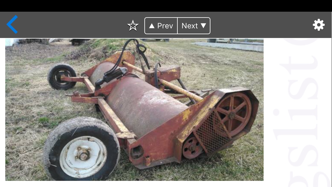

What about that big boy? 12 footer pull behind, $500 woods
Listing as follows: 12ft Woods Flail Chopper model FL144-2, hydraulic lift good condition
   / Let's talk flail mowers #4,134
If you can look at the red MATHEWS flail shredder behind it I would rather see you with that one.

Leonz is a bit more pessimistic on that one than I am, but that gap under the PTO shaft is worrisome. I went the other way. Got a crappy flail, fixed it up & got hooked on flails. Probably going to retire it to a backup & replace the 917 with a new flail within a couple years.
My shroud was bent in back & why some knives were missing. I torched out the dented part & patched it. One of the spars holding the hood is cracked & had a failed patch weld on it long before I got it. Have yet to bother patching it. I assume that is what is causing vibration noise but may or may not ever patch it.
If you are handy, can weld & don't mind a project it might be worth a hundred or 2. Make sure you have the skills, tools & motivation for a small project though & post better photos for better opinions.
