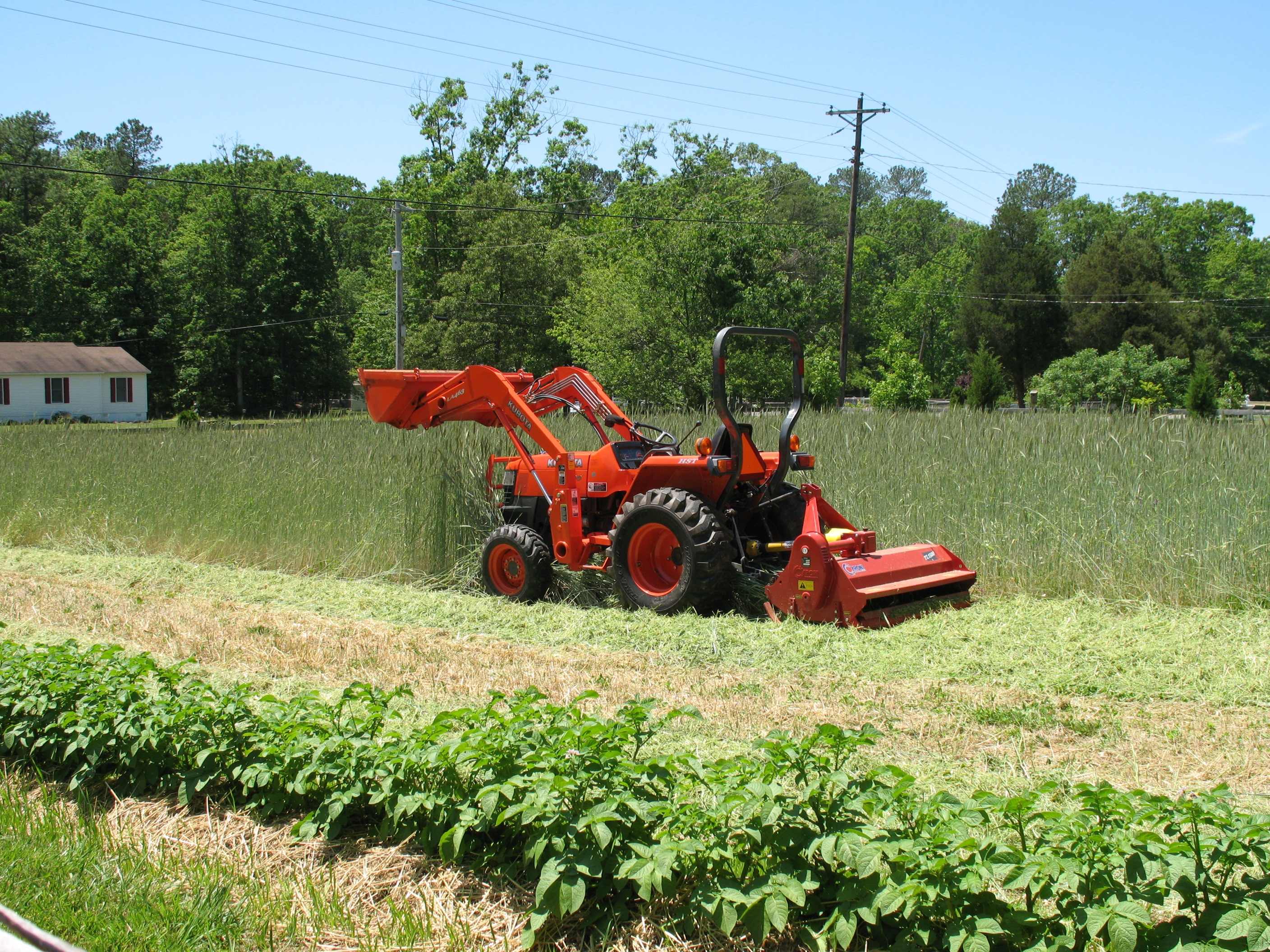

Another plug for Caroni. A TL1500 on my Kubota L2800. Does a very fine job cutting my cover crops (rye and vetch).
I'm looking at a L2800 right now and plan to put a flail mower on behind it. Wondering how fast you cut the cover crop there in the photo you posted? Also is your L2800 a geared or hst?
Thanks
Pax
Edit: I just looked at your profile and see that your L2800 is HST. Just what I am looking at.

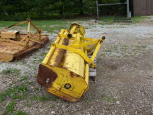

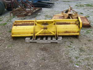

Wow John what did they mow with that thing--a gravel road? It does look like they hid several grenades under it. Maybe it was used to find land mines? But if it runs out nicely, so what, huh?
Mike
/ Let's talk flail mowers #430
I've got some that look as bad and one or two that look worse. The rocks punched their way through and started tearing the metal. Nothing a little welding didn't cure. The big deal, apart from looks, is what the rocks did to the ears on the cuttershaft underneath. Are the tops of the ears worn down to near the clevis holes? Are the holes ovalled? If they aren't bad then no big deal, especially if you won't be using it 50 hours a week.
