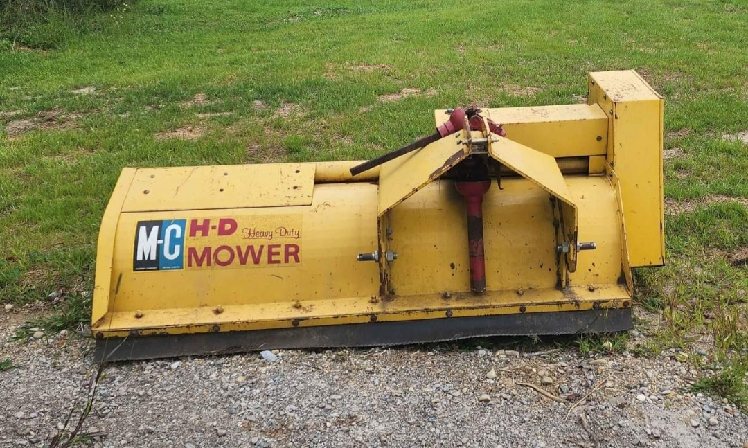

Can anyone (leonz?) tell me about this flail? I'm going to look at it and can't find much information on it. From what I can tell, its a Mathews Company Model 7 HDO. From prior posts it seems blades may still be available through a Mathews dealer. I'm look to run this on 50 pto hp for field and brush mowing...maybe some near-finish mowing by the road.
   / Let's talk flail mowers #7,716
That flail crop shredder is a Mathews Company cup knife flail mower.
It is a heavy-duty crop shredder mower.
The cup knives do not get changed unless they are cracked or broken or become really dull.
You can purchase an economical wet well grinder from the folks at www.micromark.com to
cool grind the knives to prevent them from losing the temper and becoming brittle.
