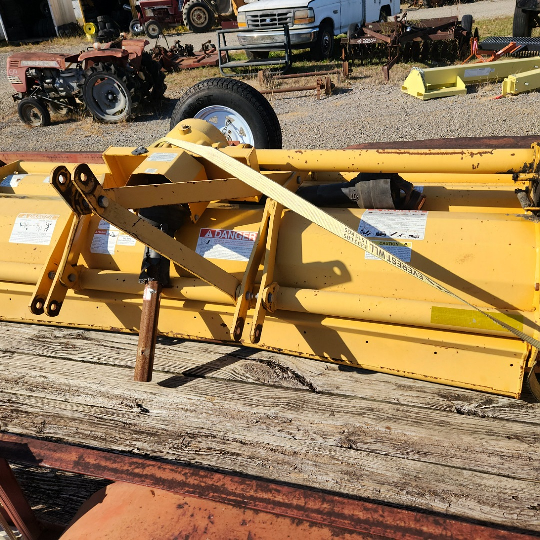

Found a prize today. Sold a box blade and the buyer suggested I try this farm equipment place a bit down the highway. Pull in there sits three Alamo SH88 flails right up front. Two marked $1595 and one a little rougher marked $1295. Blades on the one I bought look brand new, still sharpView attachment 767298View attachment 767299
This is awesome! Flailmaster will have any and all parts you'd need for this unit. I also have a SHD88, and it's an absolute tank. Just keep an extra belt on hand. The belt will break if you wedge something in it, like firewood (ask me how I know...). The belt size is C54, and I just get whatever brand is available. They usually last me about a year, depending on how careless I get. Whenever I break one, I put the spare on and order another spare. I use it to mow 3ft tall grass as well as my lawn. Mine is on my tractor 90% of summer. It also works great as a counterweight for lifting heavy stuff.
