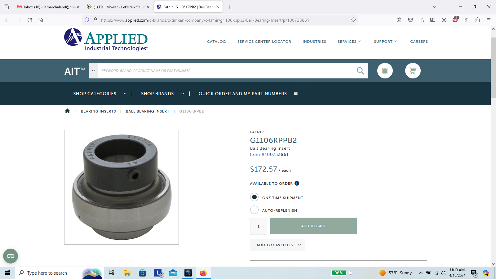

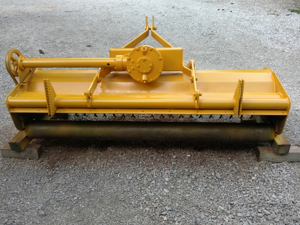

I got my Mott 72" fine cut out to use and found one of the bearings in the roller had gone south. It is an older style with the bearings inside the roller that unfortunately Flail Masters is not carrying anymore. So now the search begins to find replacements, FAFNIR 1106KPPB Z. Yeah I will replace both sides to be safe. BUT the problem is the only ones I have been able to locate so far are priced at nearly $500 for two bearings that should be, IMHO, around $100 each and the spacer for the side with the bad bearing is $125 which is nothing but an extra thick washer.
At these prices I will have more in a hand full of parts than I paid for the whole thing. I may decide just to scrap it, if I cannot find better prices, since I have NEVER been happy with the cut. Here is a pic (before I put the belt shield back on) of it after I replaced the seals in the gear box, replaced the knives and painted it a while back.
and here is $55

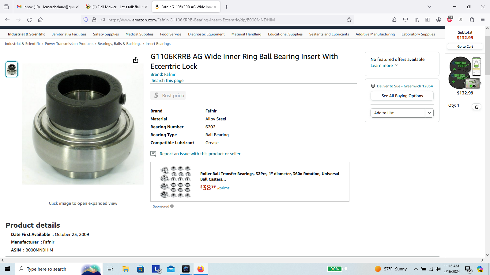

Thanks for the info. Google found the $174 bearing this afternoon when I had time to search, I like the price of the KRRB bearing much better. The dimensions appear to be identical but I have not been able to determine if it is lubed though the inner race same as the KPPB. Still researching...
Well after several hours I finally figured out the KRRB lubes though the outer race so while it will fit there will be no way to lubricate it. Makes no sense to me there is that much difference between the pricing simply because one lubes though the outer race and the other though the inner race.
