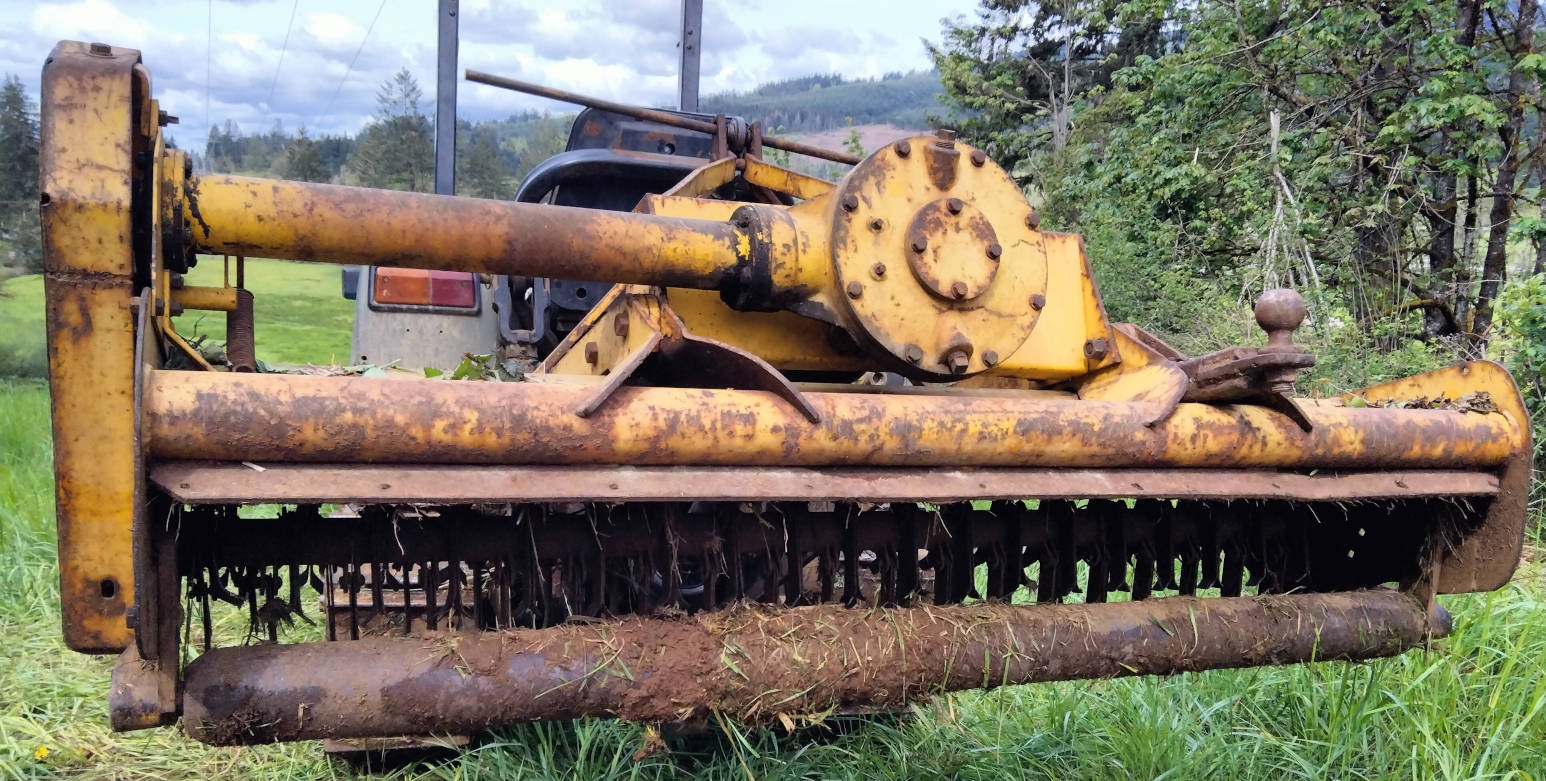

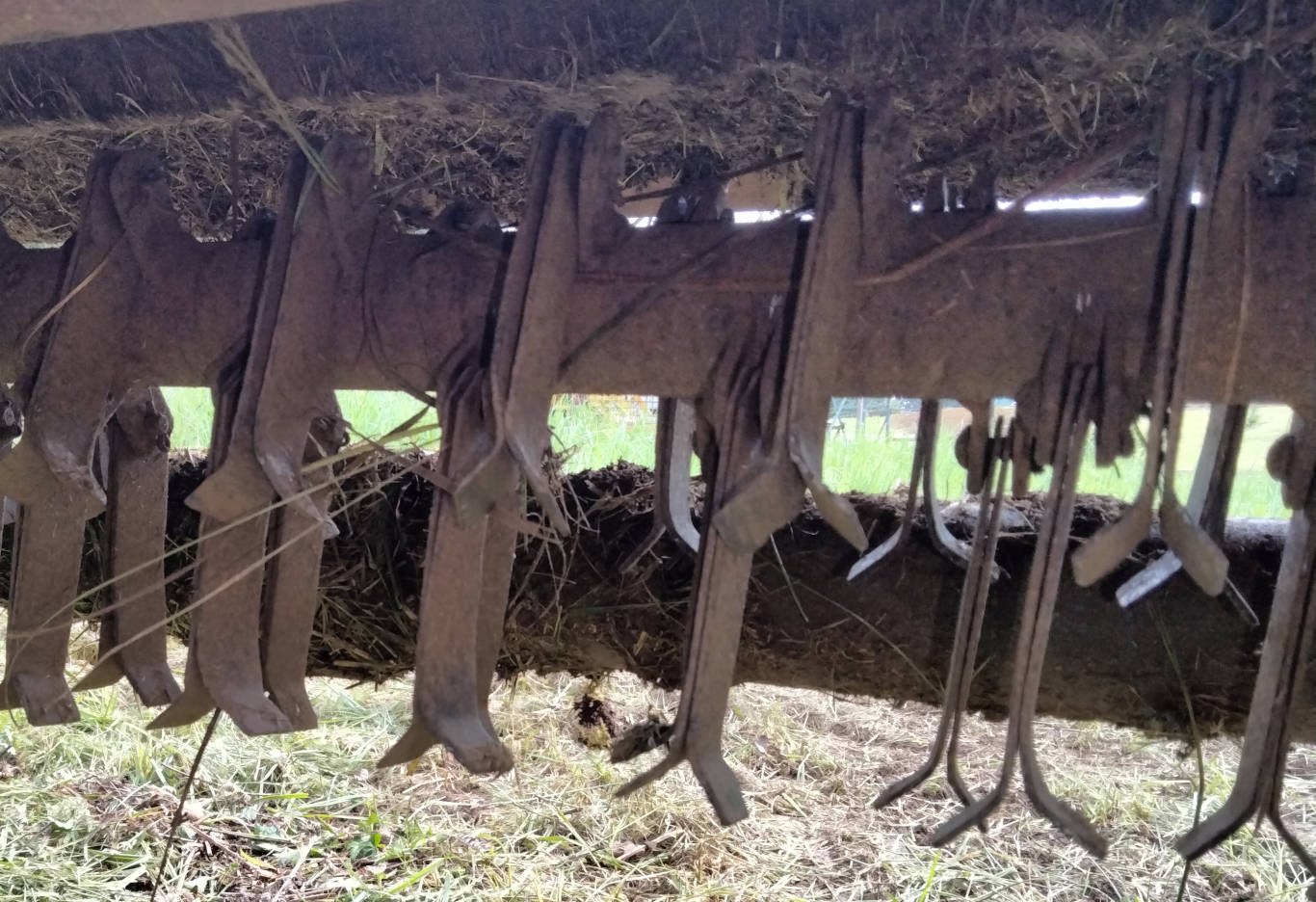

Man, you guys start with the tough questions!!!!
The tractor is a Landini 60F.
Frankly I'm not quite sure what the mower is. It is about 5 foot wide. I do intend to mow both backwards and forwards.
Excuse the upper link pin. I'm still working on getting stuff working. The Landini is still a work in process too.
Anyway, I'll probably keep this old yellow setup for steep mowing of blackberries. Perhaps I can get some grass seeded. And it is pretty clear that the slope isn't at all uniform, so perhaps that rear roller will be vital, unless I get it replaced with something better.
I did pick up an older Rinieri TRC 185 70" Flail Mower yesterday. It is stunning the differences between the old yellow mower and the TRC 185. The TRC has obviously taken some abuse, but it is made STOUT. I was hoping for hammers, but it has heavy duty knife flails which may suit my needs. I'll upload some photos once I get it unloaded and start testing.
The TRC 185 (new) is listed at 50 to 80 HP and 1210 lbs.
I think the Landini should be able to handle it, but perhaps it will be better to keep the lighter mower on it when mowing the steep stuff. I'm maxing out at somewhere around 45°.

I love seeing that Mott Interstater Flail Mower on the back of your Landini,
how old is the Landini?
Are the side panels missing on your mule??
A new replacement rear roller will help you a great deal if you decide to
invest in one and new bearings and bearing mounts.
The rubber guard is something you can replace with a wide
round baler belt and new nuts, bolts and washers.
Whether you want to sharpen the side slicer knives or simply flip them
is an issue you have to mull over as the knife mounting stations do not
look healthy and the mower has seen a great deal of use and removing
the nuts with a grinder would be the way to go on this.
Mowing in reverse allows you to knock down whatever you wish to mow
in 2 passes as long as you travel slowly and allow the knives to work to
make small clippings that you can recut again.
Once I get going I'll look at that closer. The mower seemed to shred anything I needed to shred as is.
However, those look like cotter pins and not nuts. So, they should come off relatively easily. Then I just have to determine if they're worth saving... the pins and not the cotters.
   / Let's talk flail mowers #7,970
I just replaced all the pins and cutters on mine as well as rebuilding the roller. I would much rather do the cotter and pin then the bolt & nut like on my New Holland 918H. The pins had some wear but most of them probably would have been fine for another round.
