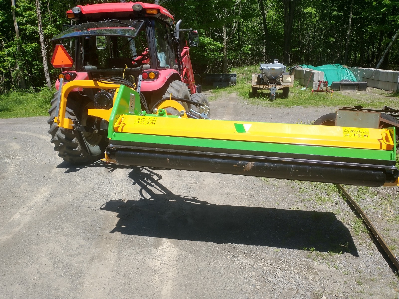

Thanks. This was my concern - the torque forces when extended out and to the side. I have a loader so I am thinking my front end should have enough weight and my rear tires are set out all the way. It is the side shift part that concerns me. Do you think the 10” /50lbs reduction of the smaller unit (132) will make enough of a difference?
I have a 78" ditch flail on my Branson 8050, with the loader and weights on the tractor I'm a bit over 11,000 pounds. I can definitely feel it when the mower is offset all the way out, I have considered adding another 600 pounds to the left side of the tractor to compensate for the mower.
With the OP's tractor being under 4000 pounds I can't image how that would throw that tractor around.
