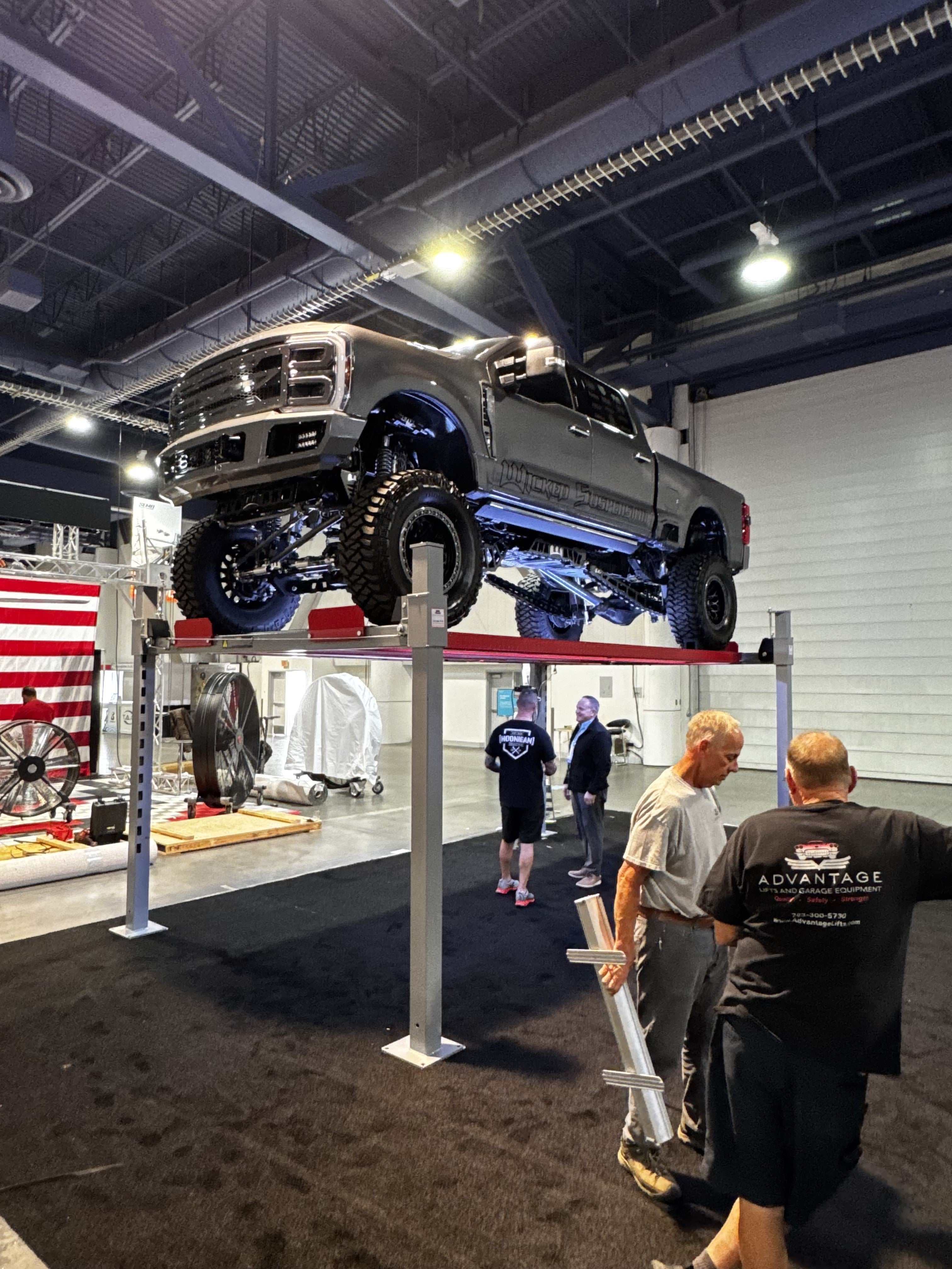

My two cents: lift. A pit sounds tempting, but they don't work very well at all in the real world. Rarely will you need to lift up a tractor. Two or four post is your real decision. You'll need a 12' 6" ceiling minimum.
Mine:
