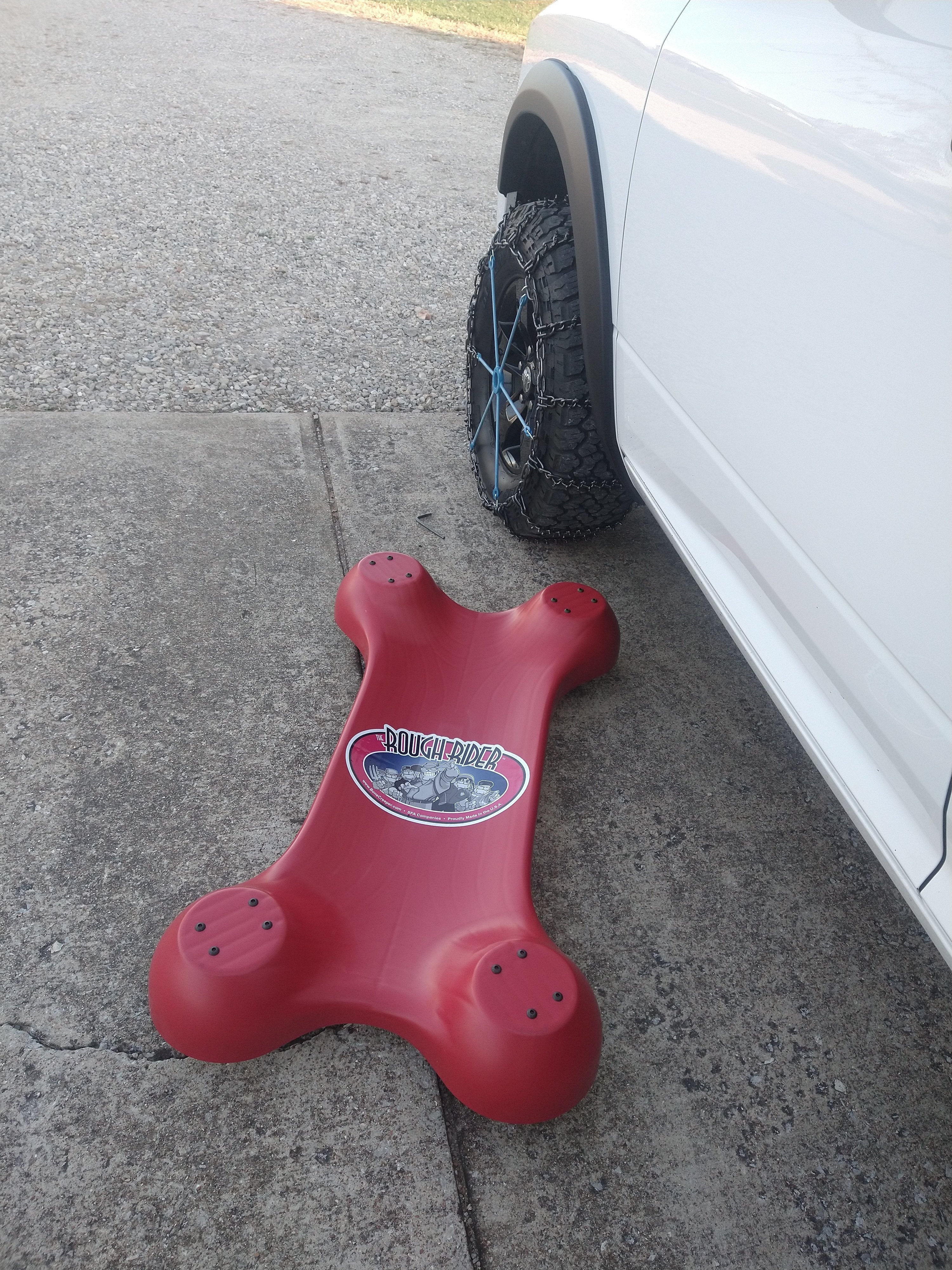

Or meow! ?
Cats laying on the picture of the dog that the creeper came in !
At least I can't fall too far off the creeper, and my truck/tractor can't either ... This also works on the gravel ...
Guess I'm just too cheap to spend money on a lift!
