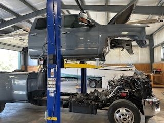

My 4 post is old. There are 2 beams that run the length of the lift and a frame on each end that locks into the columns . I can block the spring hangers to the beam and then lower the ramps to do tire and brake work. The ramps provide a nice work surface to put tools on but sometimes they get in the way trying to reach up to get to the fuel pump or power steering pump.
I did make some plywood boxes to fill in between the ramps when the ramp is down so I have a close to even surface to walk across when I am not using the car hoist.
