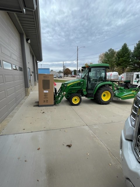

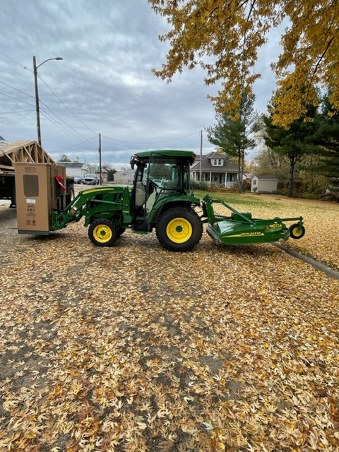

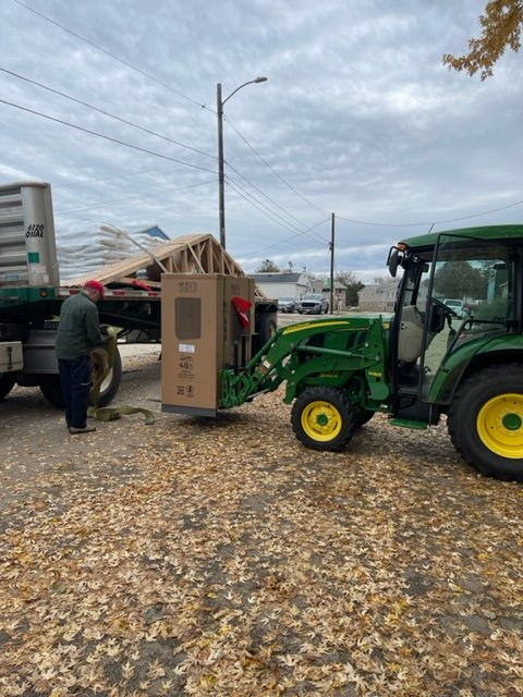

Taking the safe off of the trailer ended going smoother than I thought It would. First slide forks under and lifted off the trailer bed, without backing up. There were a lot of other materials on the trailer so couldn’t have him drive out from under the lifted safe. Was very smooth, no feeling of tipping. Backed up very slowly to get clear of the bed and put just about on the ground. Slow pace into the garage was also very smooth.
I strapped myself in, always do even since darn near tipped it. Did air up tires, they were pretty low. Took it slow … no problems. The only thing I didn’t do that I should have, was to strap the load in. No issues, but will make sure and do that next time.
