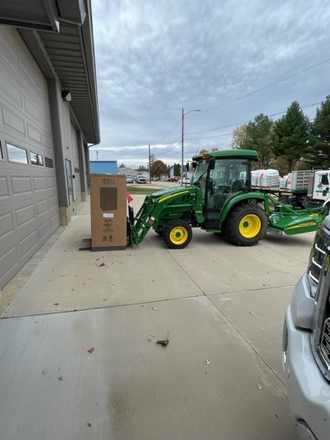

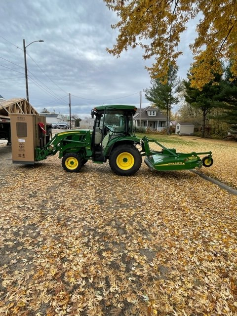

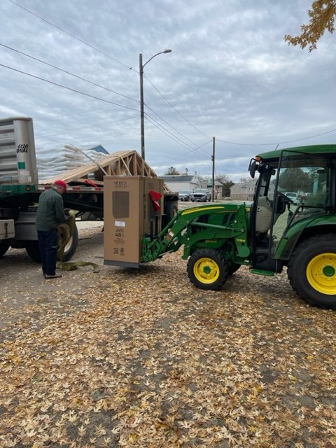

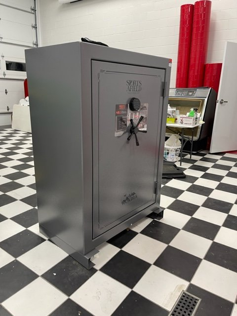

Taking the safe off of the trailer ended going smoother than I thought It would. First slide forks under and lifted off the trailer bed, without backing up. There were a lot of other materials on the trailer so couldn’t have him drive out from under the lifted safe. Was very smooth, no feeling of tipping. Backed up very slowly to get clear of the bed and put just about on the ground. Slow pace into the garage was also very smooth.
I strapped myself in, always do even since darn near tipped it. Did air up tires, they were pretty low. Took it slow … no problems. The only thing I didn’t do that I should have, was to strap the load in. No issues, but will make sure and do that next time.
Many thanks for the advice!
Jim

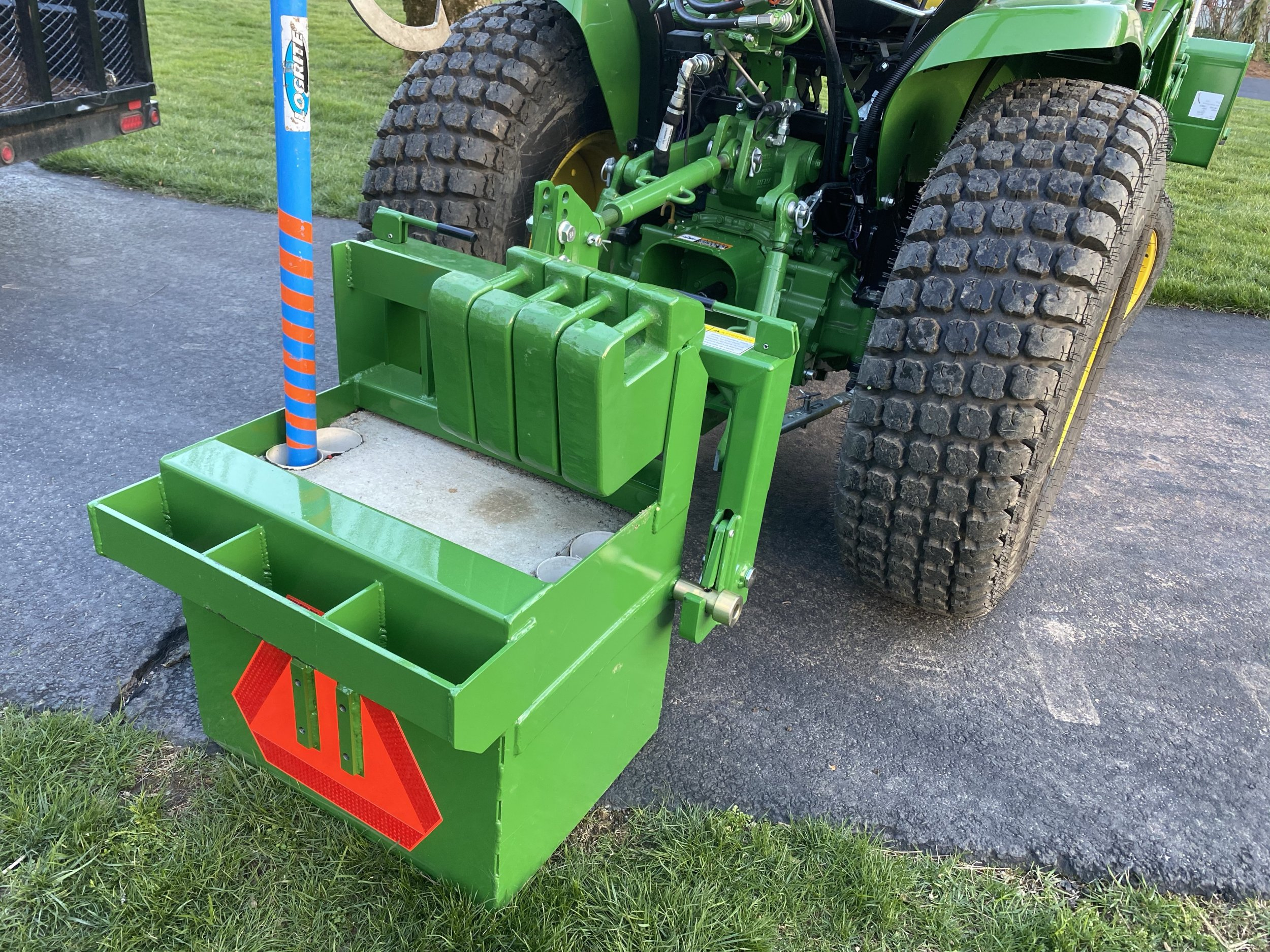

If you can will you post a picture of your ballast box? I need one and trying to get some ideas that will work for me.
TYA,
Duane
I'm not Jay, but here's mine. Tubes hold rakes, shovels, cant hook, etc. The tubes are PVC with a cap glued on the bottom end, center-drilled and bolted into tapped holes in the bottom of the box, so they wouldn't float out when concrete was poured. Bolts were removed after concrete cured, so now tubes drain straight out the bottom, an excellent feature given that this box is a too-convenient place to set your coffee or gatorade, when working around it.
Box plus concrete weighs about 750#, and I welded extra bars on it to carry an additional 8 suitcase weights up top and another 9 across the back. The distance from 3-point pins to COG to those nine suitcases across the back is substantial, providing a lot of hold-down force for heavy lifts on the loader.
In addition to this, I welded plates to the back tapped with 1/2" UNF thread, for bolting a hitch receiver onto the back of the box at an ideal height. The whole thing is iMatch compatible.
If I could do it all over again, the only things I'd change would be:
1. Use something more durable than thin drain pipe for the tubes
2. I'd sink the receiver partly into the box, rather than bolt on. Even when I remove the hitch itself, the receiver still sticks out maybe 7 inches, and I've backed it into things, and banged my shin on it walking around the tractor, which is why it's usually removed.
