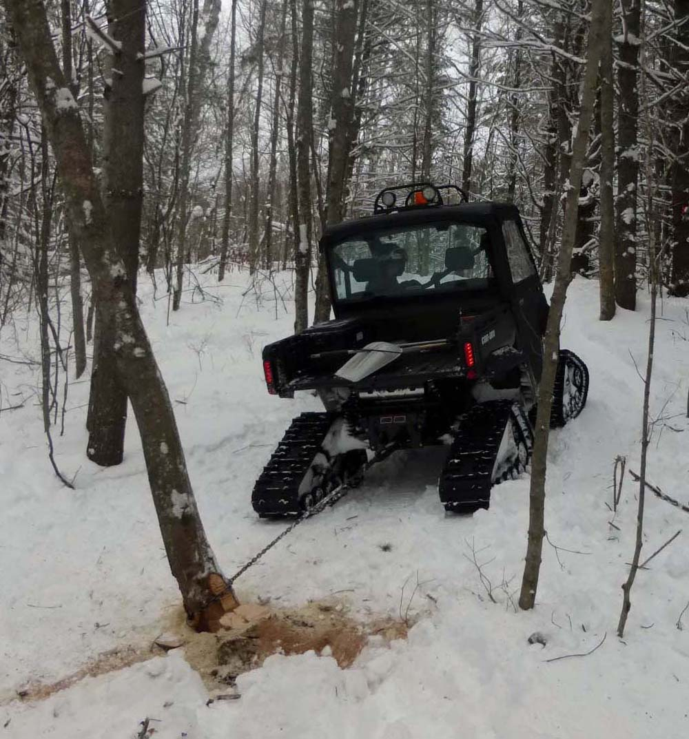

Cable chokers weigh less than chain. I like cable chokers for pulling logs as the cable is easier to stuff under a large log. But they are a pain to carry on the tractor and store. Chain chokers can be dumped in a box. I got G100 chain chokers from westechrigging.com. G100 costs a little more than G70 but it's lighter for the same strength. I made grab rods out of scrap to make it easier to get the chains under logs.
   / Lighter weight log chains -- where to buy? #34
Here is a UTV towing trees with a 5/16 choker high grade chain. Loved it so much I got one for my personal use and store it in a plastic ammo can in the machine. No problem! (y)
