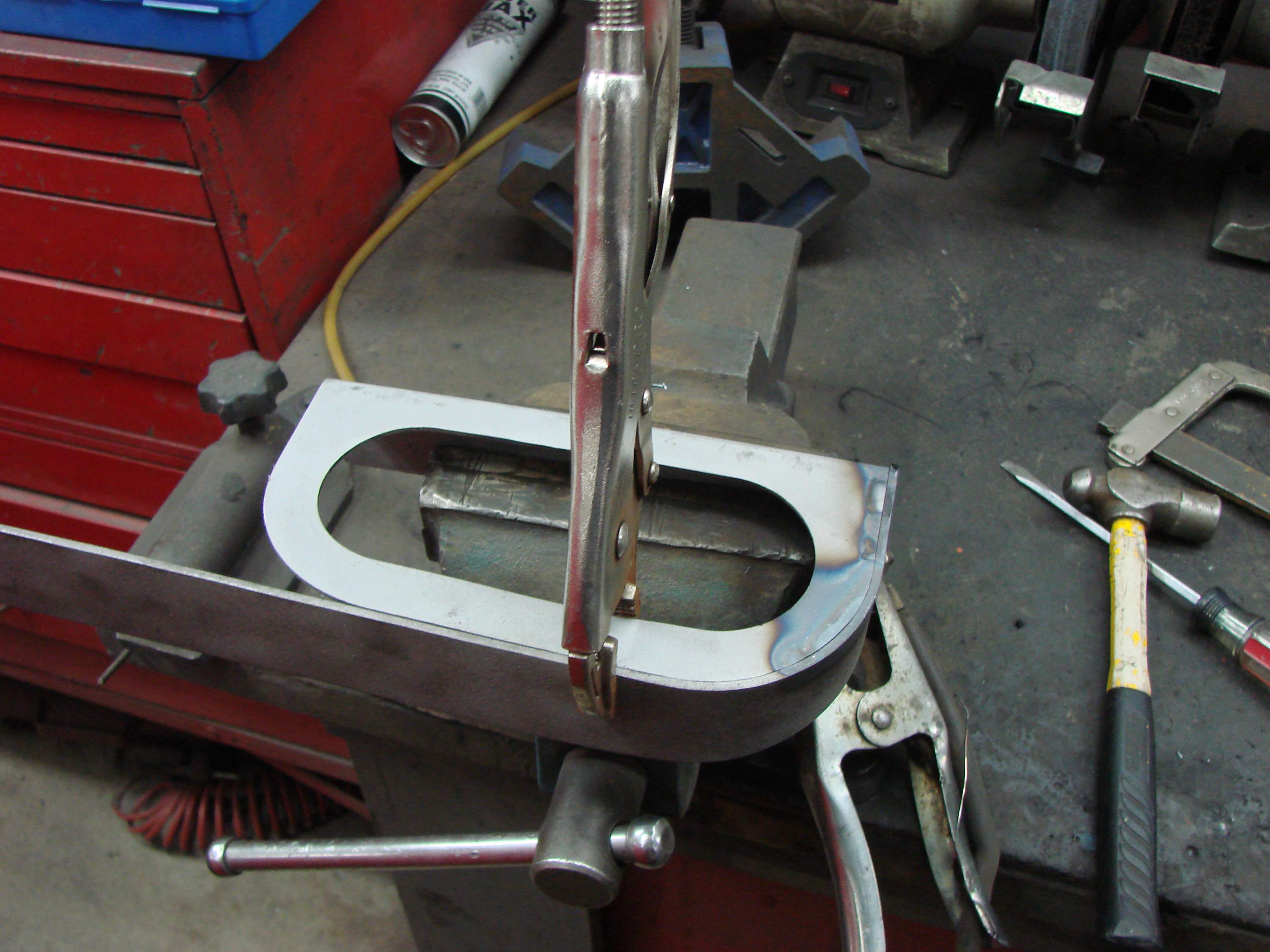

How did you bend the steel to wrap the top of the lights? Your fabrication is excellent!

Are you asking about the light on the top of the cab or the rear snow blower? If it's the top emergency light bar your asking about I used 3/4 pipe and bent it with a 16 ton pipe bender. If it's the rear lights on the blower your asking about watch the video and it will show how I did that. Thanks for the compliment sir.. :D

On the back of the blower. The rounded tops on the boxes looks a lot nicer than what square boxes would in this application, plus no sharp corners.
I think I just looked at all the pix and missed the video. I'll go back and check it.
/ Lights, Camera, Action #46
Nope, watched the video. One shot shows it tacked at the end and the next shows it from the other side with one side wrapped and welded and vise grips holding the center tight. Don't see how you made the bend.

Cyril I basically tacked the 1/8th flat bar on the end of the light opening and started to bend it with a little heat and with the help of the clamps. You need to take your time and do it in small steps and as you make the bend just add a tack weld to the inside to hold it in place as you go along. Nothing to it sir. This photo may help.
The heat was the part that I was missing. I've never welded or fabricated with steel, but want to learn. Little things like using the heat to soften the steel for the bend are good to know.
Thanks
