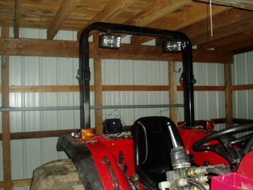

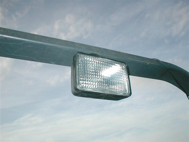

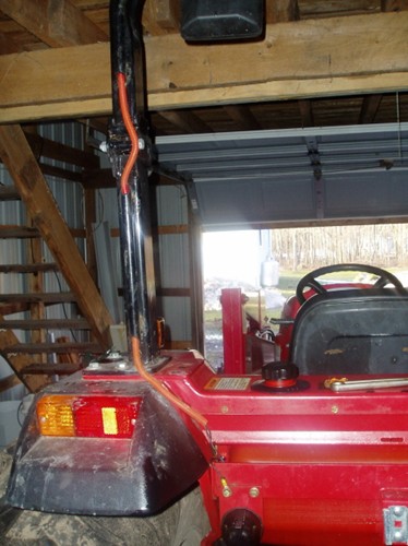

I bought some inexpensive lights from Walmart and mounted them under the ROPS. I also used a relay from Radio Shack to turn them on when I switch the lights to high beams. no new switches to add. I did a few things not normally recommended though, I drilled and tapped the rops and tack welded conduit to the back of the rops to run the wires in.
As far as warranty work goes... My Mahindra dealer had to split my tractor for warranty work with a factory rep there and no one said anything 'bout the modifications. They had everything back the way I had it when THey returned it.

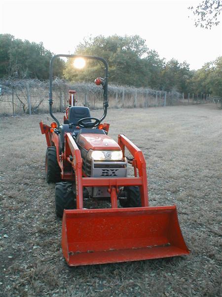

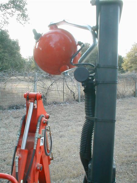

MIne. No drilling or nothing. Lighter receptacle strapped to ROPS and a single magnet light. Works great when I need it. Sits in barn when I don't.
Lighter receptacle has been handy. Have used an amber strobe (for hayrides) and a Q-beam (for grins).
Russell in Texas
