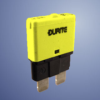

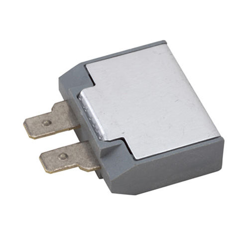

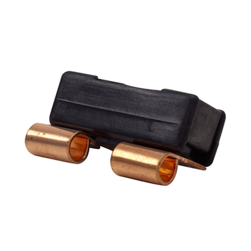

Popped a fuse the other day. Didn't jiggle the bucket enough & the pins hit just below the holes. Everything worked as intended, fuse blew when it started straining a little. Popped in a new fuse & it was working fine. If I were to do it over I might get a $10 automotive circuit breaker & just run a wire up to the battery rather than tie into an existing circuit. Probably not motivated enough at this point to pull the dash apart & wire in the breaker now though.
You may not have to rewire, depending on clearance, replace the fuse with a plug in circuit breaker.
View attachment 422620View attachment 422621View attachment 422622View attachment 422623
I looked at those briefly a day or 2 ago. The micro style breakers are auto-resetting & really tall. I'm not sure if they would clear the cover for the fuse box. I'm also not a fan of auto-resetting in this use case. If I forgot the switch down, or didn't notice it jammed, the breaker would continually reset itself every so often then immediately pop again negating some of the value. It's handy to have my bucket cam on the same circuit as it will turn off at the same time.
