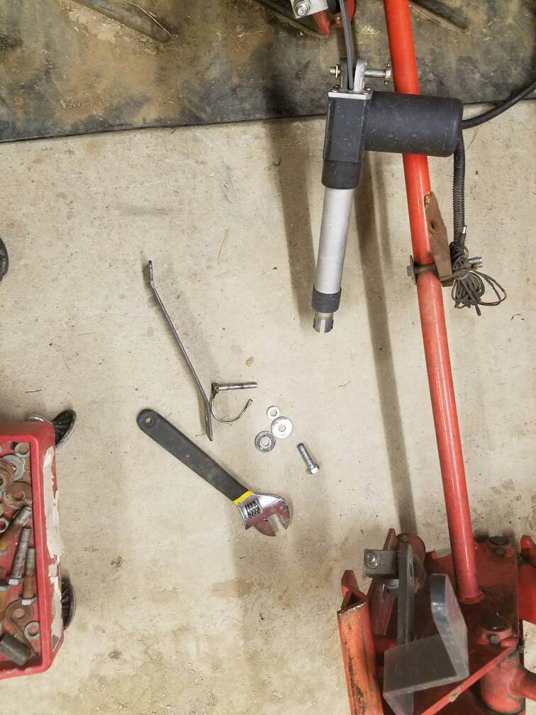

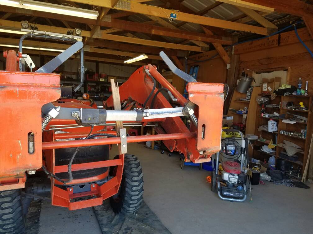

Update...
The bar connecting the actuator to the levers has been bent for a while. I assume when the pins got jamed at some point. It still worked fine, but I may be selling mine off & upgrading to a cabbed grand here in a bit, so I'm cleaning it up. At any rate its good maintnance if I keep it.
Straightened it up in the vice. Welded braces on either side to prevent flexing. Hopefully it will preventnit from happening again. Photos are of the test fit before I repainted it.
Pipe or angle iron might be a better idea to prevent flexing & bending. If anybody is planning on copying this.
