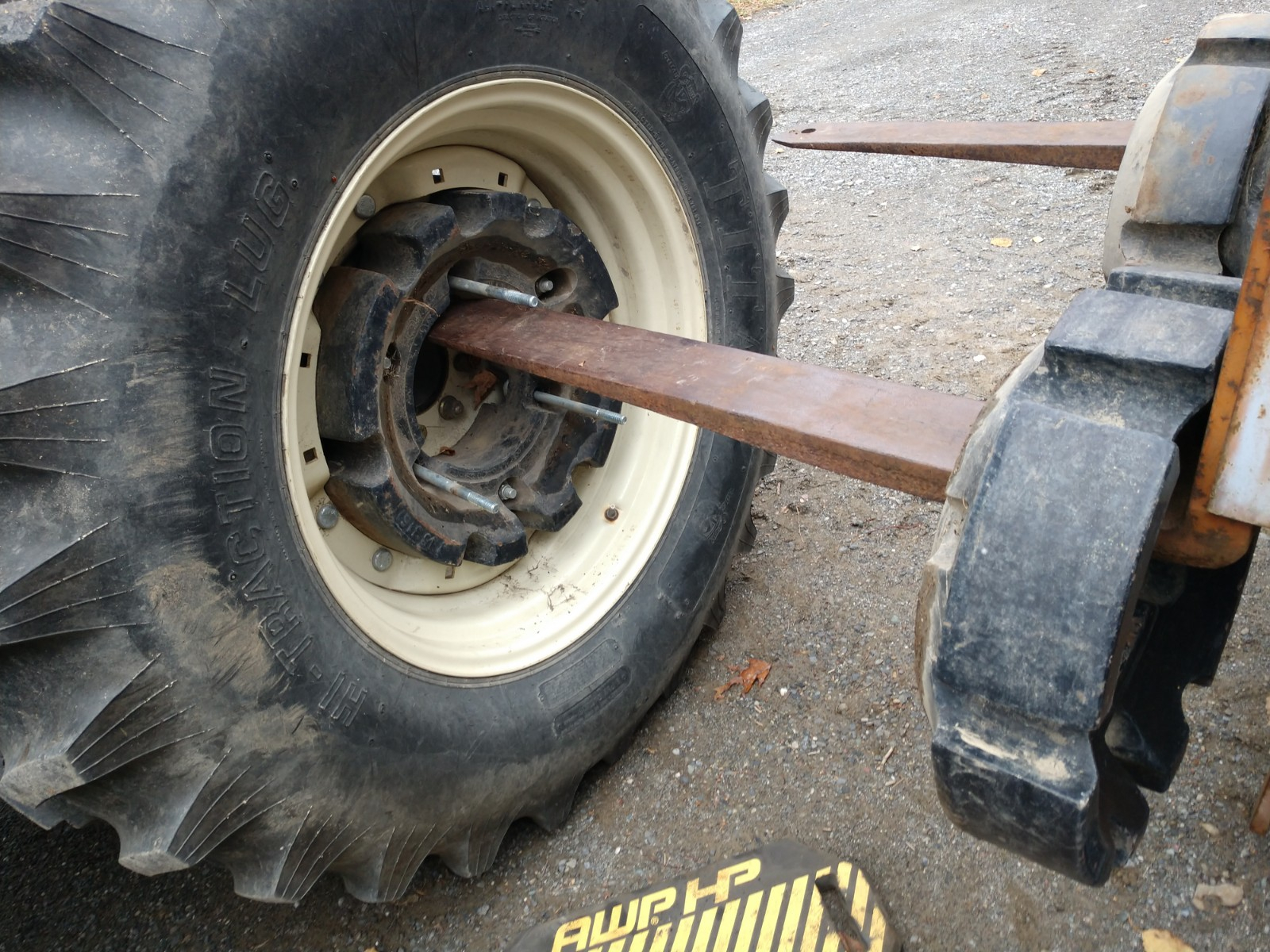

Beet Juice is proven to work and being a liquid, always stays in the bottom half of the tire where you want it, low.
This assumes you fill half of the tire with Beet Juice and the other half with air.
Cast iron wheel weights are also appropriate.
