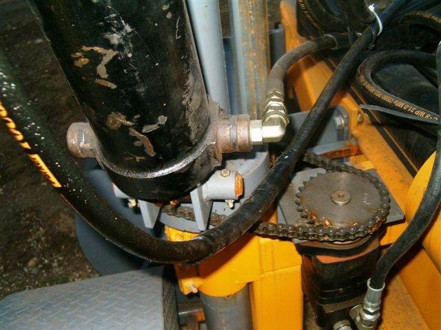

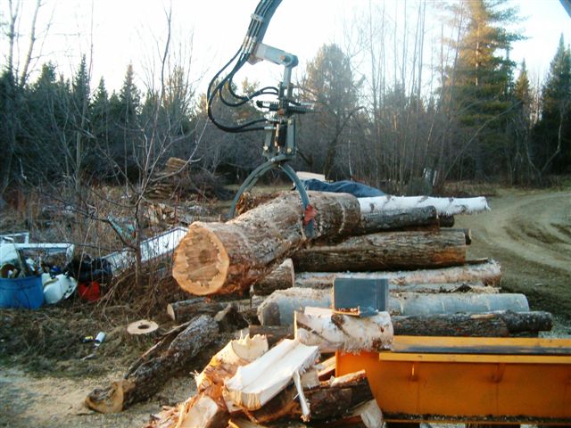

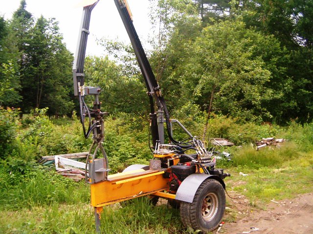

   / Loader for forestry trailer #4
I built this lader from scratch I will lift about a thousand pounds I have used it to load my truck w/logs

sizzami, what are the specs on your log loader? size tubing/box used? how do you rotate it once loaded? what you have is probably what i'm looking at building. could use more info. thanks, harold
   / Loader for forestry trailer #7
3/16 x 2x 4 for boom 3" sched 40 sleeved inside 3 1/2 sched 40 pipe for the mast 1" cr round riding on thrust bearing at the bottom 3/4 thick nylon bushing 6" round for the disc you see in pic to ride on.

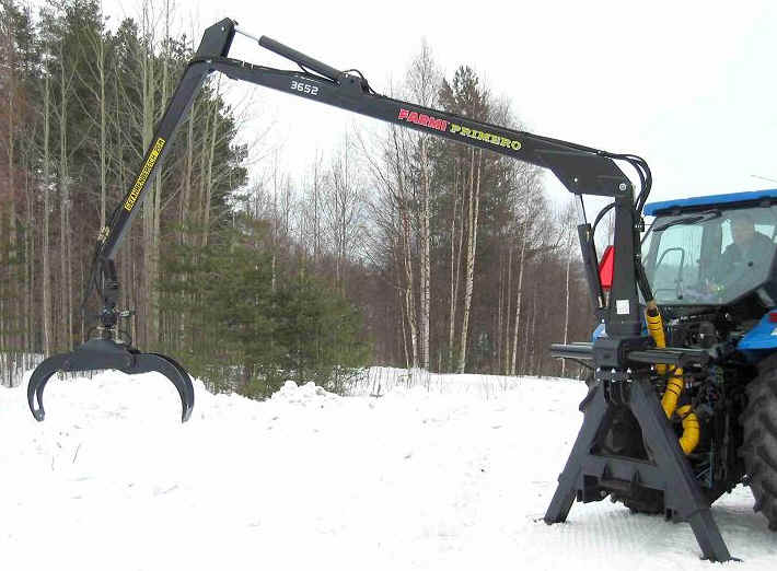

Some great suggestions. The Nova trailer is great but it is only a 1:2 scale model. The Valby loader is perfect, but I'm scared to price it. Fabbing an old backhoe would be fun, but they are generally too heavy for my purpose. I like sizzami's design best. Good excuse for a road trip with a camera. If I can figure out how to send a pm, I will do it, but just in case, where in VT are you sizzami? I'm near Rutland.
