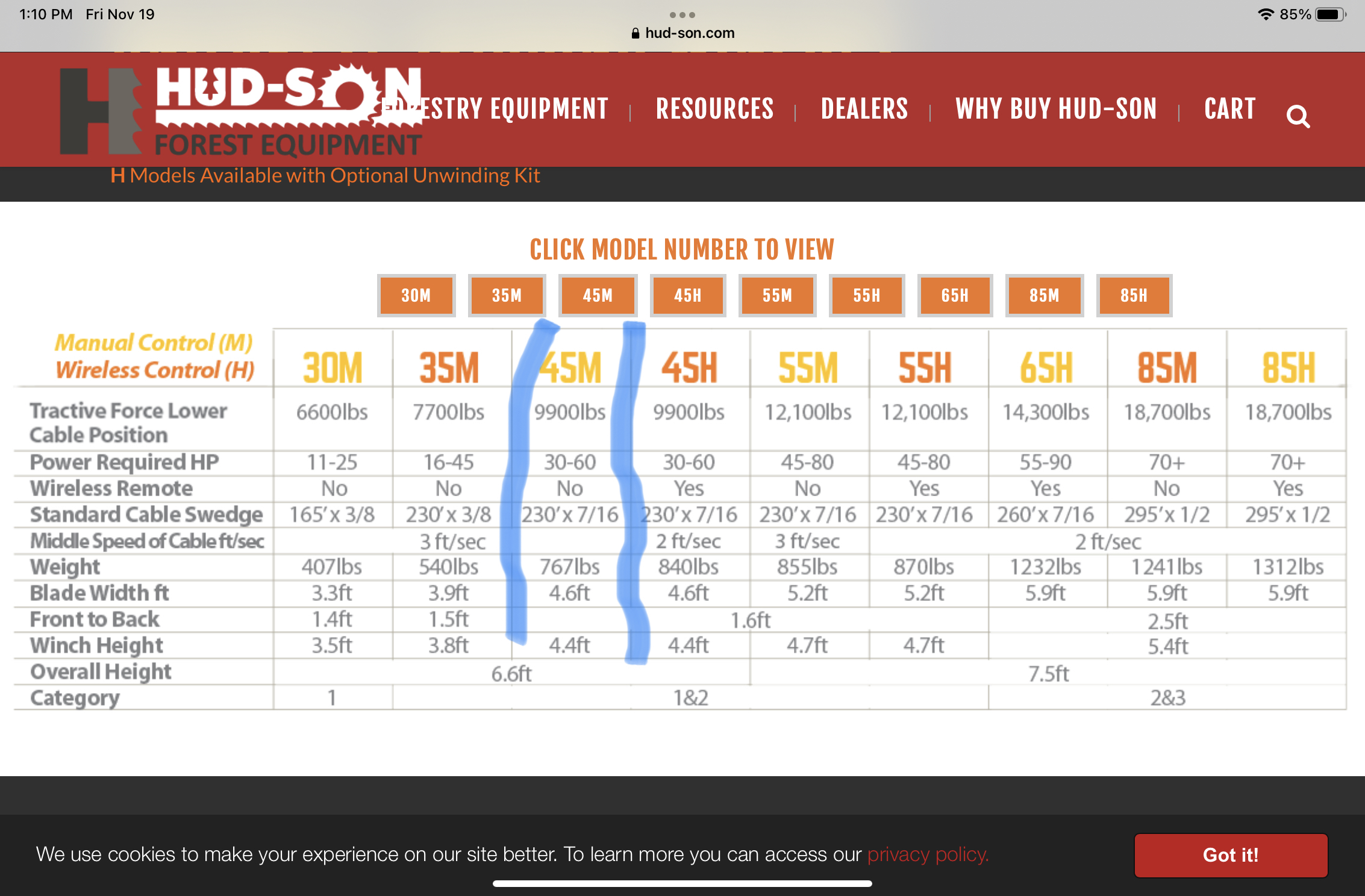

Have you researched log skidding winches, which I think would be almost mandatory for your applications?

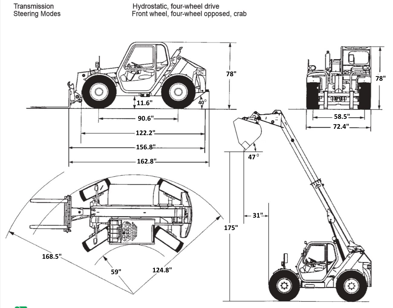

Are there alternative vehicles (tractors) that I should consider - eg, a skid loader vs compact?
A skid loader or compact track loader are designed to push and lift, not pull. Both variants are likely to be much more costly than a tractor of equivalent towing capacity. Tracked equipment is very stable and has low ground pressure but tracks are maintenance intensive relative to wheels.

Own a 45M attached to Workmaster 50 New Holland. This is the way to go for pulling logs. Expensive but you can put tractor in safe place, pull cable to log and bring log to tractor. Keeps tractor out of woods and tires off of hidden stumps. Works really great pulling logs up hills instead of trying to get tractor down hill to log and then pulling up hill to top.
