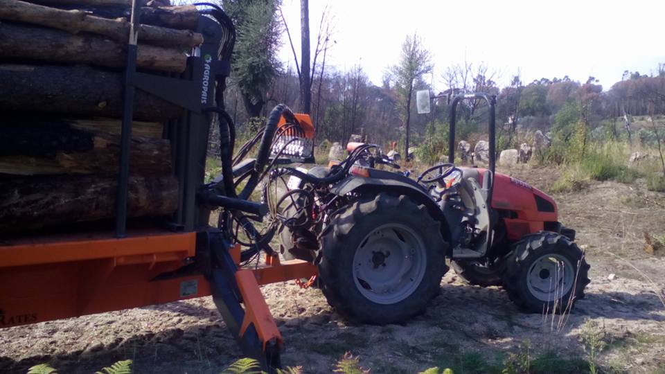

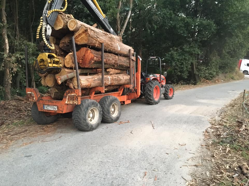

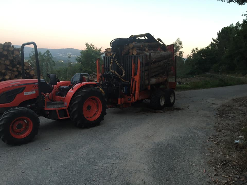

Consider at least 60 HP, loader, 4x4, HST and some gnarly woods chains. Wet clay may be slippery. HST should give better traction control.
You may also want to look at a log winch for those areas you cannot access with the trailer.
Some pictures of log gathering equipment.

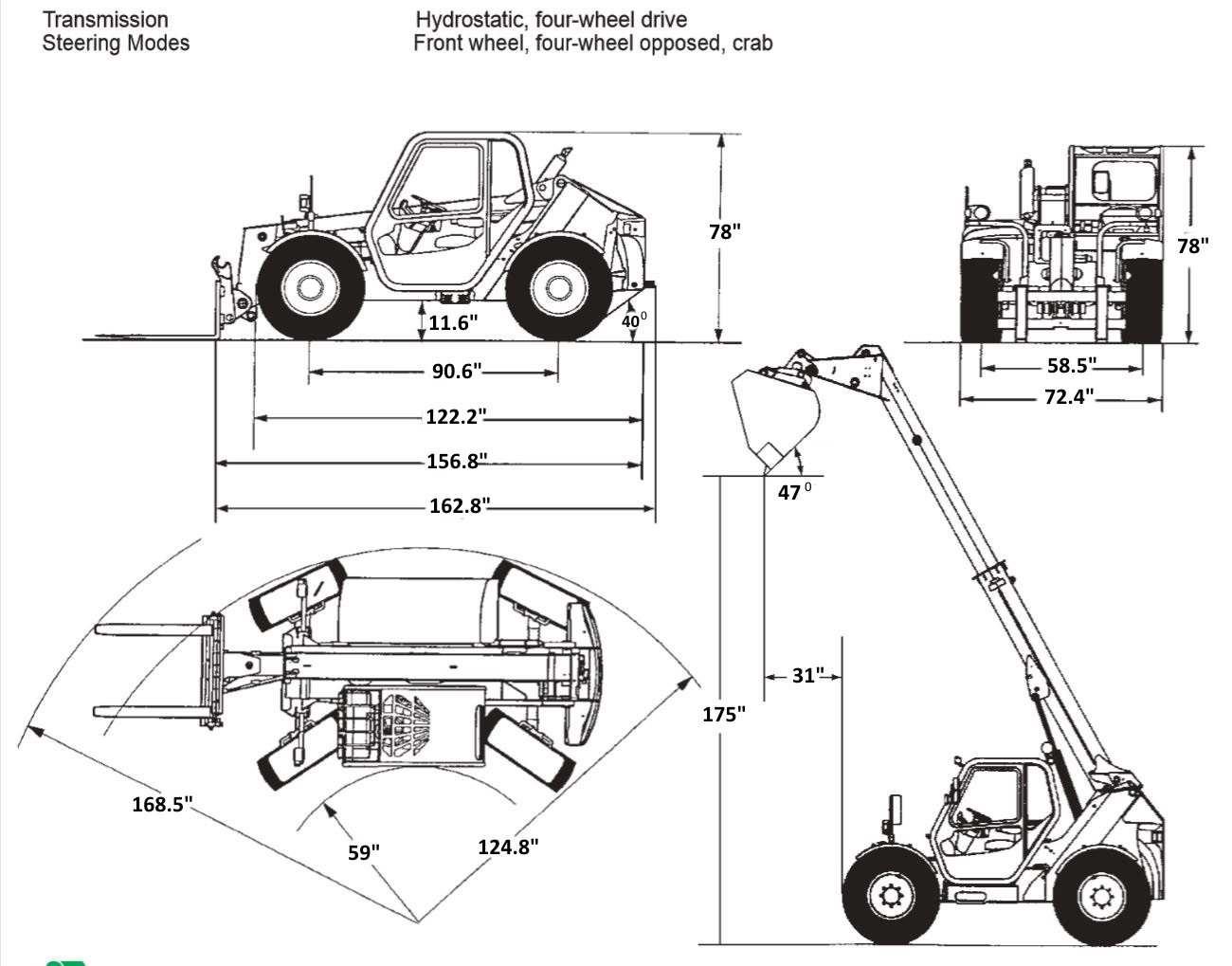

My V417 is rated at drawbar pull of 7,000 pounds
and definitely won't move better in the woods than a tractor. Otherwise, you would see them all over Europe in logging operations, which is exactly the opposite. You just won't see those machines in the woods at all.

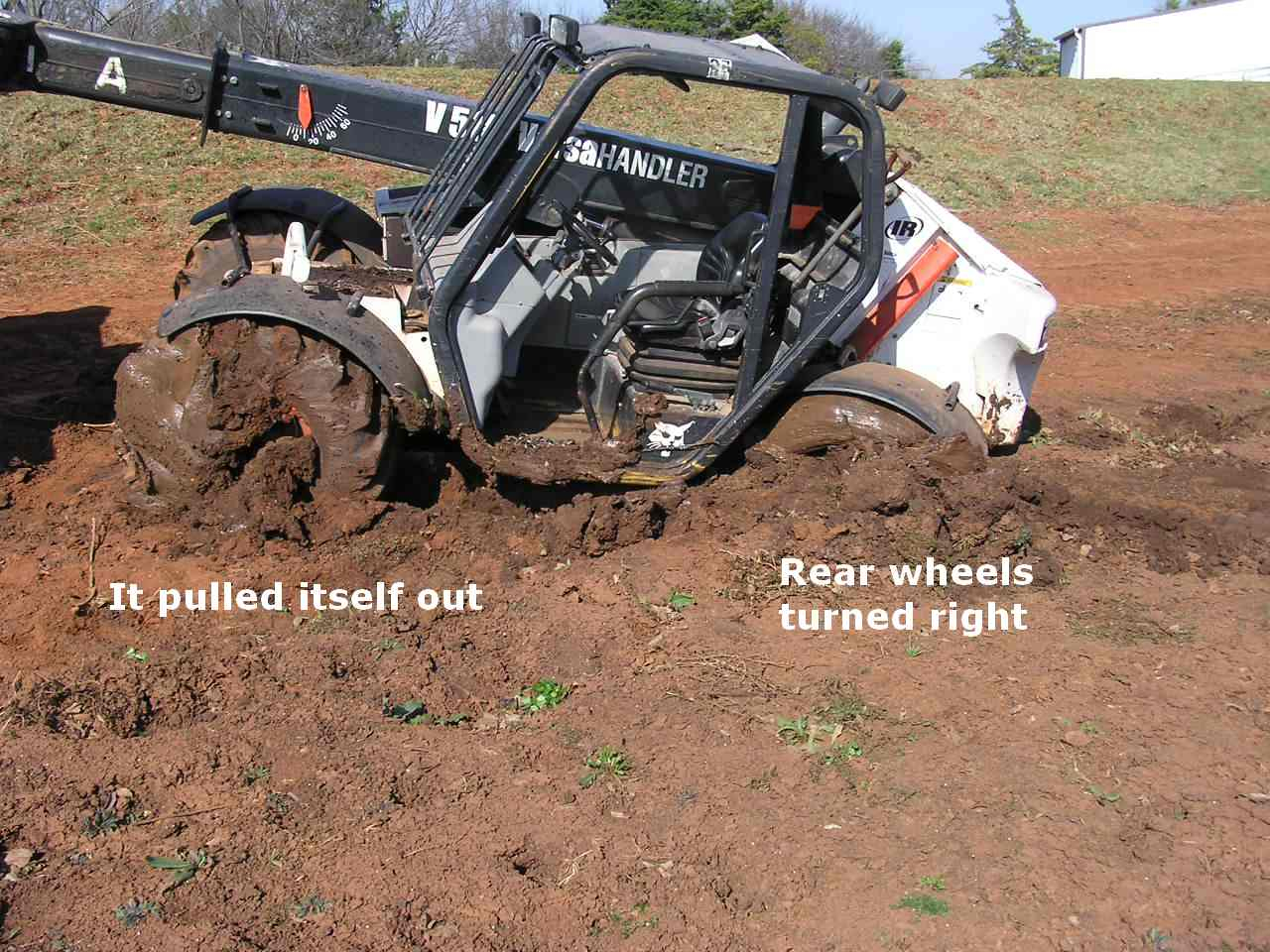

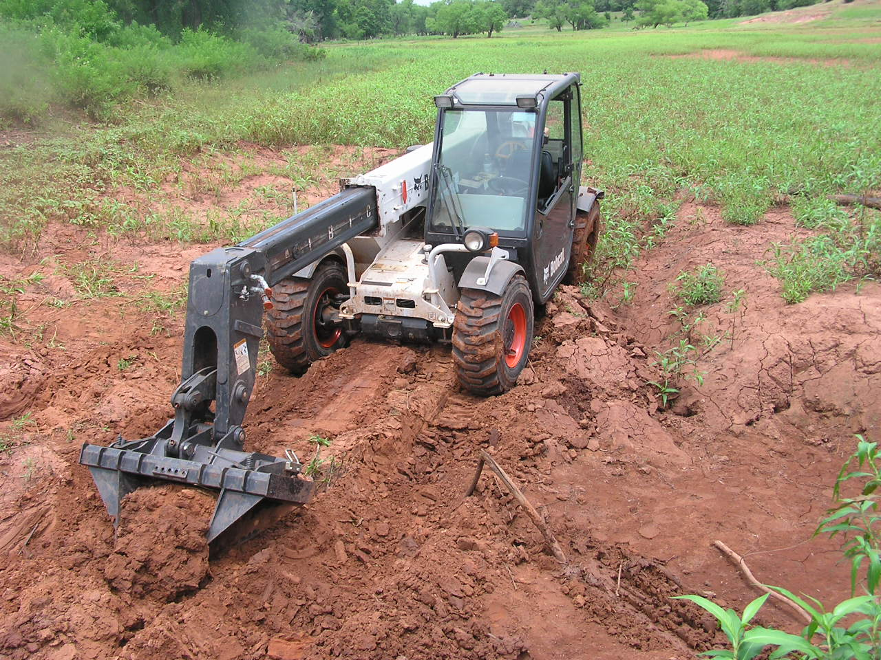

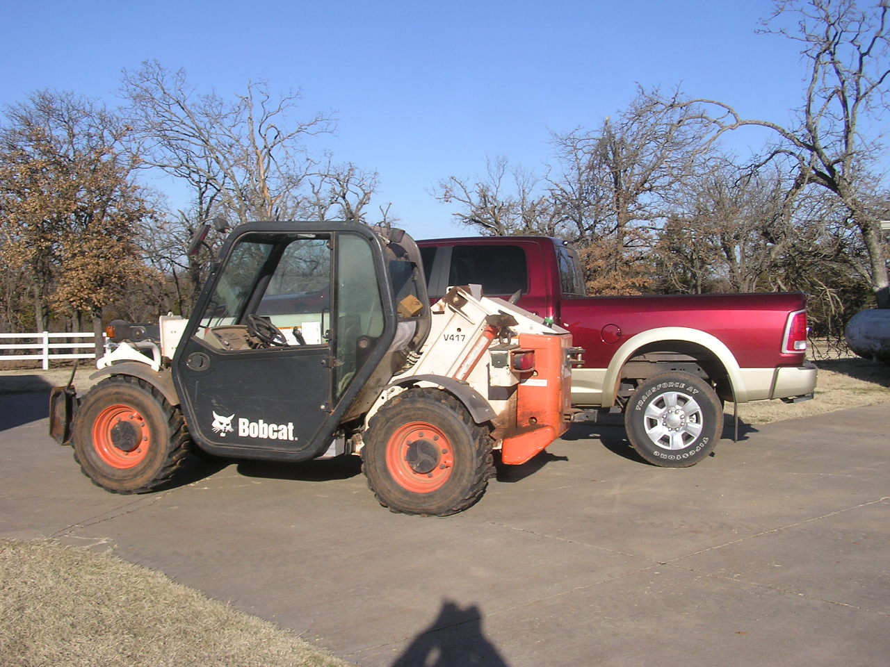

I have used mine in the woods a lot. A tractor could not follow where I have gone in the woods. Turning radius with 4 wheel steer is one reason:

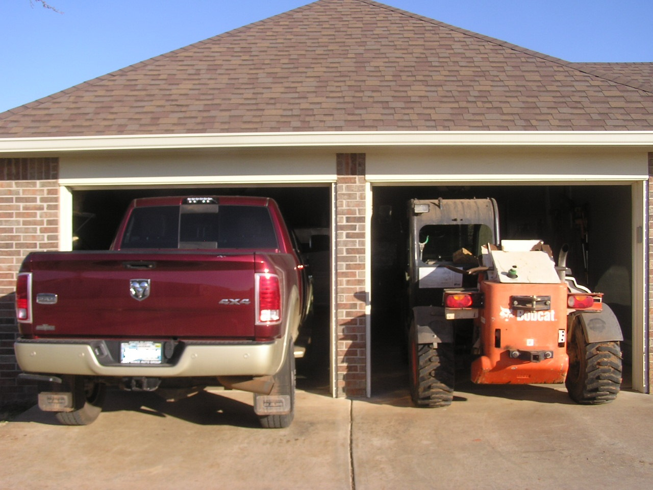

Small size is another reason:
These machines are great for yard work but they simply get stuck every chance they get even if the soil is slightly soft, let alone pulling a trailer or something.
I have owned two different Compact Telehandlers and they can get motion impaired in silt or deep mud. But using the boom have always pulled or pushed themselves out:
Pushed itself out:
View attachment 721280 View attachment 721279
My 35 HP tractor is rated to pull 7,700lbs and it's like a third the size of that Bobcat, it only means it would sneak even easily in the woods and it actually has the ground clearance to go on the woods.
A 75HP conventional tractor is rated to pull 17600 lbs.
Sure the telehandler can pull it self out sometimes but on the other hand the tractor would've just kept going.

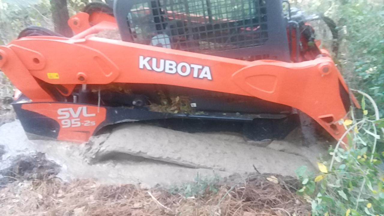

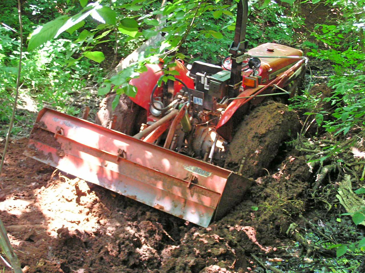

Not in the silt, just stuck in deep mud. MF240D 4 wheel drive:

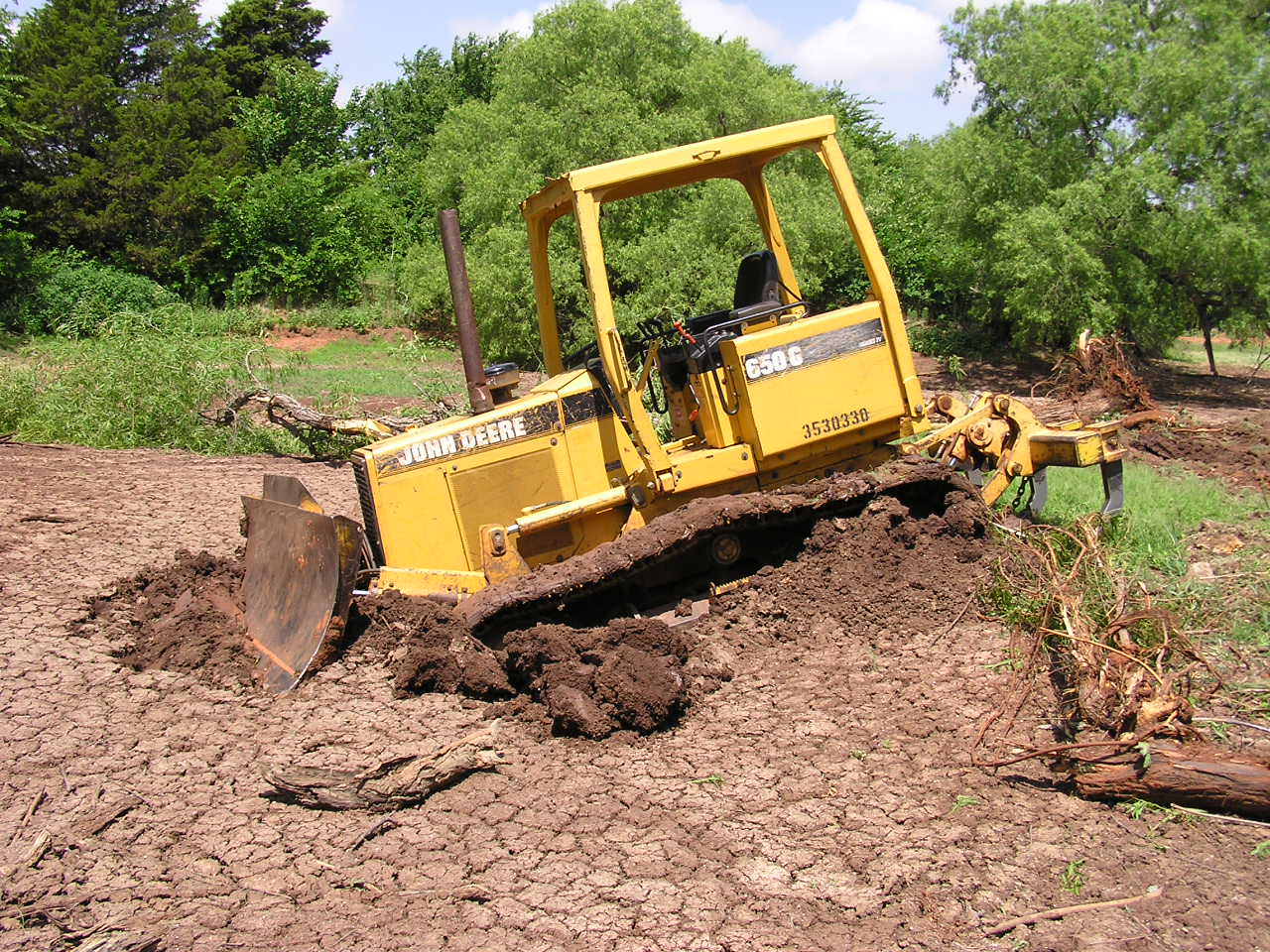

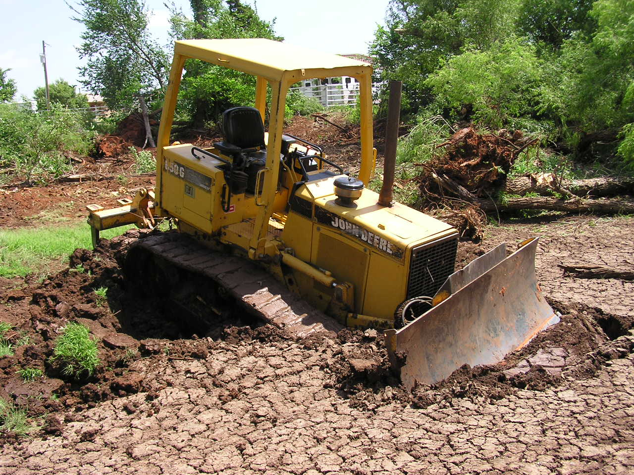

The neighbor's dozer stuck in the silt around our pond:
   / The right tractor for towing/forestry work #32
^^^^ Your telehandler would be just as useless as that tractor if it also didn’t have the loader.
