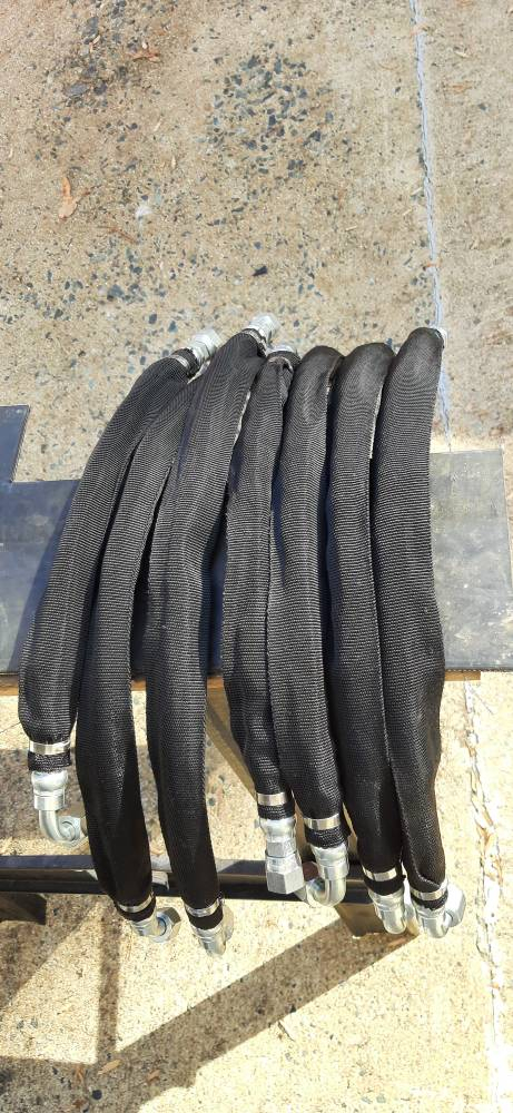

If you go through Discount, get the hydraulax tough(HT) or at least the 100R16 hose. The other hoses don't seem to hold up as well and are much tougher to work with.
I just did all my loader hoses on my L3240 recently after I blew a hose, looked ok on the outside but but still let go.
The tractor sites outside more then I like so I put sleeves on all the hoses for UV protection. Luckily I bought a hyd. hose crimper not too long ago so I can make up my own.

When my tractor was new 20 years ago I covered all hydraulic hoses with split poly looming for wiring harness' and just used cable ties at each end to keep them from getting peeled off. My tractor has lived every single day outside since and I've only replaced 2 hoses in that 20 year period. The only 2 hoses not covered are the 2 short ones to my toplink cylinder and I did have to proactively replace them year before last as they showed MUCH cracking as they are short (18") and stay flexed sharply all the time. Those 2 hoses I bought from Surplus center at very reasonable prices. The other 2 I've replaced over the years I had done at local parts stores and they were very expensive in my opinion PLUS they didn't have the exact same fittings and were a real pain to install as they were larger hex size at the bunch on my loader valve and the hose was the next size larger to boot too.

The hoses on my Kubota B20 were rubber over nylon braid. The rubber was falling off and soon the hoses would start leaking. Replaced the first couple from local hydraulic shop. Then ordered 11 from surplus center at considerable savings. All two wire with tuff guard rubber. Had bought a roll of nylon sleeving and used that too even if equipment is stored under cover.
