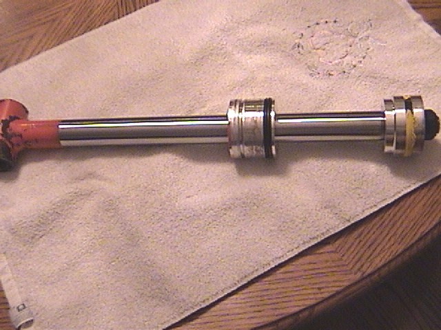

/ Loader problem Cylider or Valve...Help! #14
Here is your problem. Mine was not under warranty, so I did it myself. Under $10.00 for new seals.
I think yours will be warranted.
Good luck,

Brought it to the dealer today and here is the diag. No valve problems, but both cylinders had problems. On one cylinder the nut completely stripped off the rod and on the other cylinder the nut was loose, as you would imagine this caused the malfuntion. The fix: the dealer has ordered two new cylinders and in the mean time they welded both nuts onto the rod and reinstalled the cylinders. Everything is working now and based on my discusion with the service manager the cylinders in this state should be fine for years to come, unless they start to leak. I plan on storing the new cylinders in my shop and using the fixed (welded) cylinders until they malfunction. From what I understand, from a friend at the dealer, one of Kubota's biggest issues is the with their cylinders. Thanks for all the help.

First of all MikeVT, good to know you are back and running! It is a really odd ball failure, but ... By the way, those nuts are usually held on by 4-600 ft-lb of torque and some locktite. Guess there is a guy on the cylinder assembly line that wasn't paying attention.
As to why the cylinders would extend, that's easy. The pistong that has the seals wasn't attached to the rod, so the rod could move. Fluid was able to flow thru the piston's center hole so the bucket moved. Remember that both cylinders are connected together.
jb

Larry,
Can you see that with the nut from the piston off, fluid would go thru the hole in the piston where the threaded end of the rod is supposed to be? That fluid path would enable the other cylinder to move (it was still connected).
Why did it move when the engine was running? My guess is that the vibrations from the running engine and the weight of the bucket on the one remaining cylinder was enough to get it to move. There is several hundred ft-lb of torque wanting to rotate a bucket down.
Is any of this a 100% certainty? Naw, just my best guess from the facts stated and a bit of experience with cylinders.
