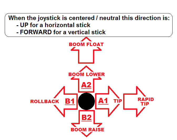

Understanding and agreeing with the importance of this, please confirm that the attached pic shows the "norm" / convention for loader joystick operation (?)

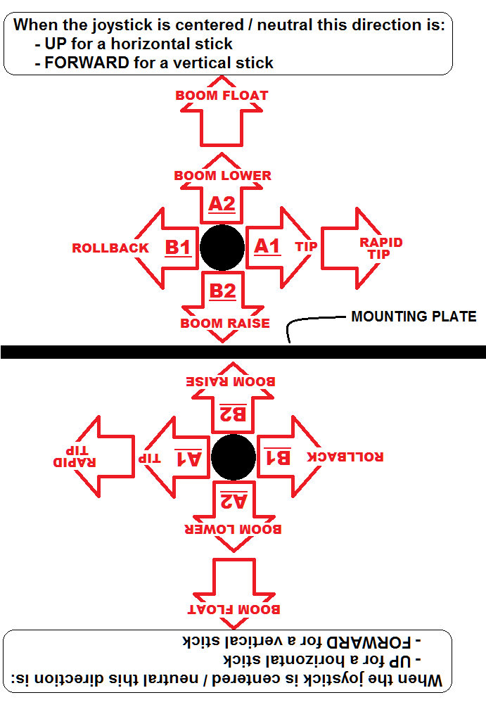

..... Two, figure out a way to mount the valve upside down. ....
If you do that to get the boom operation oriented per the "norm", would that result in the bucket being reversed from the "norm"?
Is your original valve mounted above or below the mounting plate?
I'm wondering if the confusion about the valve / joystick orientation spec has to do with the mounting plate - i.e. is the valve intended for 'top mount' vs 'bottom mount' or vice-versa? Realizing that changing the mounting plate location may not be possible or very difficult, unfortunately. See attachment 2.
FWIW I ran into this when recently replacing the FEL valve on my Yanmar - the OEM valve had the mounting plate above the valve, but all the readily available replacements were intended for the plate below the valve. Study revealed that indeed the valve body is machined differently (internally) to keep all the operational orientation 'correct' (could not be fixed by swapping joystick parts, spools, or 'upside-down' mounting of the valve). I ended-up, granted with a bit of difficulty, changing the tractor mounting plate to fit the replacement valve since I couldn't find a valve to fit the tractor mounting plate at a reasonable price.
All of this also applies to "Left" vs "Right" for 'side mounting plate' valves.

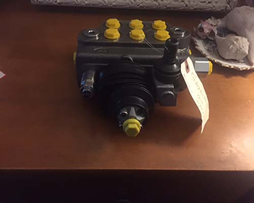

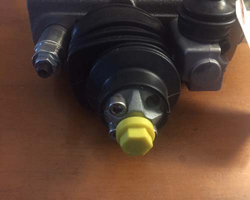

I called the guys I ordered the valve from today and was told they will research if a field change is possible. Also he told me that the handles would be coming. Below is picture of valve as requested.
This is the correct orientation for my application.

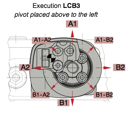

   / Loader Valve Recommendations? #58
OK, understanding that port assignment/function may vary depending on the valve/spool and stick arrangement differing by manufacturer or valve model specifics ...
In the pictured orientation (Port A1 Up or Forward) which port on the valve now in hand has the boom float beyond the 'working/pressurized' position?
I believe you mentioned this valve has no regin/rapid tip, but if so, which port is that on?
When you lift/push the stick, which port is pressurized (confirming it's A1)?
When you push the stick to the right, which port is pressurized (confirming it's B2)?

The valve in hand has the pivot at the bottom left. You are correct that there is no regen so left to right will not be an issue as it is just proper hose placement.
The diagram I provided would be the one I would need. Float is on first spool. Float is achieved with spool out.
I received an email today stating I could not change the float direction. This was not my question which tells me the person I am dealing with does not understand the issue. Despite me sending him the correct order number, he doesn't get it.
Now I am left with finding a way to mount inverted or fabricating a new pivot block. I will take the valve apart this weekend and see what I can do. I might could order the correct block from a different company but not sure if there is a way to install because of screw placement.
From what I can tell there is 4 options with two different blocks. The one I have can be pivot at top right or bottom left. The one I need could be bottom right or top left.
