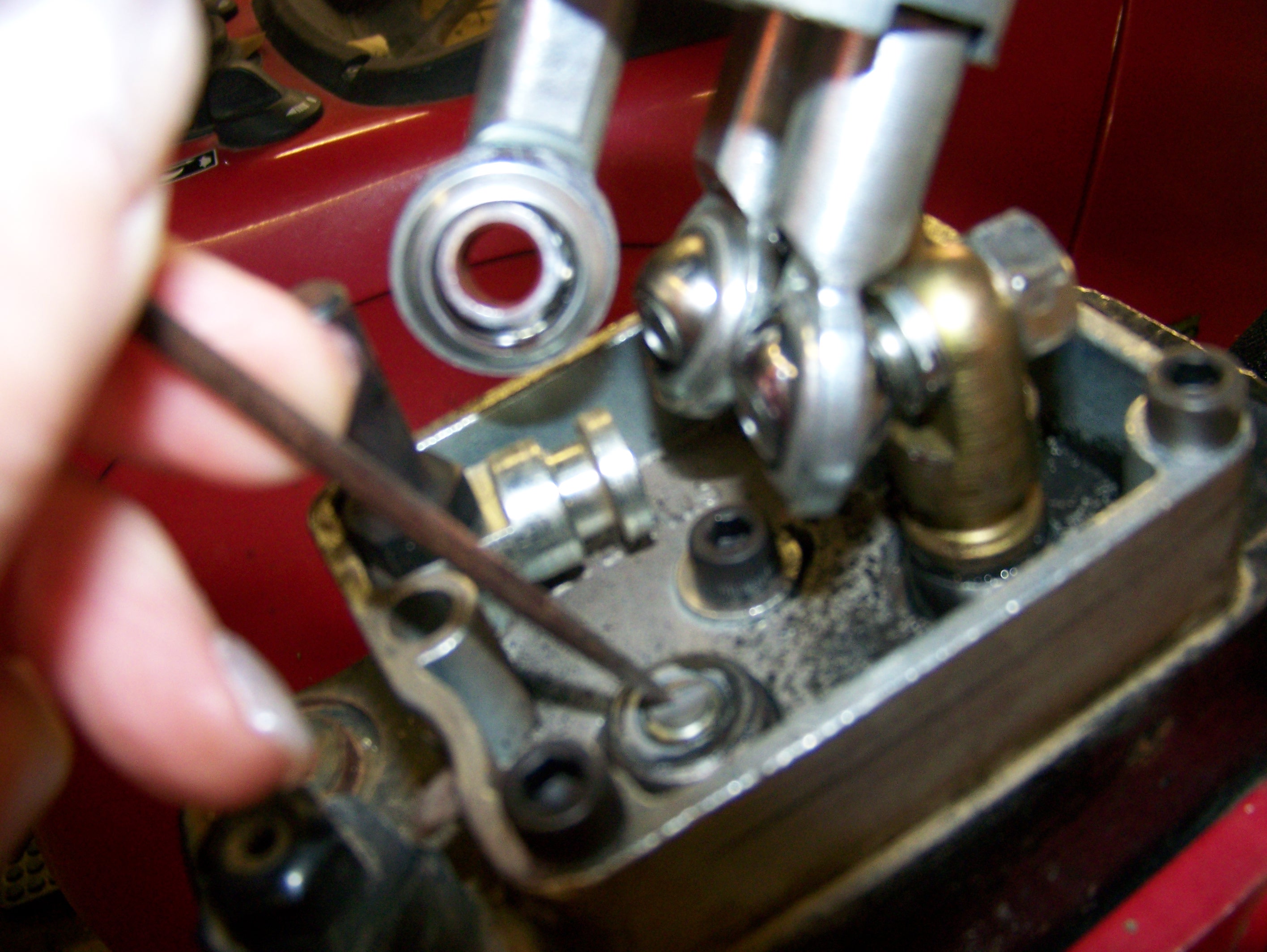

Last Sunday, I broke the threads off of my loader valve's "up" rod end adapter that threads into the spool. I thought it had came unscrewed, as it had before. I took the boot off to find it broken here......... 7-6-14 Loader Valve Spool Adapter Threads.jpg Yesterday morning I used a left handed 1/8th drill bit and spun the threads out.

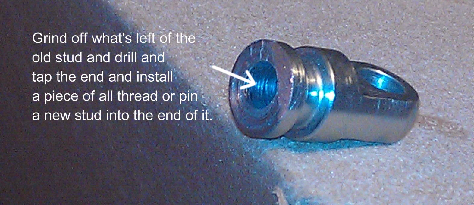

How did you connect the threaded rod to the existing linkage? Any photos?

Where the treaded stud broke off of the piece, I center punched, drilled and tapped the fitting. Effectively replacing the stud that broke off, and just screwed it back into the valve.
Tom
