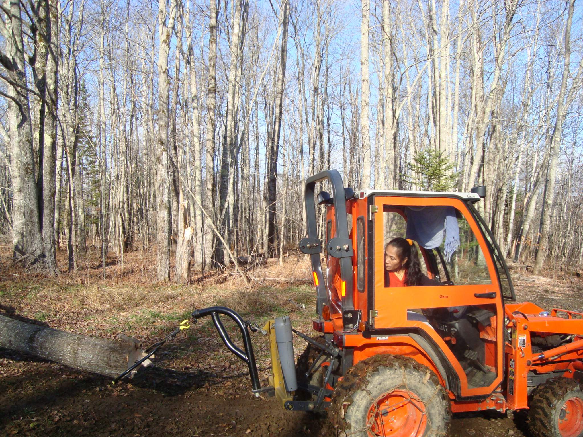

DSC06956.jpg One I built a while back and am just trying out,, and it worked great !!!

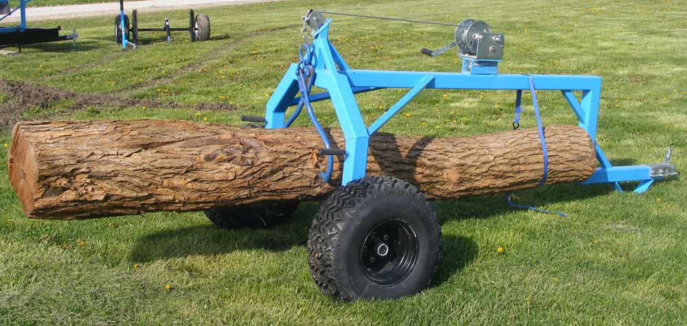

It requires a winch but I have an older version of this without the tongs, just a cable you wrap around the log.
