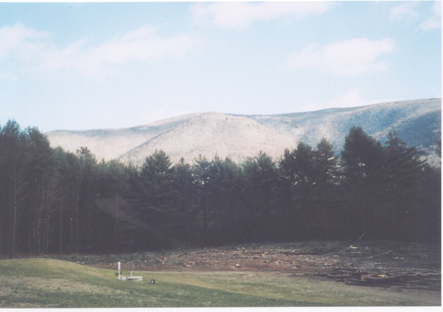

Take a look at this photo. Every time my wifes grandfather used come up to the property and see the mountain, he'd always talk about drawing logs down from there with horses years ago.
BTW, raining now but still above freezing./w3tcompact/icons/smile.gif

I bet that mountain range sure pretty w/the autumn leaves turning.
Like others I enjoy listen for hours of yesterday loggers and farmers when they tell there stories...and now where taking there place.
Looks like you have some fire wood to pick up from the clear cutting,also more area to mowe.
