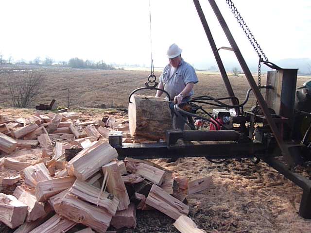

With that much of the H beam hanging past the axle how is your weight at the hitch on the tongue? When I built my horizontal/vertical splitter the rig ended up pretty light on the tongue.
Also, I'd like to suggest looking at making a boom lift rather than a log lift on the side of the splitter. I run mine with a 3000# winch and we are able to pick rounds up from any position around the splitter. Whereas if you have a log lift off to the side you are restricting yourself to working off one side of the splitter, plus you still have to roll or carry the rounds to the log lift. Plus you will be adding a lot more weight hanging off the back of the splitter.
Here are a couple of pictures of my boom lift in action.

I am all for the boom lift also. I built mine with a T knife. It doesn't split the block intwo. It just takes firewood size off the bottom of the block as you work it down. the main block stays complete. Just take a couple of pushes off the bottom, rotate with the tongs and finish it off. Having the hyd or elec winch sure saves on the back and like said above, you are able to grab from either side. My unit is likely overkill for most. I built it over 25yrs ago using the pto. Have since changed it to be self contained. faster and easier on the tractor.

The weight on the tongue will be fine. I have the hydraulic tank to mount, and can slide it forward, if need be. In the picture there is plenty of tongue weight, it's an optical illusion because it looked that way to me too.
With the FEL and grapple it's no problem bringing logs to the log-lift side of the splitter. The booms and winches are great, just not for me, on this project.
