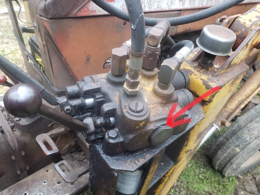

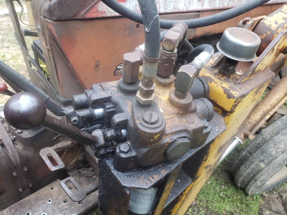

I have a MF 165 with a FEL which runs off a pump on the front of the tractor. I've been running a 3pt log splitter off the auxiliary hydraulics, but the gpm is bare minimum for the splitter, painfully slow. I'd like to tap into the hydraulics for the loader. What is the most affordable option? I've heard of using a diverter valve and or power beyond off my loader spool, but need some guidance. I'm going to try to attach a picture of the spool, I think the plugged spot may be a power beyond port? Any ideas would be appreciated, thanks

Yes, the plugged spot is for changing that Gresen SP valve from open center, closed center or power beyond. The correct plug you will need will be longer with a seal at the bottom and a hole straight thru and threaded for a port connection to go to the next valve inline. 4013B2B8-11F6-499A-8A81-7F8432400BE6.jpeg

Yes, the plugged spot is for changing that Gresen SP valve from open center, closed center or power beyond. The correct plug you will need will be longer with a seal at the bottom and a hole straight thru and threaded for a port connection to go to the next valve inline. View attachment 672022
Sort of same thoughts about adding power beyond for splitter.... But not enough experience to make definitive statement....

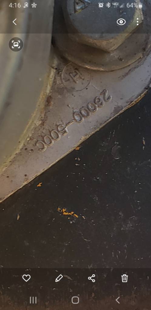

I'm not sure of the flow rate of the pump. I can't find the info that matches exactly. It's an Eaton 26000-500C, I'll attach pic, and the splitter requires 6-25 gpm at 1500-2500 psi, thanks for all replies Screenshot_20201005-161603_Gallery.jpeg

I suspect that pump number is a casting number. Are there any numbers stamped on the housing anywhere? Eaton 26000 series covers a broad range of displacements.
Tractor isn't home now, probably won't be able to check until this weekend

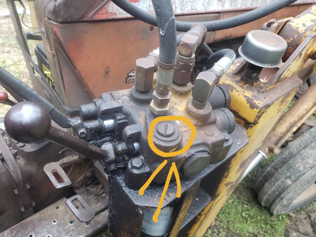

Is this where that might hook up? If not does anyone know what this would be for? Thanks everyone for your time. 20201006_071928.jpeg
   / log splitter off FEL pump #20
This is the curl side, I wonder if I could tap in here?View attachment 672135
If I was to guess that may be a pressure relief setting.
I would remove the curl line add a quick connect female to the valve body and a male to the existing curl line and the splitter pressure line,
the curl function would not work while the splitter was being used.
