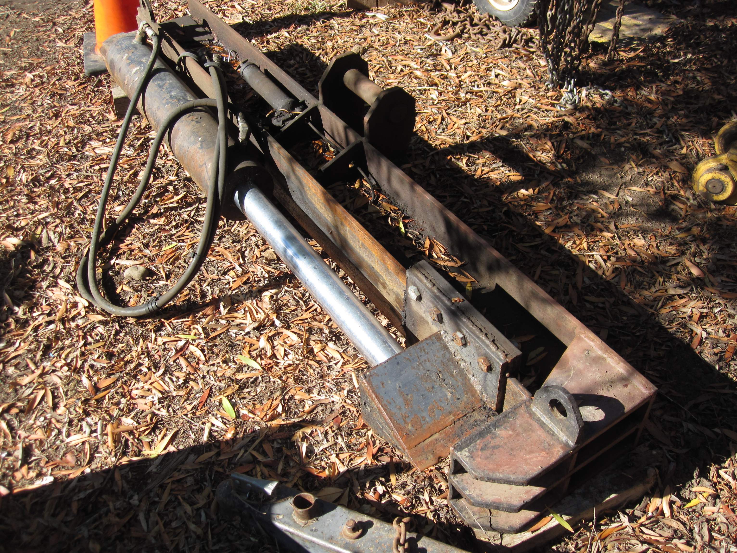

   / log splitter wedge design #27

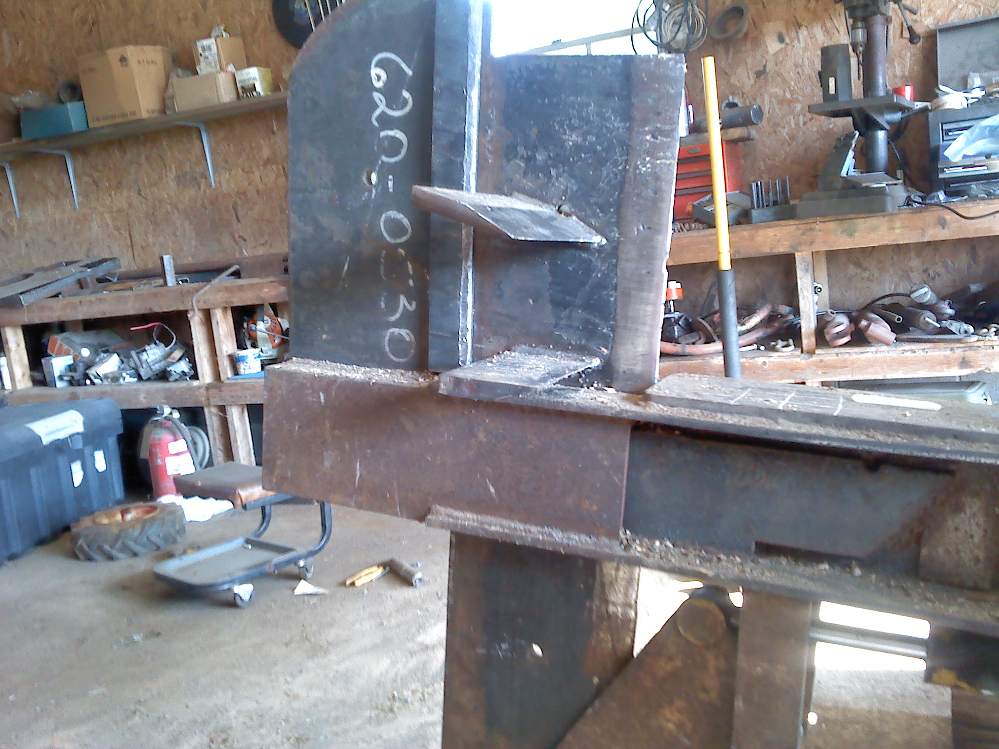

along the same line as Wille B is talking about, when I built mine I added angle to assist the split and it requires less ram travel to get the job done most of the time.

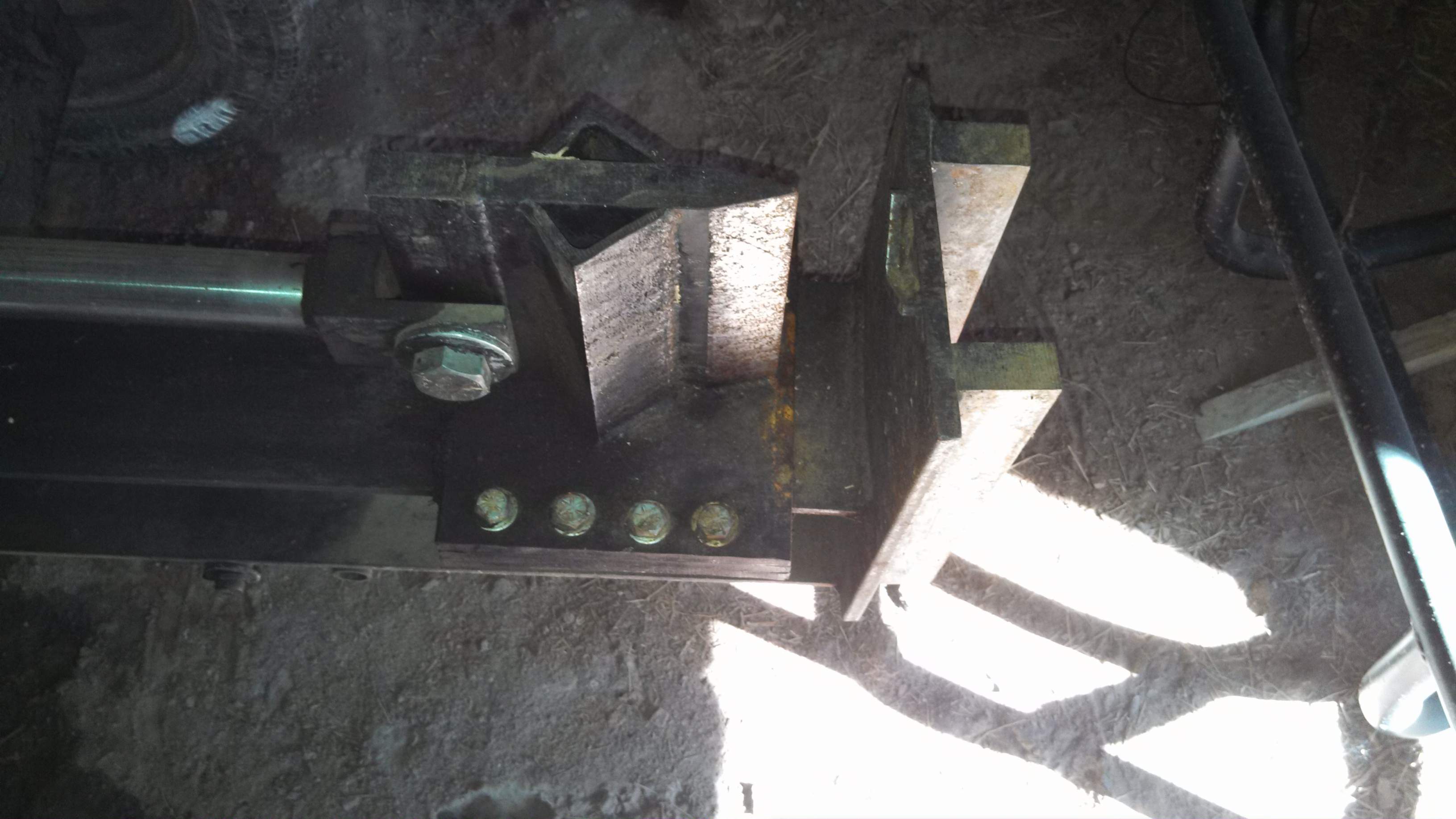

   / log splitter wedge design #28

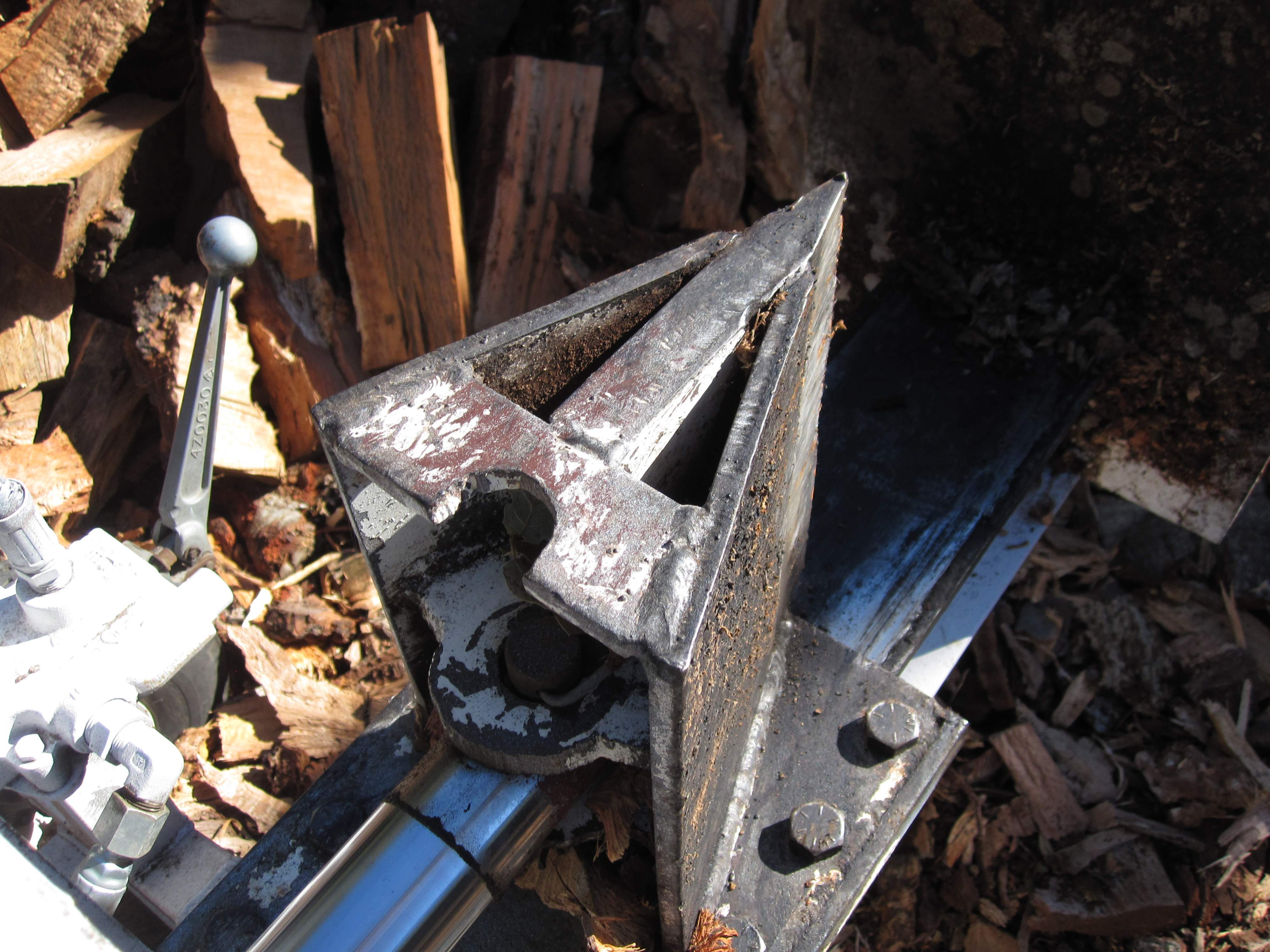

Experimented with a few designs,
My best luck has been welding "wings" onto wedge at about the same angle as wedge (see photo) with a bit of a transition to wider.
I use a Northern Tool "weldable" 10"
Keep the wedge sharp, seem to reduce energy required to penetrate wood also cuts thru knots.
I split alot of varieties of wood, big nasty knotty stuff as well, seems to work

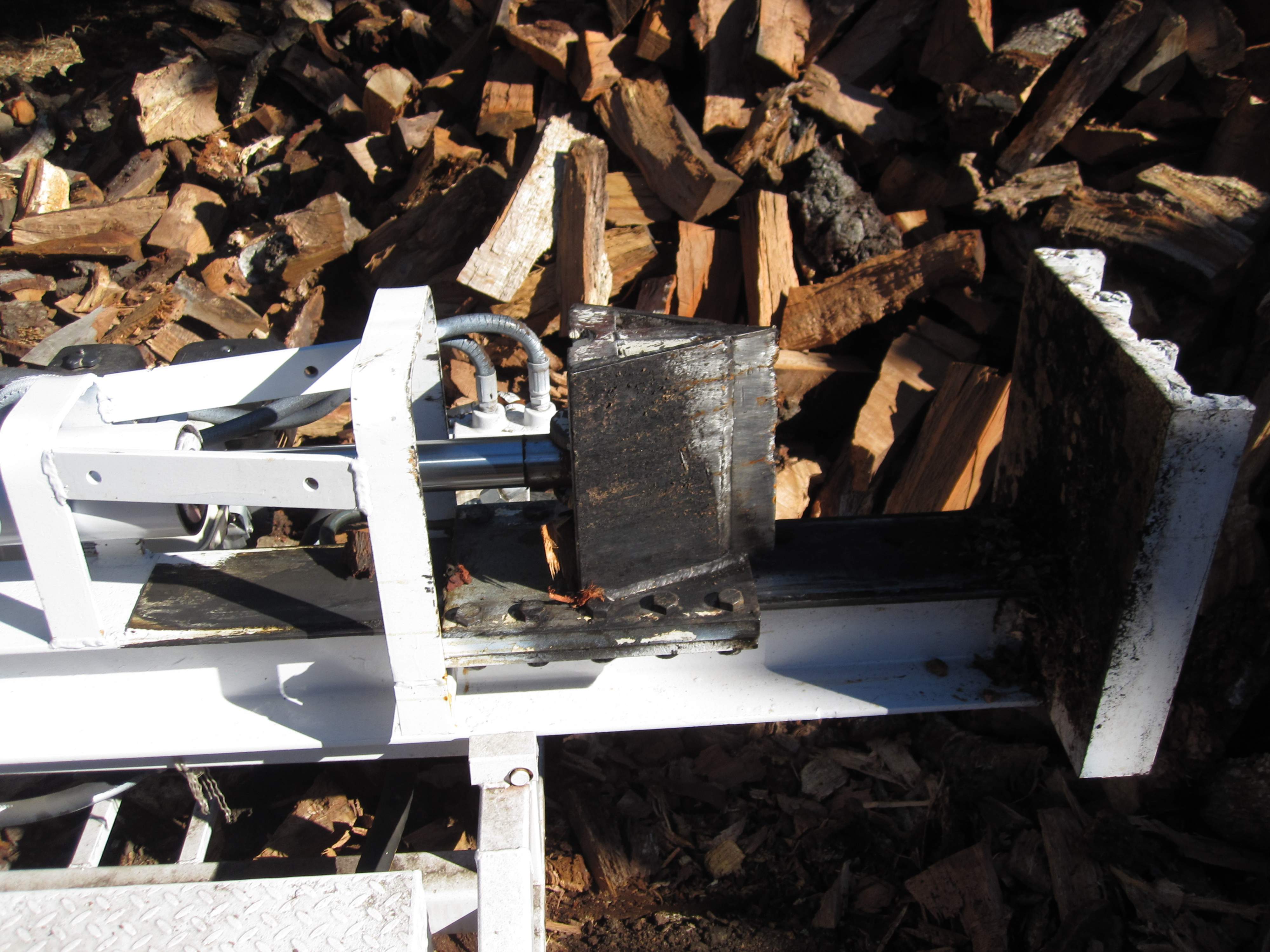

   / log splitter wedge design #29

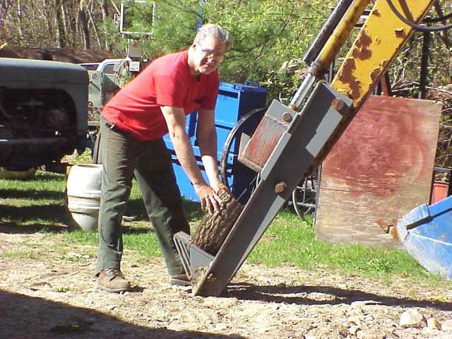

"stripper" design
This was kind of an afterthought after continually hurting myself trying to beat stuck pieces off the wedge
Another shot of "big bertha" backhoe mounted splitter beam with 6" ram.
the wedge has seen some serious duty at 70 tons, still holding up.

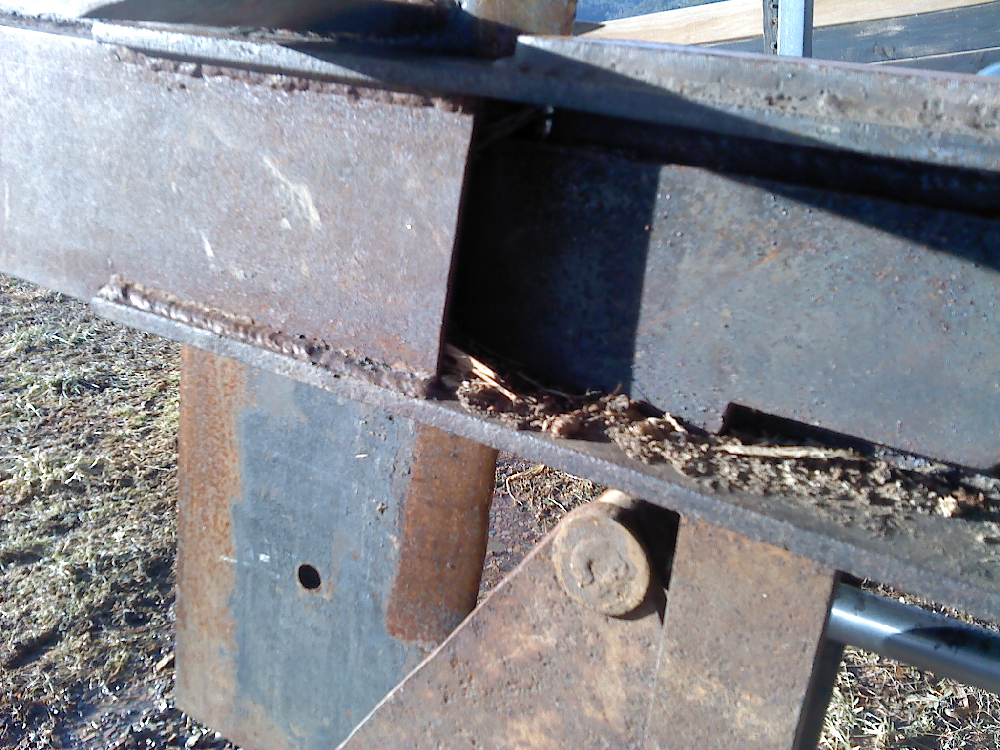

   / log splitter wedge design #30

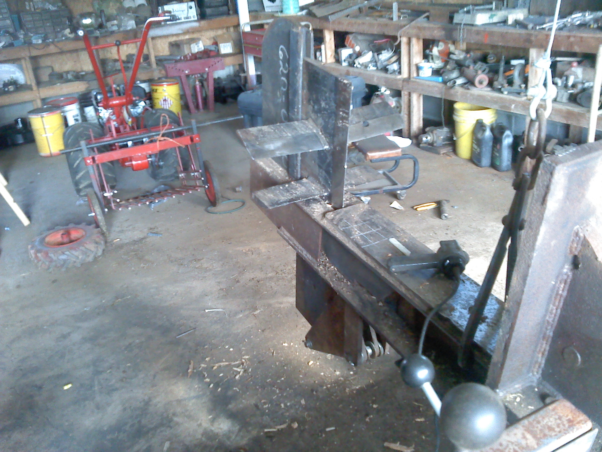

Old thread, but,
My wedge is 24in tall with wings to make a 6way split. The whole blade is adjustable up and down. I used 3/4in plate to make a back support for the adjustable splitting wedge. I used 3/4in flat plate that I hard surfaced the cutting edge before sharpening for the wedge. I used a 2 1/2in long taper for starting the splitting action. My wings are located just behind the long taper edge. The bottom wing is just sharpened on the bottom side of the wing, and the top wing is just sharpened on the top edge. The bottom wing is angle down in the back and the top wing angled up at the back. The prevents the center splits from binding on the wedge. I do not use any kind of spreader wings on my blades, I find spreader wedges takes a lot more tonnage to do the same job as a single narrow blade, altho for easy splitting the spreader wedges will split a little faster. I use a 5in bore cylinder and 2500psi to split 30in + dia oaks and hickory and dont have any problems splitting 6 ways at a split. My biggest problem with the 6way wedge is the center splits are usually to large and need to be re-split if I am splitting large dia wood. A 24 in round will yield 2-5"x12" splits. My future plans are to add two more wedges to make it an 8way too handle those large center splits off the 6way.

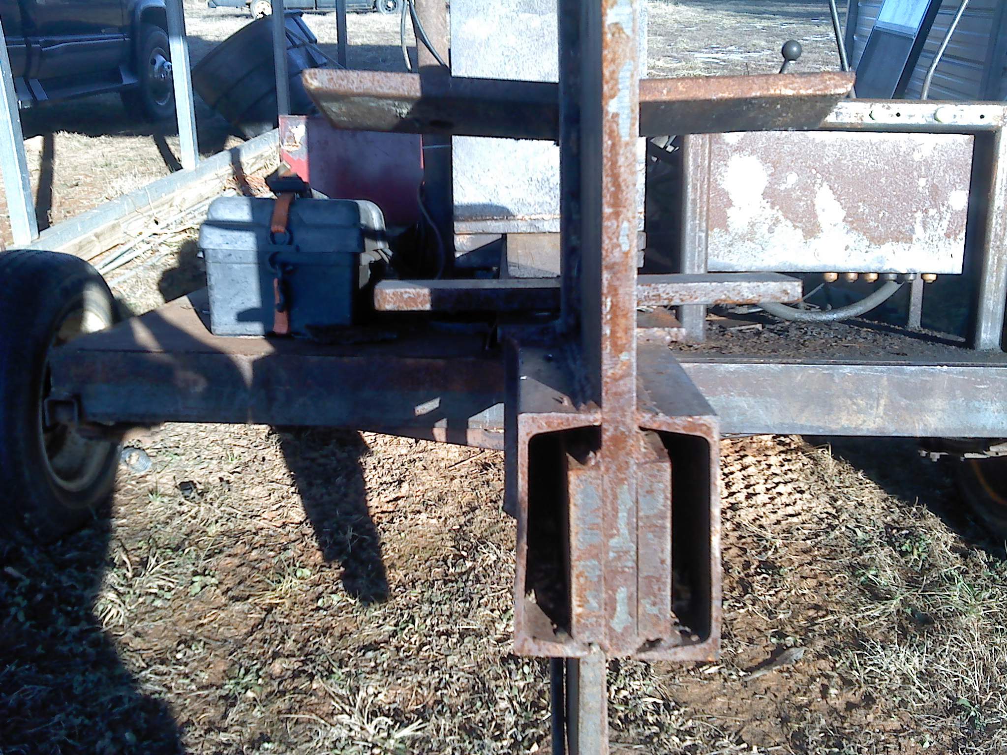

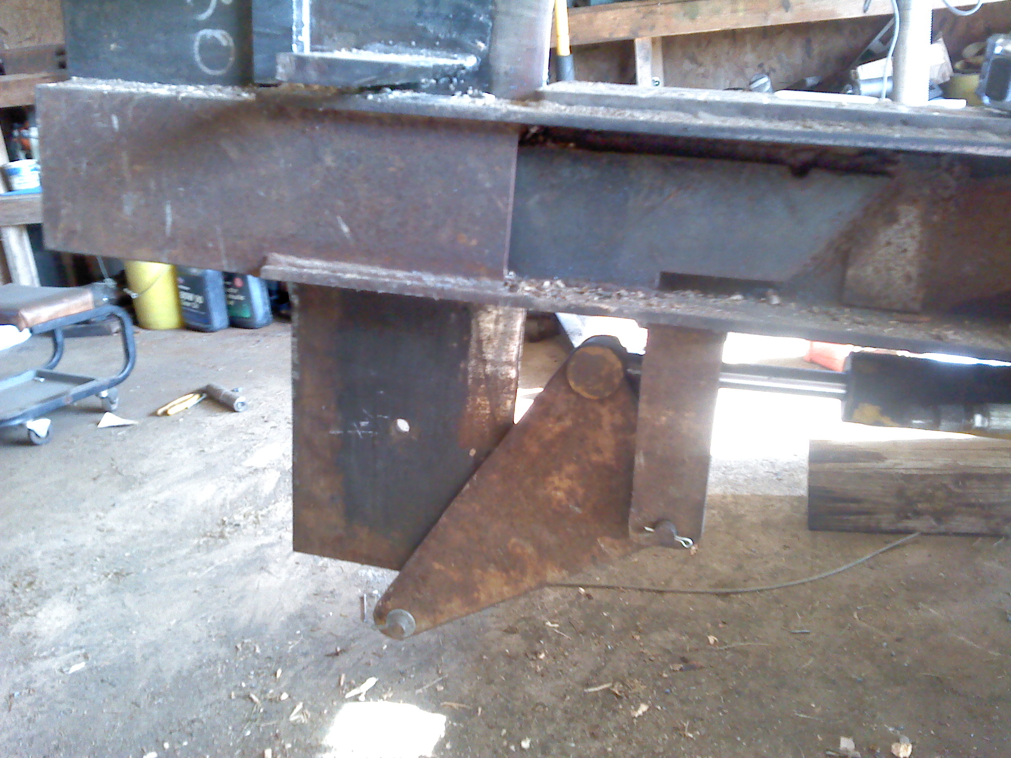

   / log splitter wedge design #33

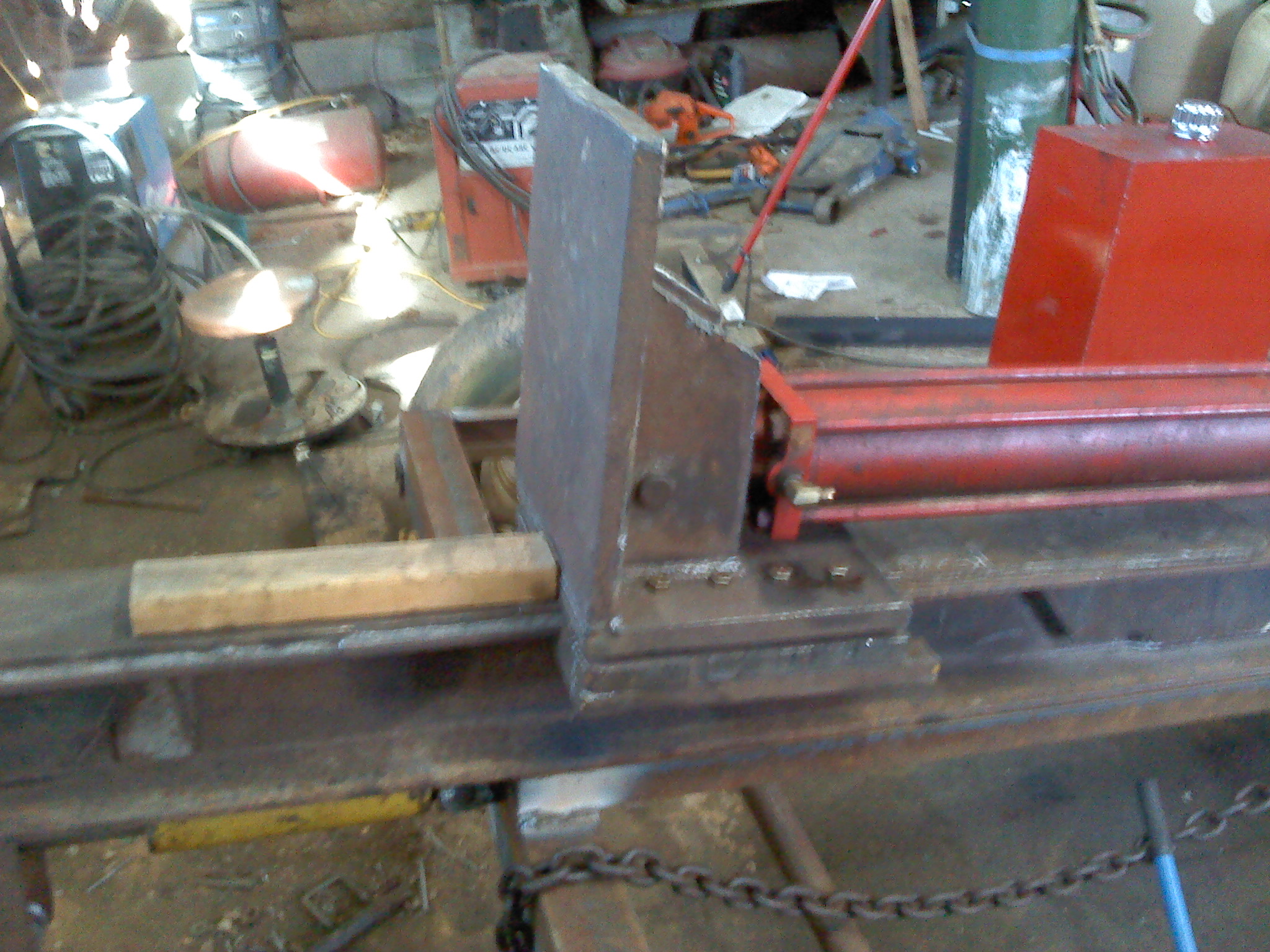

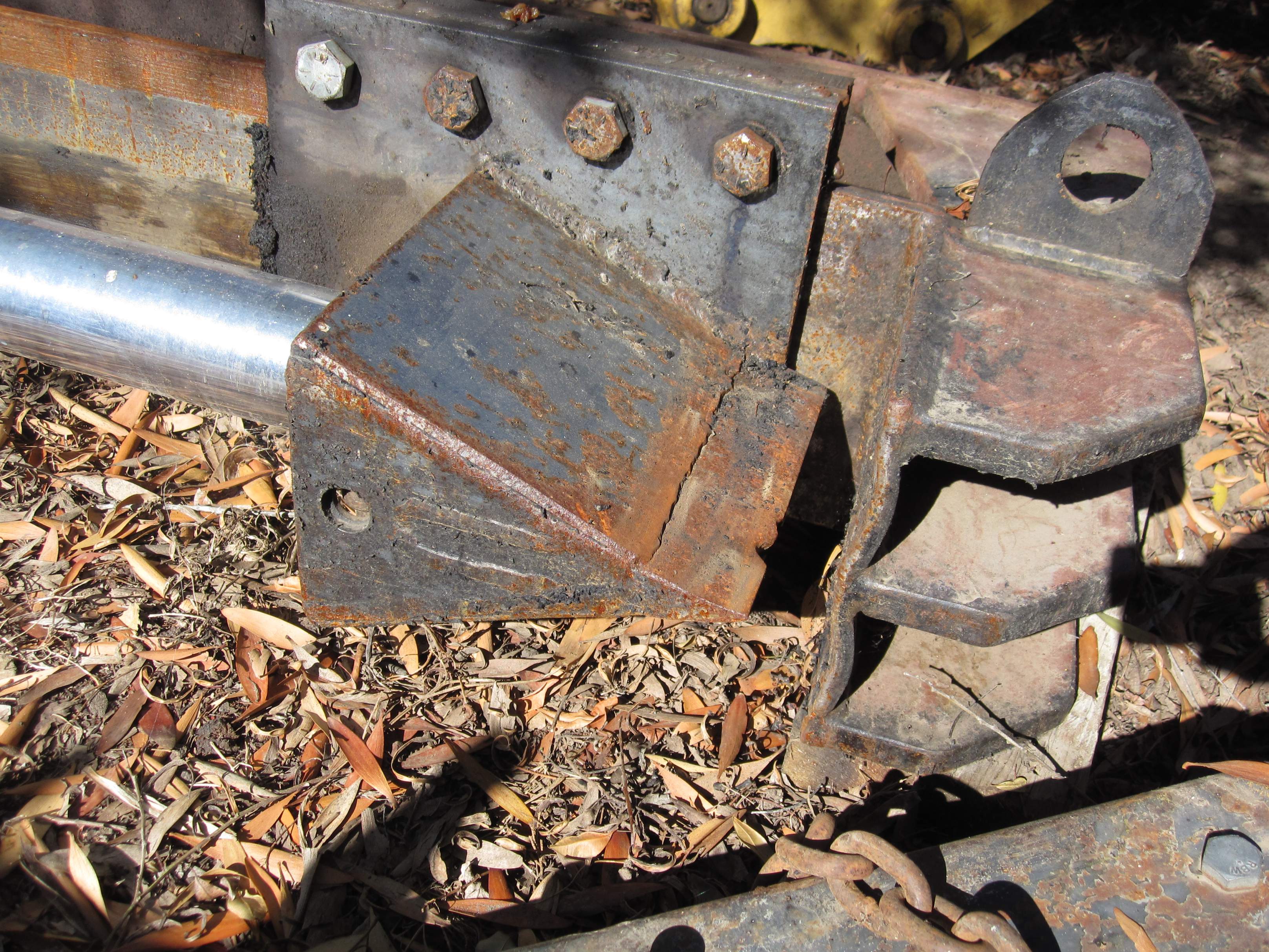

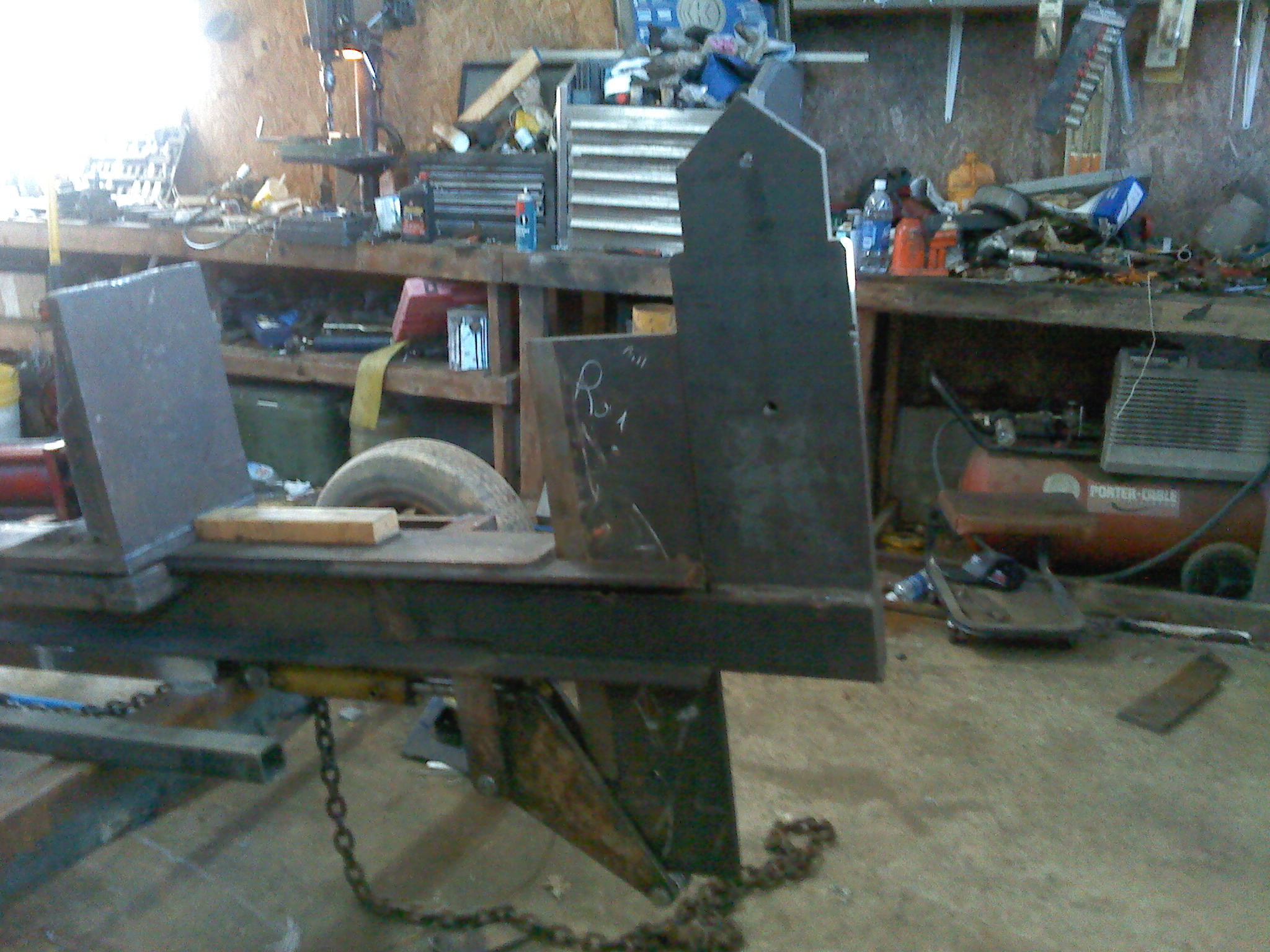

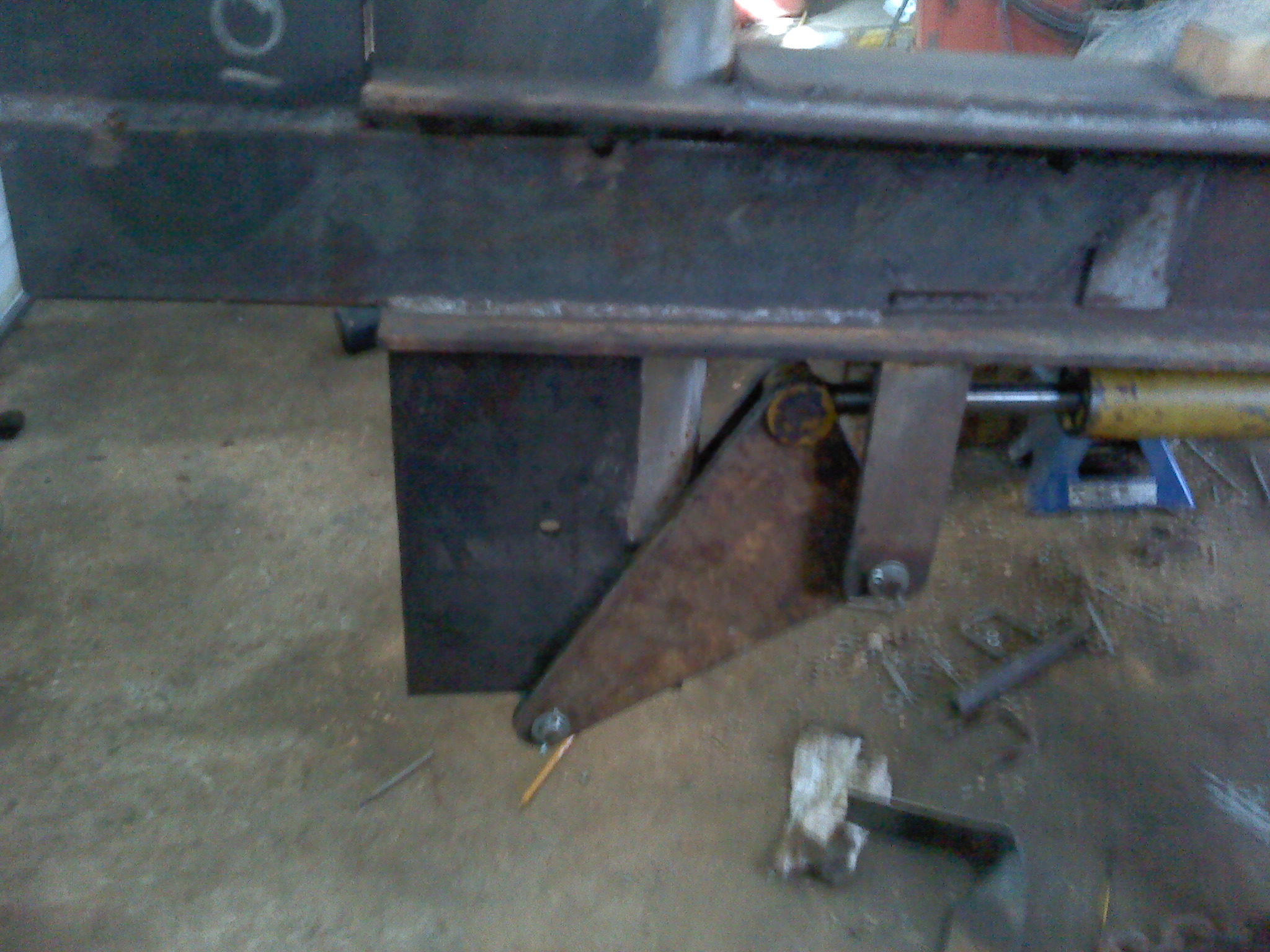

Darren Pm'ed me and asked for more pics of my wedge. These pics are posted on here somewhere, but I am going to go ahead and repost them here since thats probably easier than me searching all over for them. These pics are before i added the 6way, I will upload some pics later once i get them uploaded.
edited to add more pics, Darren, I hope this answered your questions
