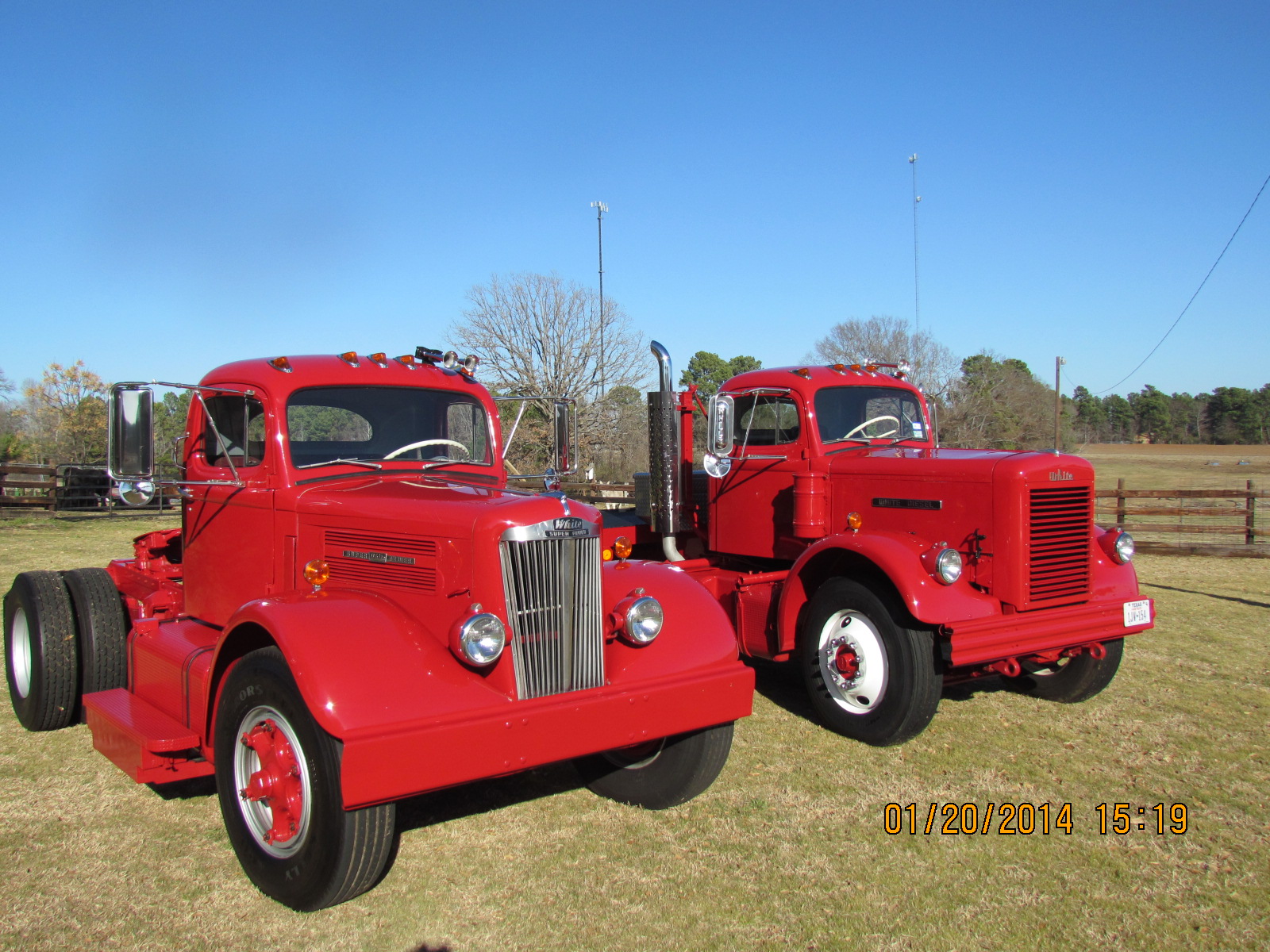

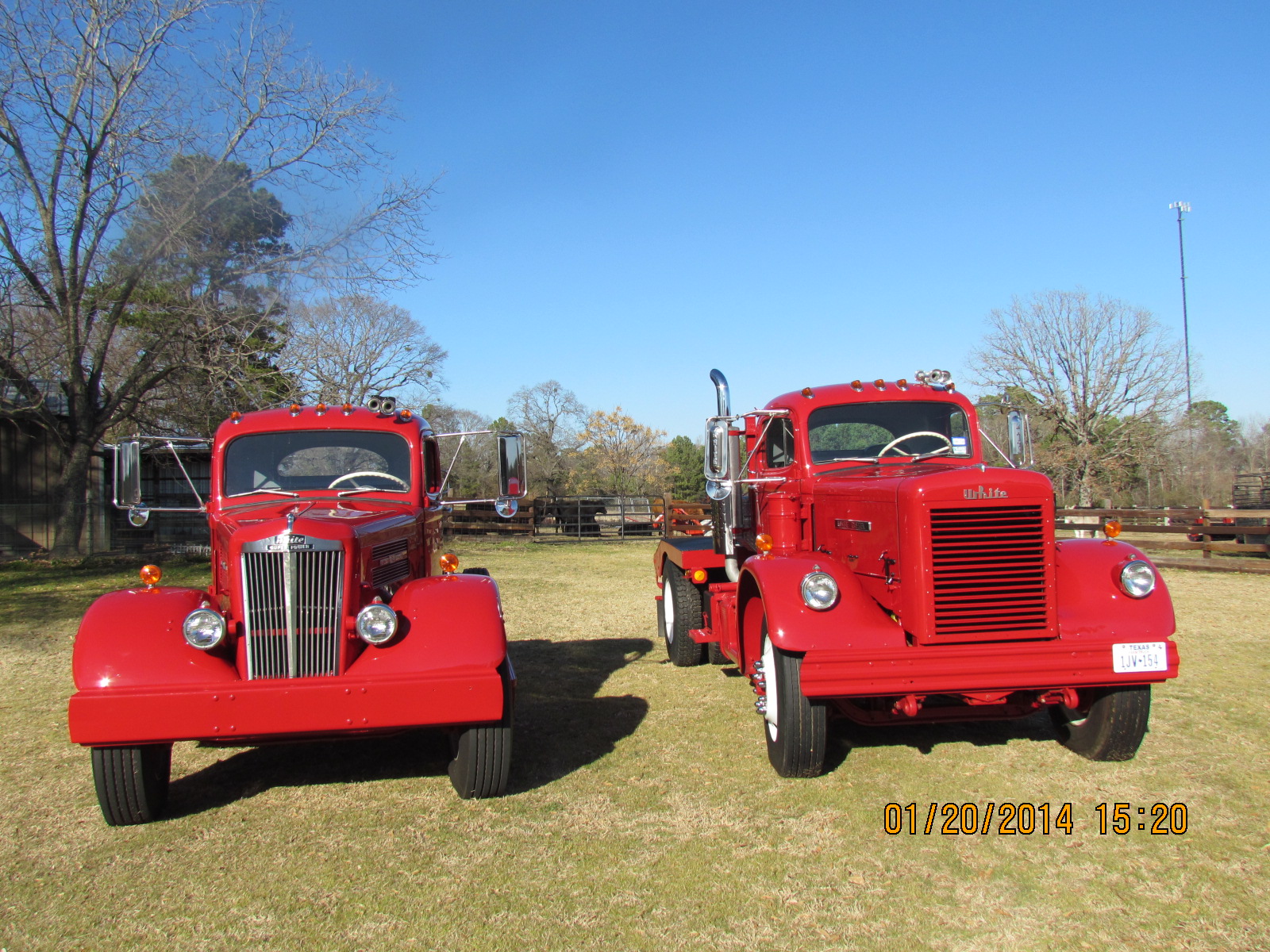

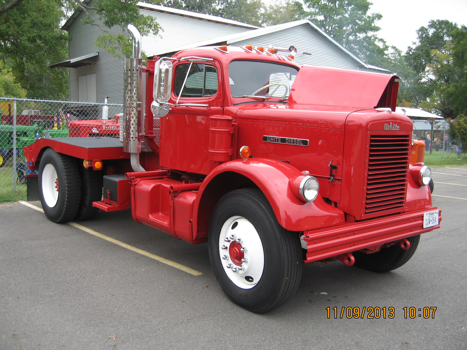

My '56 White WC22 has an Eaton electric shift two speed rear axle. I've never driven it under load but driving it empty takes some getting used to because the Clark 5 speed OD trans is not synchronized. The two speed axle works great. This truck has a flathead 6 cylinder 145 hp White Mustang engine. My '59 White 4400TD originally had a ten speed Fuller Road Ranger trans but I changed it out for an Eaton 13 speed trans. The '59 has a 220 Cummins in it.
You have to remember these veteran trucks were built when the truck speed limit usually was 45-50 mph. They are geared for slower speeds and don't have the power for high speed rear ends unless you're running empty.
