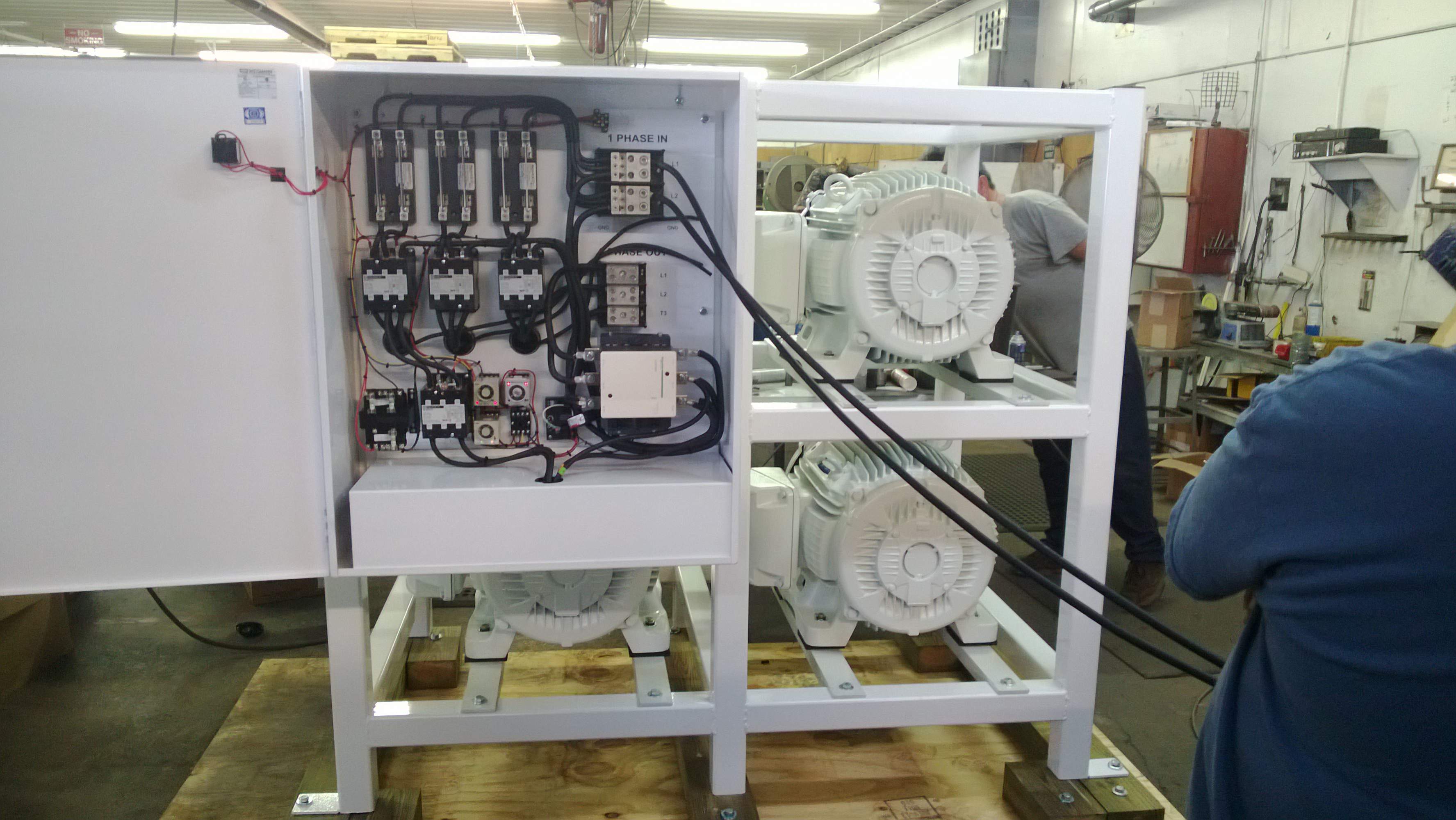

As an aside, heres a 3 motor 150hp converter built for the local power company. Should here it soft start - sounds like a jet spooling up :)

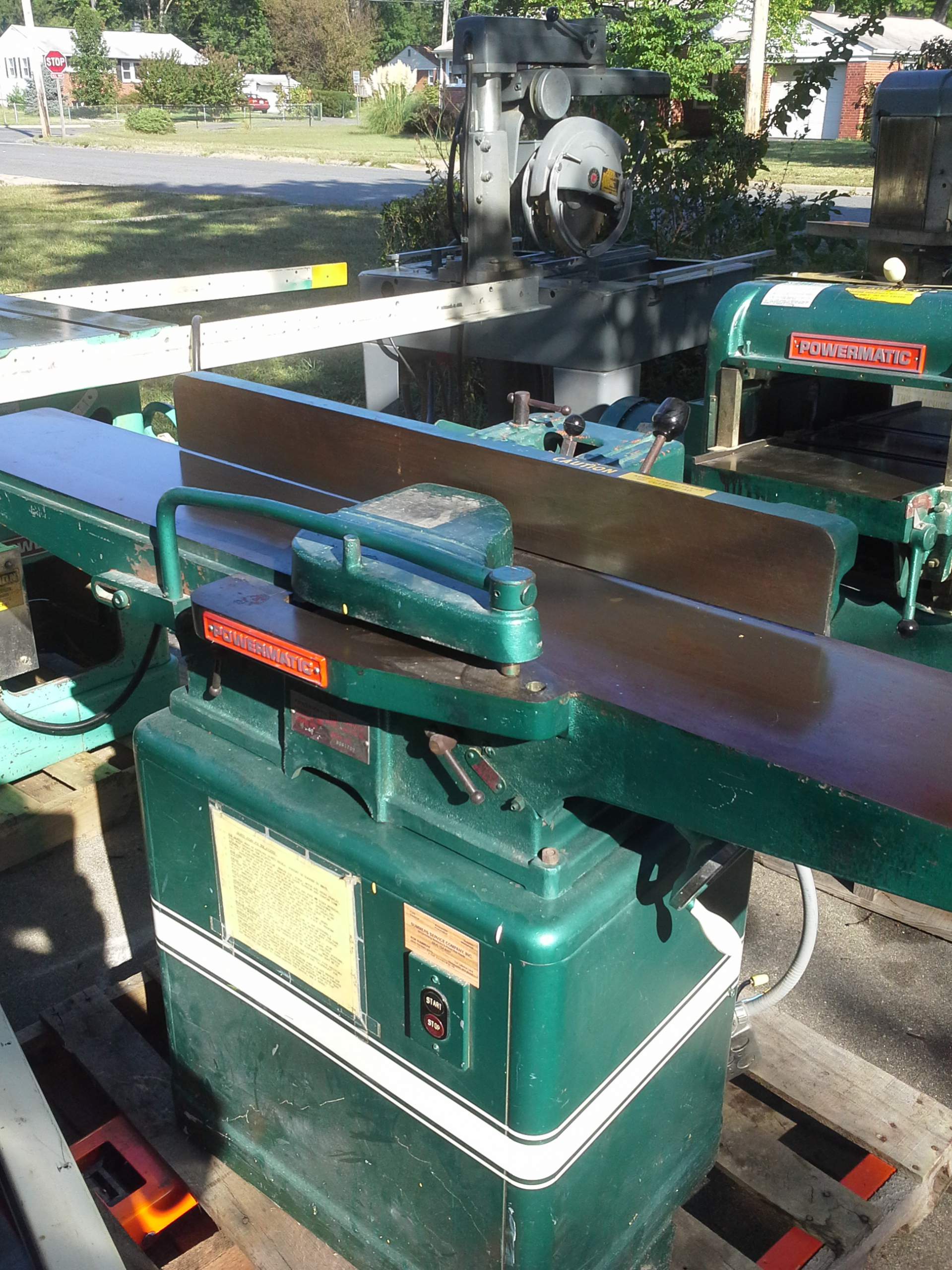

I had planned on getting a 7.5 to 10HP RPC, however prices for a new one range from about $700 to several thousand. From my reading it may be possible to "gang" or run them in serial such that if they are the right type I could get a 7.5hp and later a 5hp and be able to use about 12hp of that.
There is also a lot written about DIY phase converters.
I started this thread asking for online links, I've sat thru many YouTube videos where the guys talk for 10 minutes and don't tell anything about how they built theirs.
So do y'all have any cache of bookmarks?
/edit - I found this one site Rotary Phase Converter selling 10HP for about $700 and kits for less. It actually looks like with a $100 Kit and a $200 (or less) motor I could have a 10HP phase converter.

My thought was if you can score all that machinery, one should be able to find a used 10 HP three phase motor and pick up a static starter (phase converter), and like said above you have a rotary converter.
Ii started out with a static converter on my mill, then went to a surplus rotary converter and now have open like delta three phase, (only takes two transformers to make form of three phase and also it is on 240 instead of 208 so all single phase is not effected.

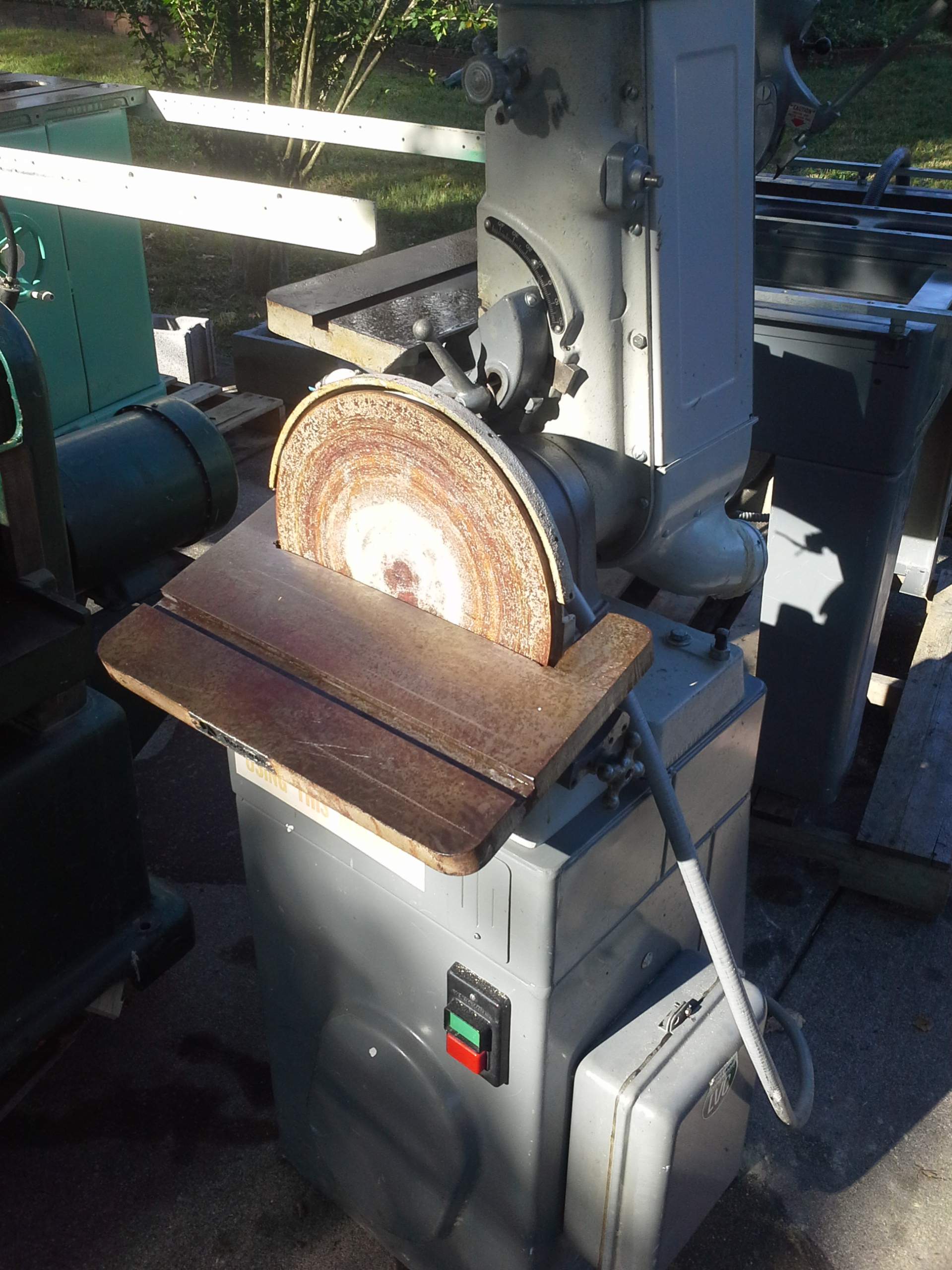

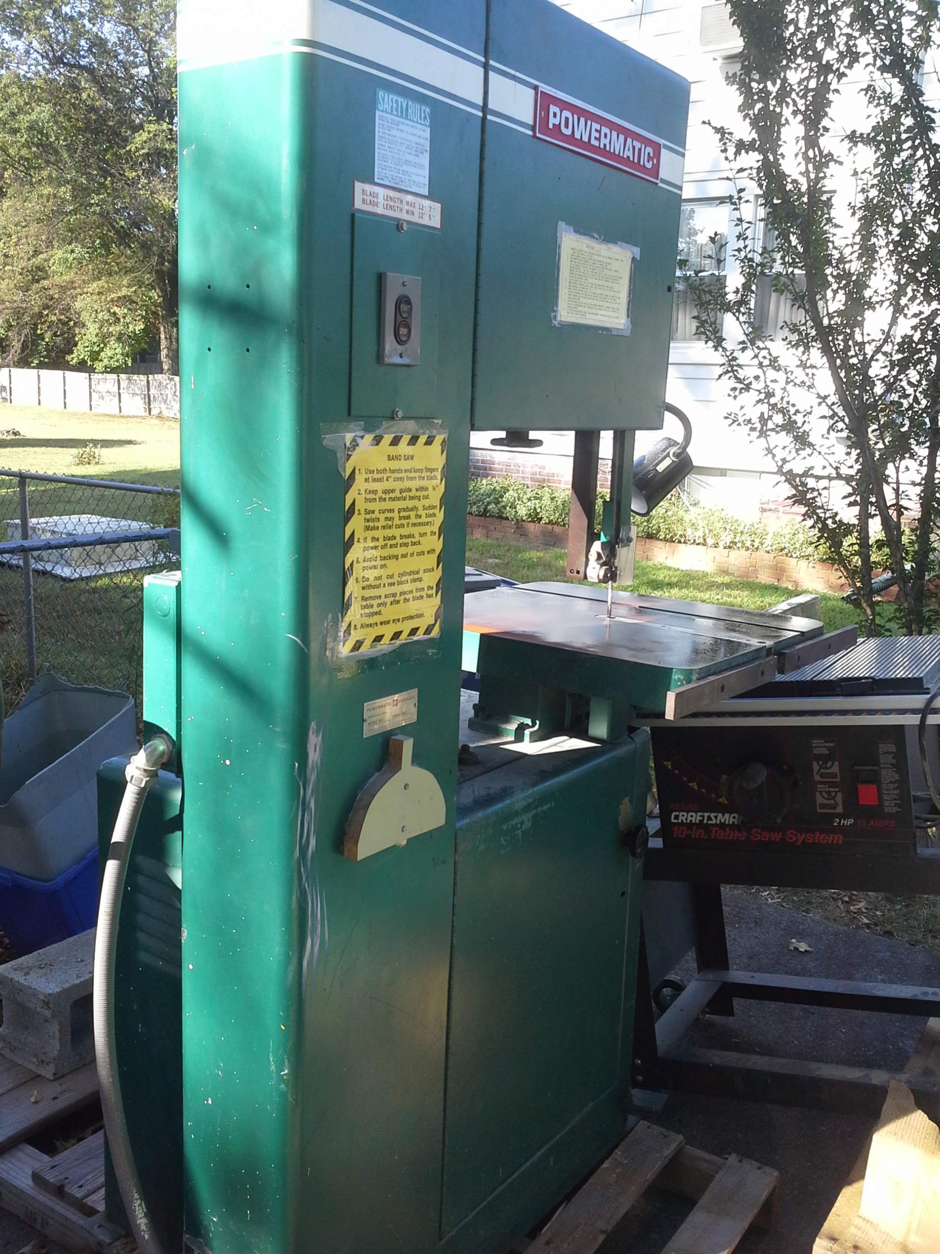

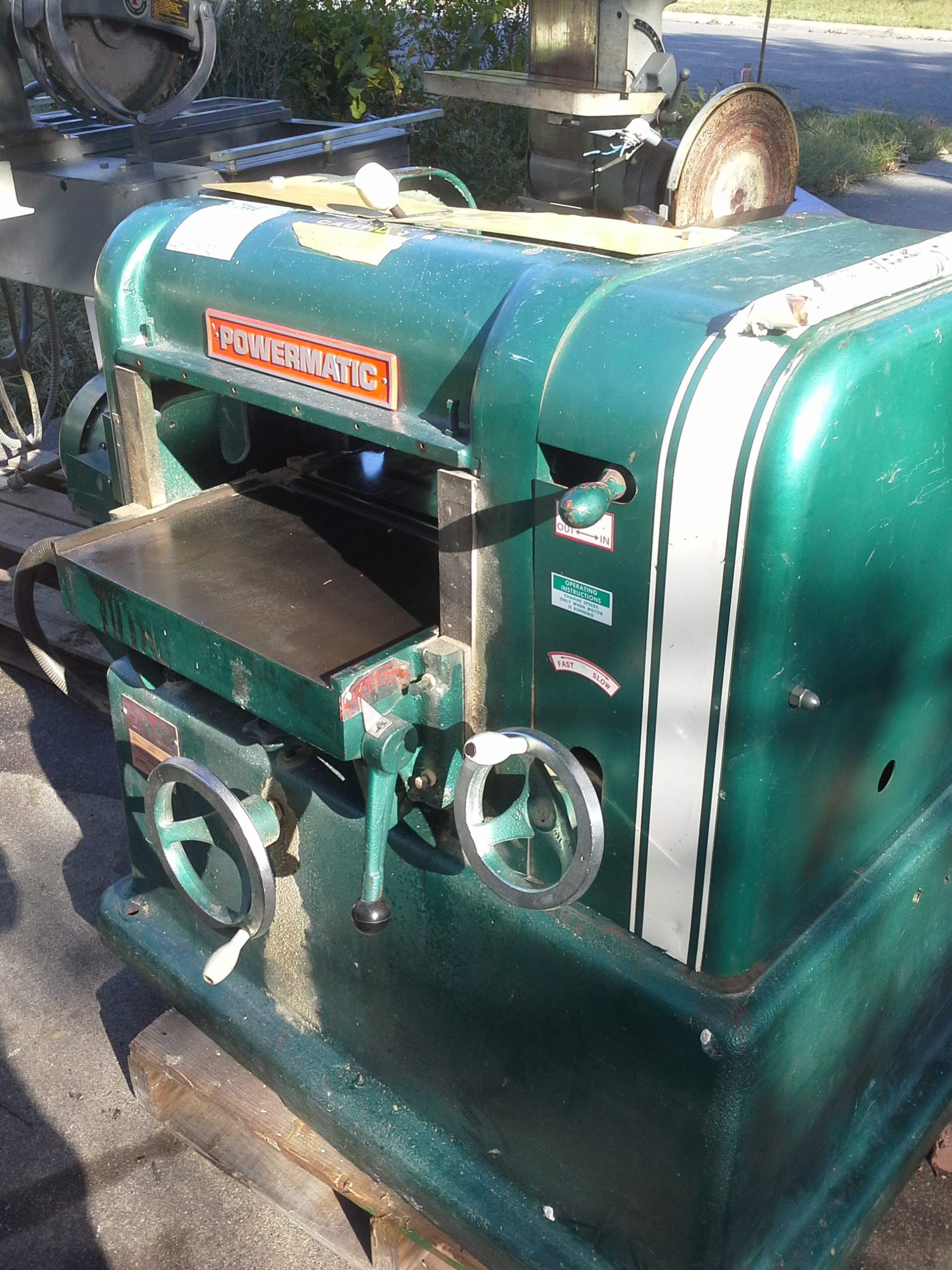

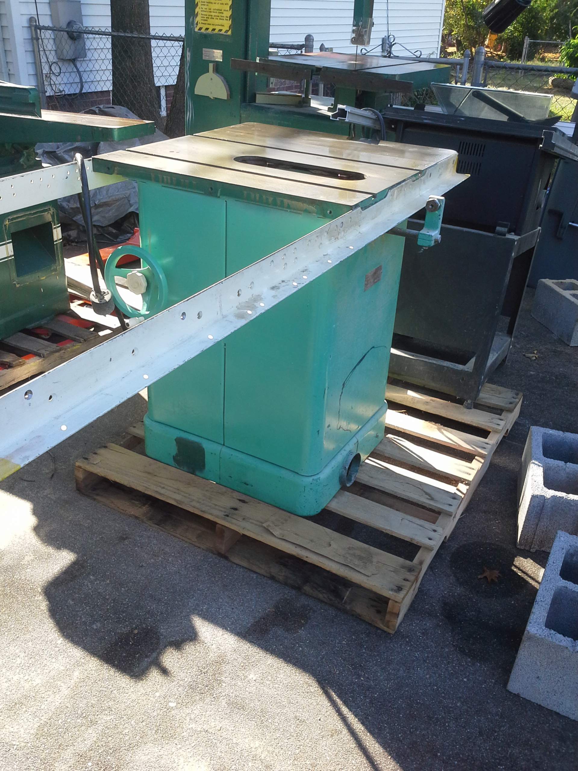

In this case it's buying $900 worth of machinery and not wanting to spend $1000 on it.

Thanks! That was the type link I was asking for, VERY informative.
I'm looking for a motor now :)

PM is a good site overall, but the owner is a real pr!ck, IMHO. There is lots of good info there on VFDs and phase converters. Also Homeshopmachinist.net is another great forum without the attitude you get from PM. There is lots of good 3phase/VFD info on HSM also, so those are great sources, but the limit is that 3phase metal machines are not really the same as WW machines. Many WW machines are much higher hp than common metal machines and can often require heavy starting loads. Not so true of a simple Bridgeport or small engine lathe, so you need to keep that in mind. This is why you see VFDs pushed more on the machinist forums than in WW ones - they are very cost effective for a single lower power item like a mill, and have other advantages liek reversing. Few of these things apply to WW tools. Your planer will be the one that drives this, as you already know. As you also know, these are not sensitive electronics. They are simple induction motors. So as long as they get sufficient voltage and power, they will run fine. There will be some losses from even a rotary phase converter, so you will take a hit, but unless you have run them on real 3 phase you probably won't be able to tell. Once you start your large load, the other loads should be able to run at the same time also as the one load helps the system out a bit with capacity. In a 1-man shop, it is rare to use more than 2 tools at a time, so this is probably moot. Something like a 10hp rotary would seem to be perfect for you, unless you think you will get higher HP stuff in the future. I would also just set yourself up a subpanel for this. Feed the rotary from your panel and then feed a subpanel from that so you can run the 3 phase where you need it and add circuits as required. Of course the subpanel needs to be a 3 phase panel.
You already found the WNY source, which is a decent one. Here is an old resource on making your own rotary with a lot of explanation. This was originally posted in the mid-late 90's, so it was the early days of the web. I am amazed to see it still up...
phaseconverter
And of course if your tools run backwards, just swap any 2 wires and you should be running the right way. This is also where a subpanel can be really helpful.
Hope this helps
AHHH!! Now I see.. if I got all that for $900, i'd be doing the same :) Good job finding that deal!

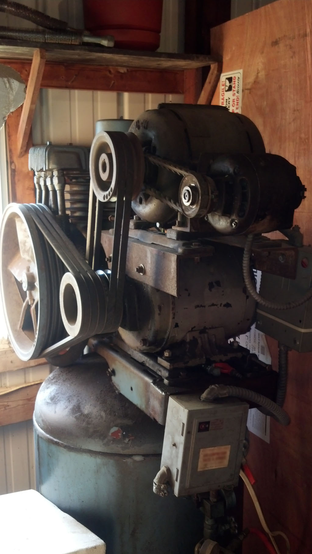

Almost 40 years ago I built a phase converter for this air compressor. Back then there was no Internet and I had to go to the library to read up on motors to figure out how to do it. Originally it ran off a 5 HP, three phase motor. I did not have the original motor but I got a hold of two 3 HP, three phase motors which I belted together to run the compressor. The small motor hanging off the top motor is a split phase motor. It just goes along for the ride so I could use the centrifical switch in it to switch out the starting capacitor. It has an adjustable pulley so I could tweak the switch RPM. Originally I passed all the starting current through the centrifical switch. It ran for severally years before frying the switch contacts. Eventually, I added a relay so the switch only controls the relay coil and it is still running today.

dude! that thing rocks!

Stonehaller, is that a Kellogg 352 compressor?
Well doggonit, you made me go out and climb over it to wipe off the label and check. You're close. Its a Kellogg 331.
