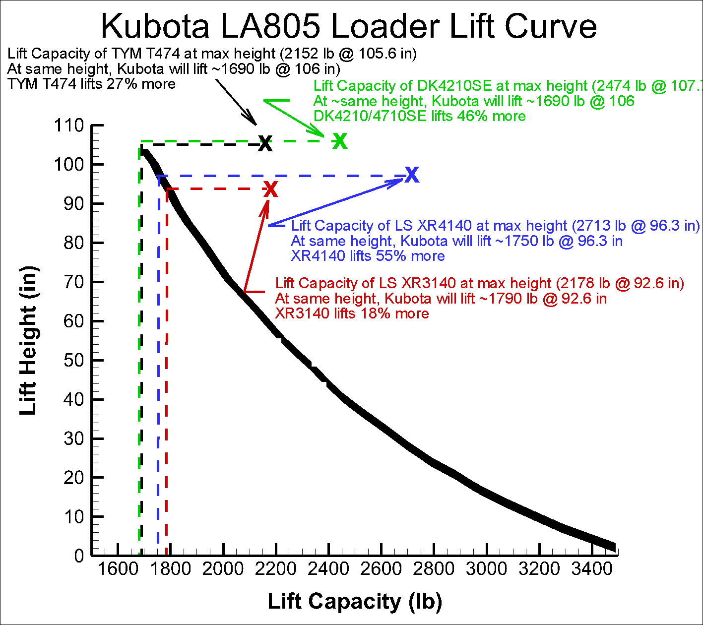

No matter, the loader will still have a curve where lift force varies with height. Those curves need to be compared, not single numbers that manufacturers are quoting at different heights. The curves will take all factors into account including geometry and hydraulics.
Sure. All loaders have an operating curve. It's the only way to compare.
Here is the curves and some scribbles for Kubota's 1350 loader standard on the M59.
It's a 60 hp 8000 lb machine built to lift and dig.
What is interesting is that after all the scribbles and some notes, it turns out that this loader and this bucket combine to lift a heaping full bucket full of mostly dry dirt to max height with a little lift and stability in reserve. No extra counterweight, no revving the engine ... it just does that much work in normal stock configuration.
So you can load a dump truck from the side.
I wonder if lifting a bucket load of dirt to max height safely would make a good target spec for a standard loader design?
