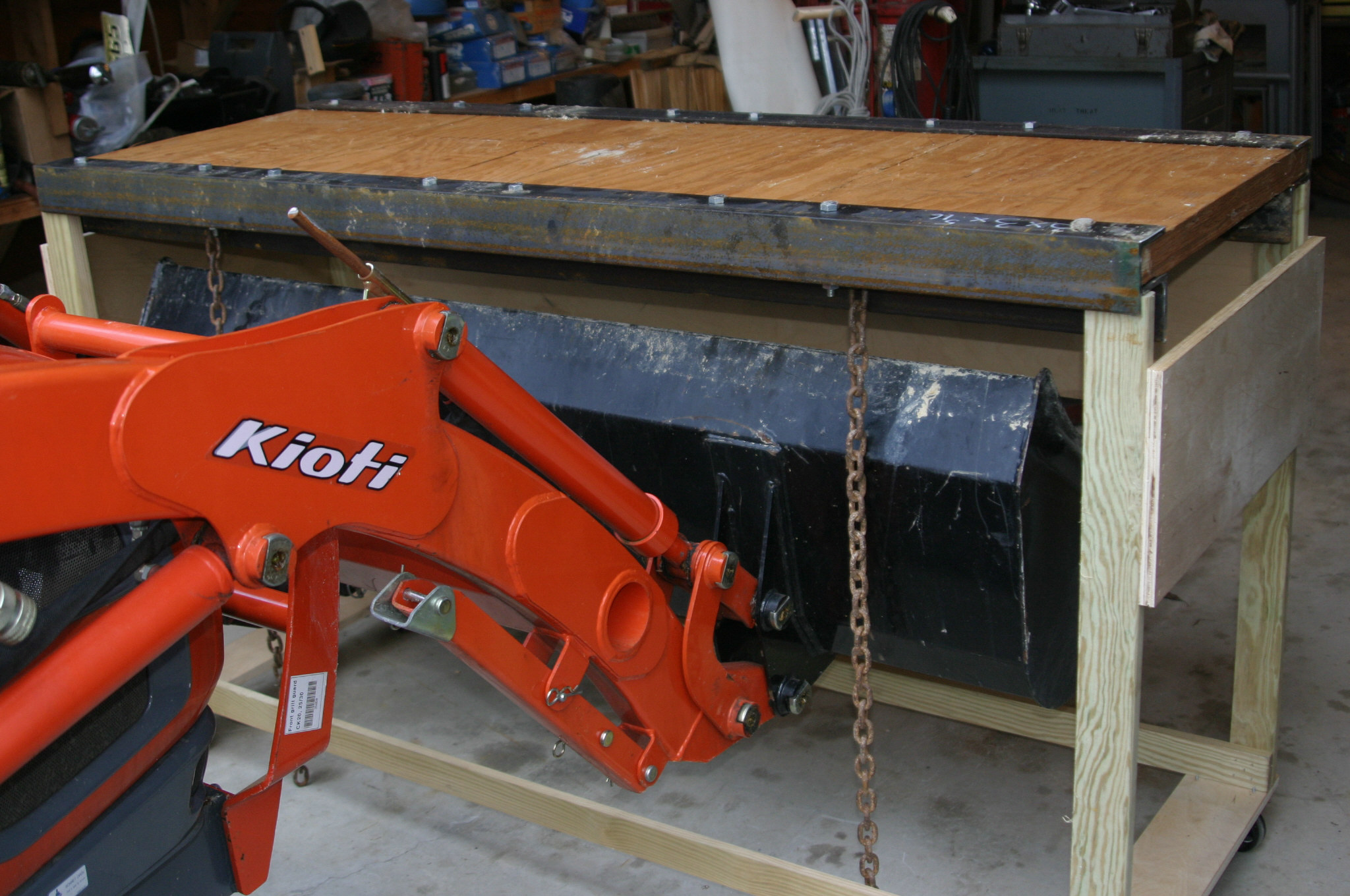

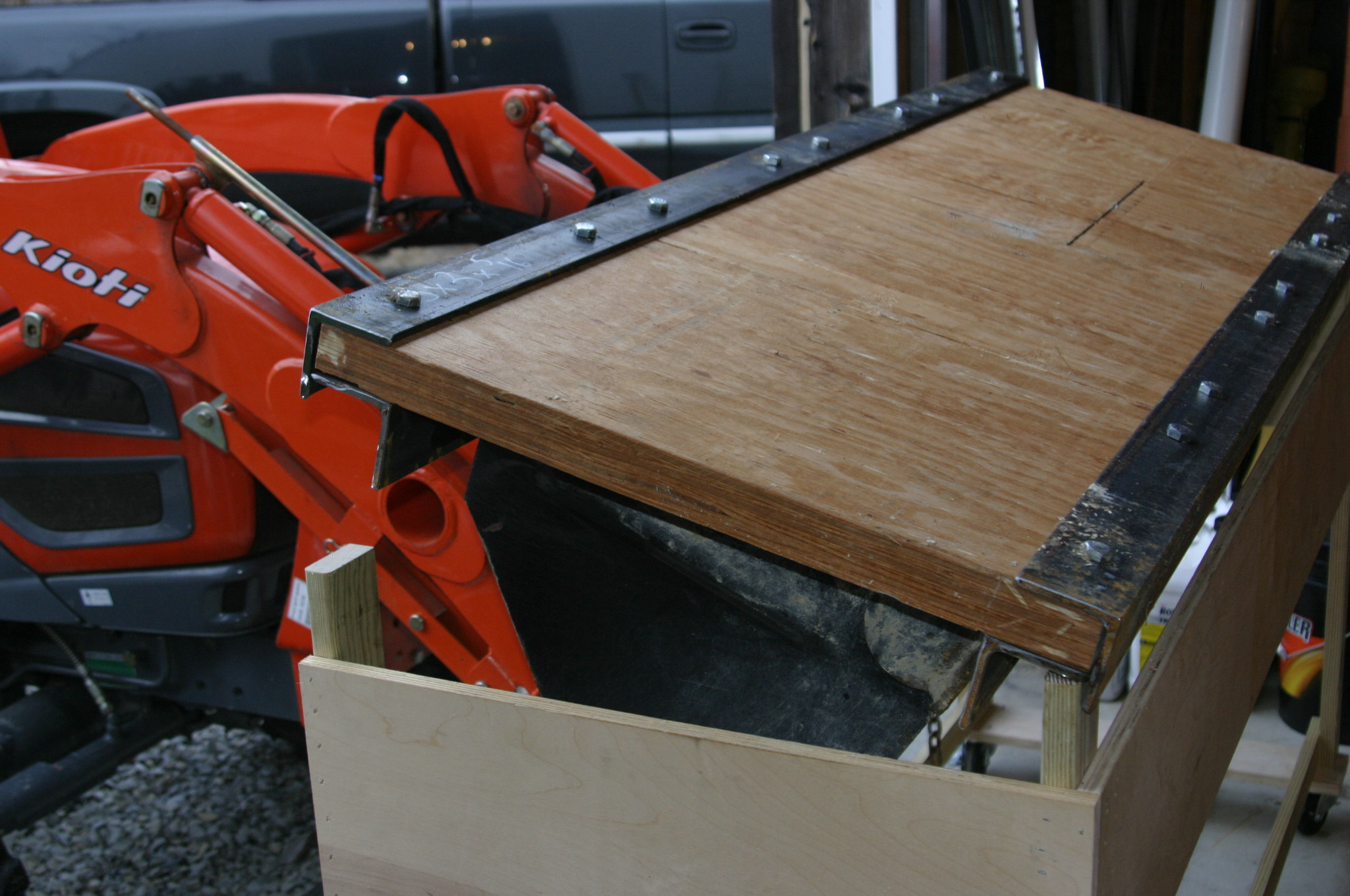

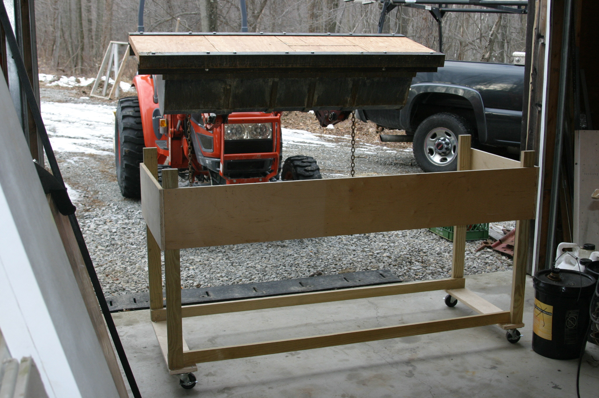

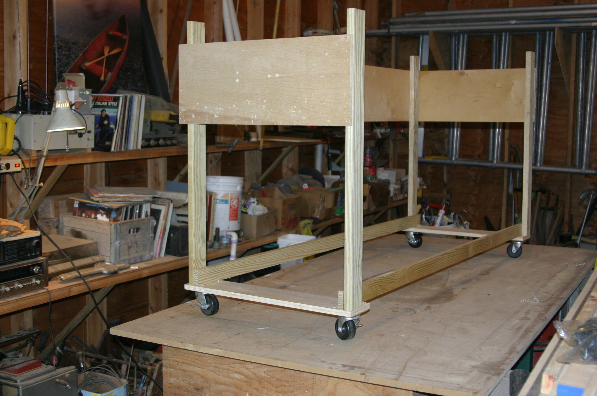

The lvls come with a wax coating, so I'm thinking paint is a no-go. Not painting the steel is just my inherent laziness. Today I'm gonna figure out a good place to drop it, maybe make a stand with wheels, or set it on some horses, I'm out of floor space..
Thanks for the comments!
   / LVL snow push
#25
I'll put a band of plywood with a shelf on it to sturdy this up, now that I marked how high it can be. Would be better welded up, but when you only have a hammer...
