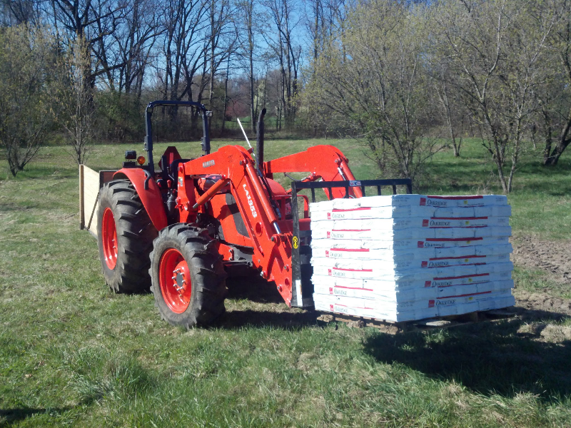

But seriously 1000- 1500 lbs is probably max i can move around in 2wd. Or Maybee a 1/3 of an 84" bucket of clay
Bill I should have elaborated this with nothing on the 3 pt on Nearly flat ground. And that pallet of shingles weighs about 2700 lbs. I only had my empty carry all on the back which only weighs about 500 lbs max
