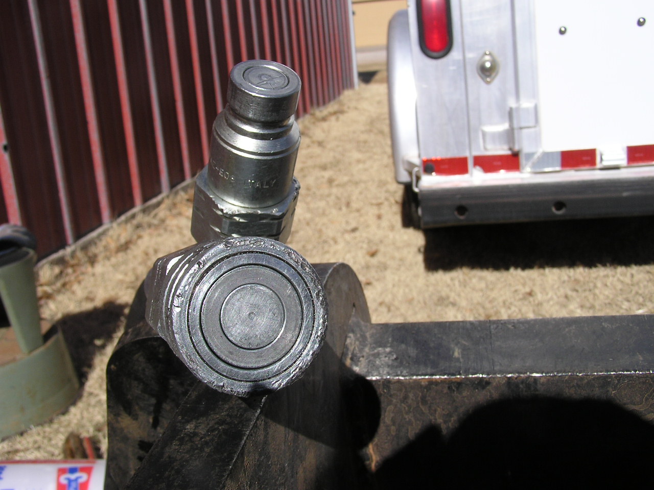

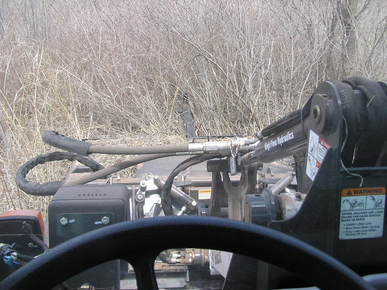

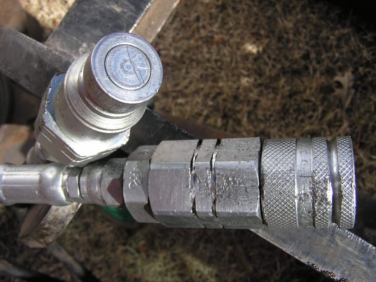

I'm borrowing a friends standard flow (15-25 GPM) mower this weekend to see if flies on the Kubota. Might need to replace the hydraulic couplings though - are those skid steer compat? They are not standard 1/2" ag couplers.
Thanks, Yep, been there, done that with 3 point brush hogs. More gooder out front! :D
My money tree is just barely alive, seems like I keep picking all the green leaves off of it. :(
Most skid steer mowers have cutting edges on both sides of the blades. I use normal rotation for brush and reverse rotation for grass. Check to see if one side is sharper than the other and make it rotate that way, it will cut better with your low flow M59.
Which brings up the question, where are you going to plug in the hoses and does it have continuous flow?
If you already have the hoses, you can get an adapter to go from ag to ss.
These are the standard skid steer flat face couplers that the Toolcat uses.

Those adapters look like what I have on the front of the kubota.
I have the optional extra remote on the front to run skid steer stuff (like that grapple we disussed in a different thread).
In order to make it flow I have to hold the button down on the joystick so not exactly optimal.

Just be careful to double check your valve, some 3rd function valves like that aren't designed to be used for continuous flow. Although I doubt you'll hurt it by just trying it out.
Also, are the hoses full diameter like your other hoses? My 3rd function hoses are quite a bit smaller than others, which reduces the hydraulic flow, so you may or may not have full flow to the mower.
I'm very interested to see how well it works as well. With the heavy duty FEL on the M59 I wouldn't worry much about the additional stresses like I would with a tractor like mine.
